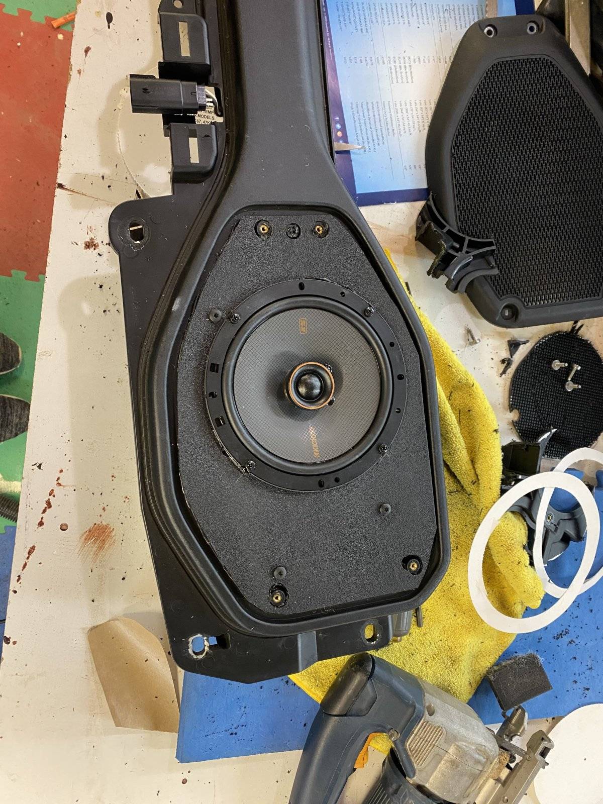

Kicker KSC670 6-1/2 coax in sound bar and knee panel
Kicker KSC350 coax in dash

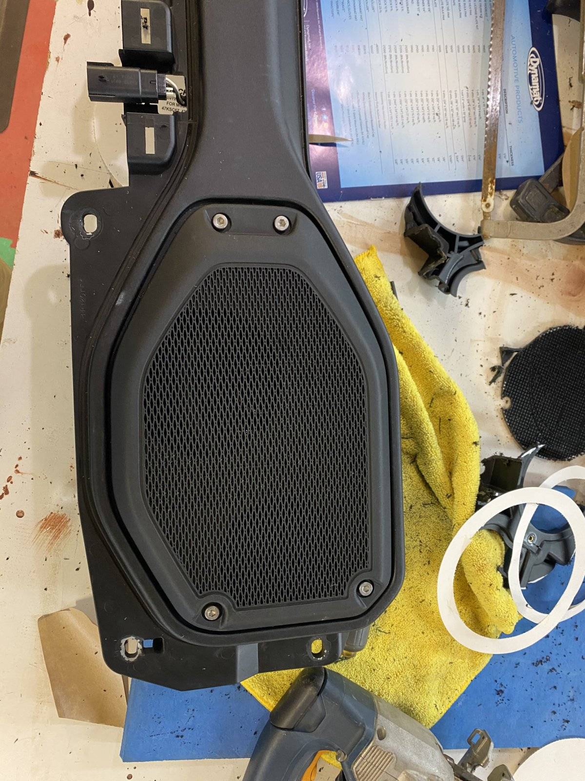

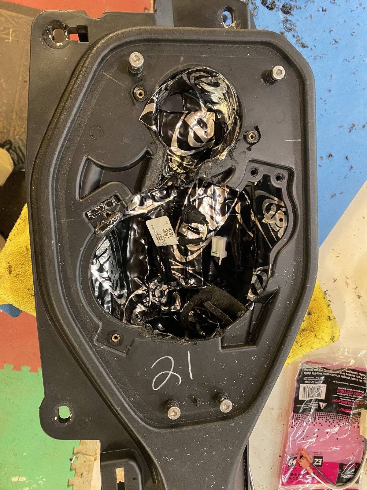

For the sound bar I wanted the factory look so I ordered sheets of ABS plastic (Metra part #89-00-9030) and cut them so that they fit in the sound bar see pic). Then I drilled holes in every part of the grill mesh so that the sound could get through. (This was a pita and the problem is heat. If I did it again I would put the grill in a shallow baking pan filled with cold water and drill it out under the water). I covered the inside of the soundbar with Dynamat and filled it with poly fill. It came out great and sounds awesome.
For the knee panel I got the metra boxes and gave them the same treatment as the sound bar.

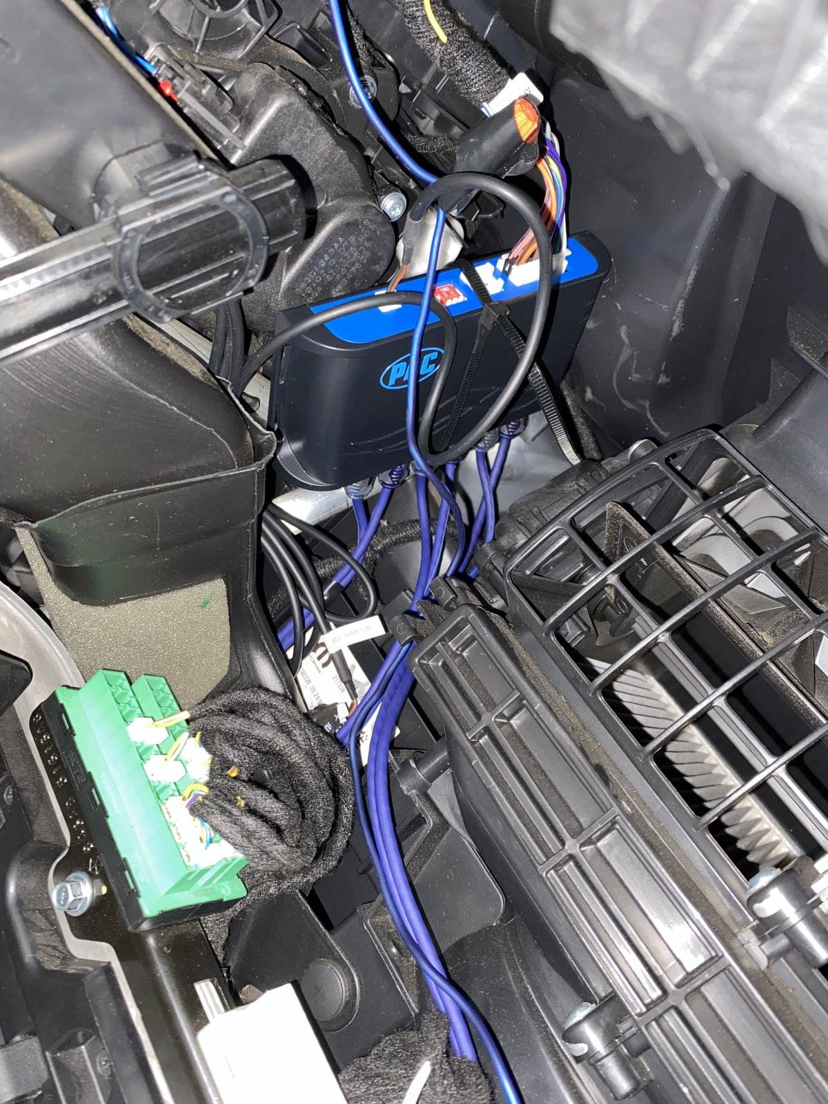

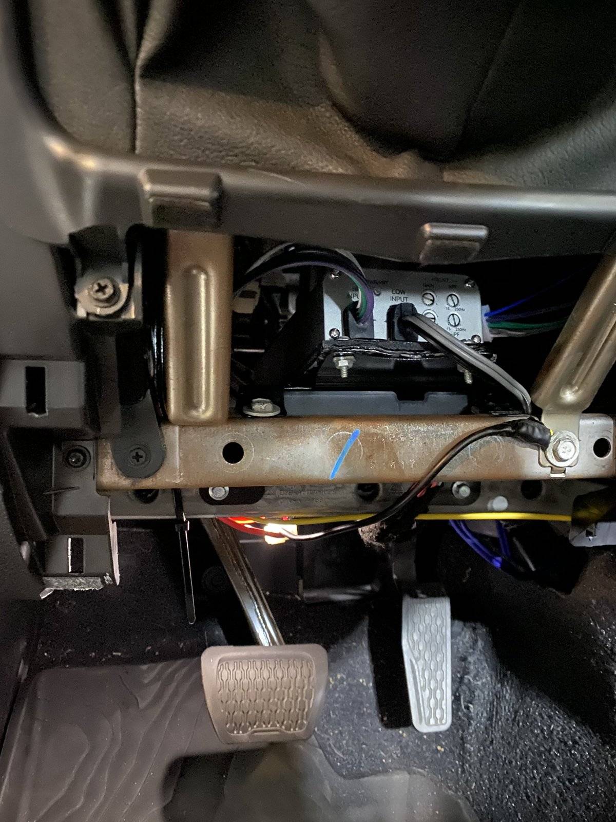

I put the amp under the steering wheel on a leftover piece of the ABS plastic covered in Dynamat. I put the Pac Amp Pro behind the glove box. Power to the amp and sub came through the firewall at the hole for the clutch just below the master cylinder.
