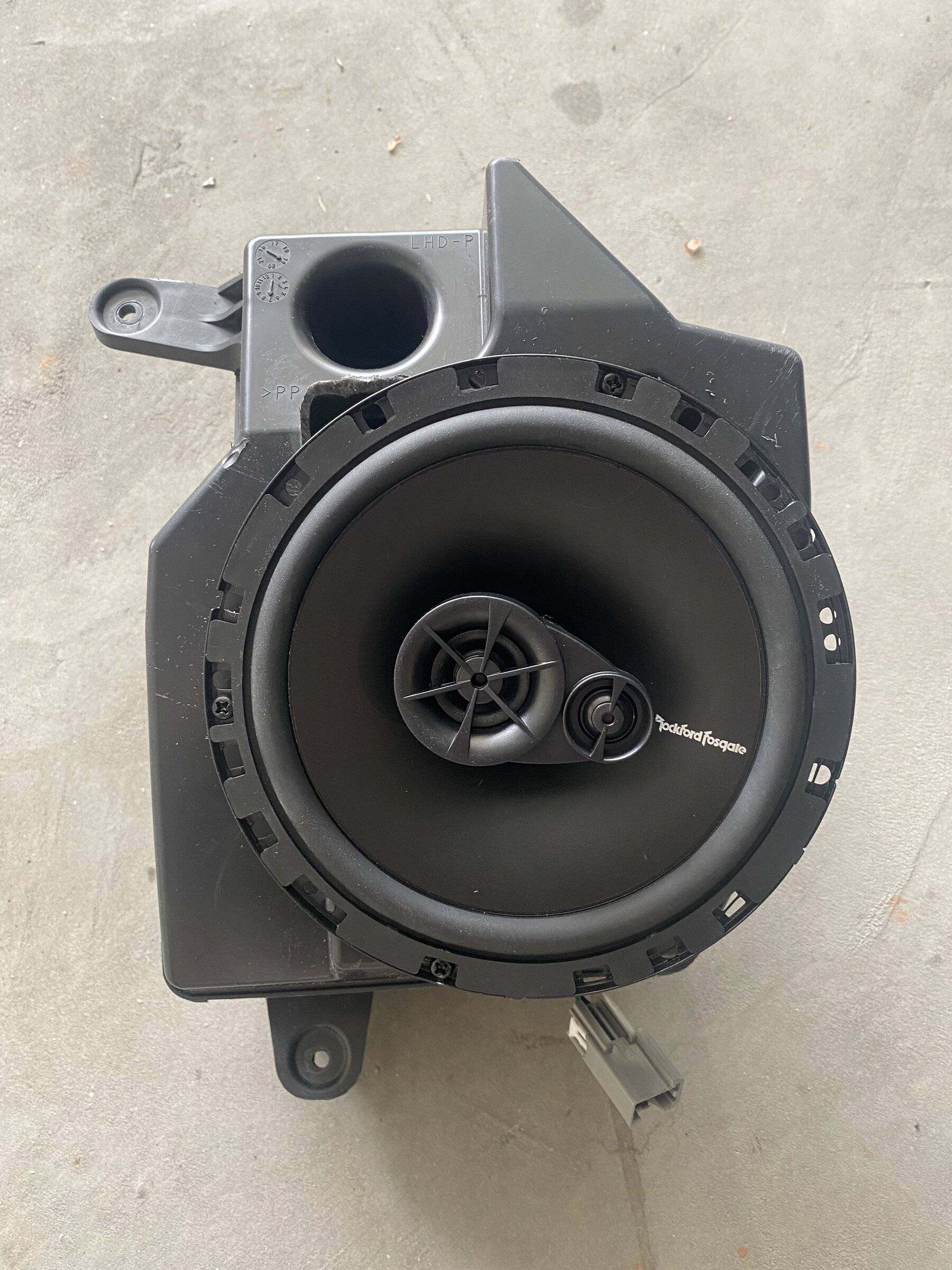

Next step is to swap out the knee speakers....which I'm not terribly looking forward to on account of how difficult/time consuming they are to get to...

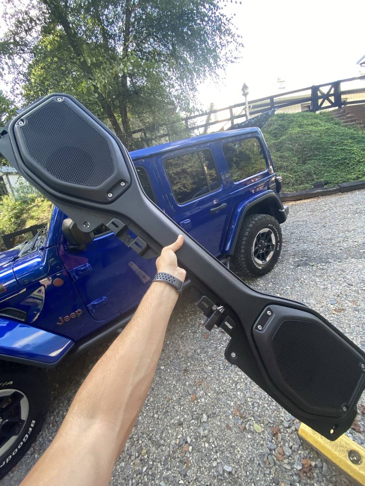

Gentlemen, here we go -

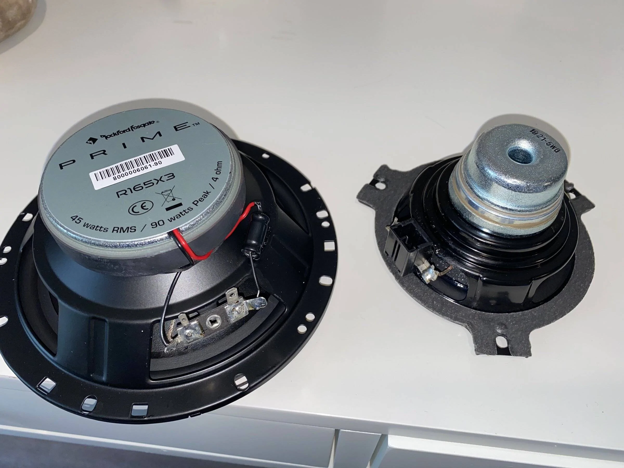

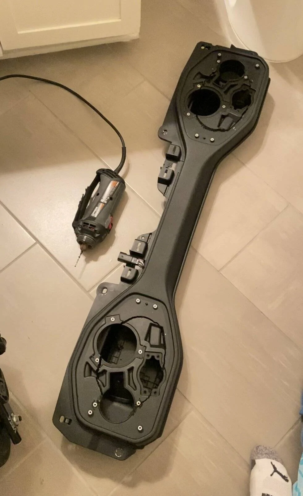

Alpine system soundbar upgrade to 6x9s.
*Taking out the soundbar took 10 minutes, super easy, few bolts and yanking on plastic trim.

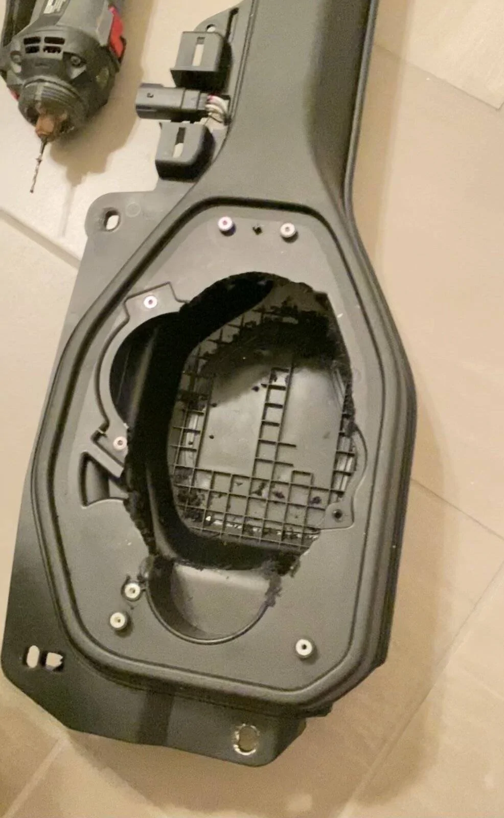

*Removed speakers and hardware, marked drilling area with template provided with 6x9 JBLs. 20 minutes.
*Borrowed my cousin’s rotozip and went at it with a generic drill bit. Skinny silver colored bit, nothing special. Easy to cut through the plastic. That part alone took 30 minutes.

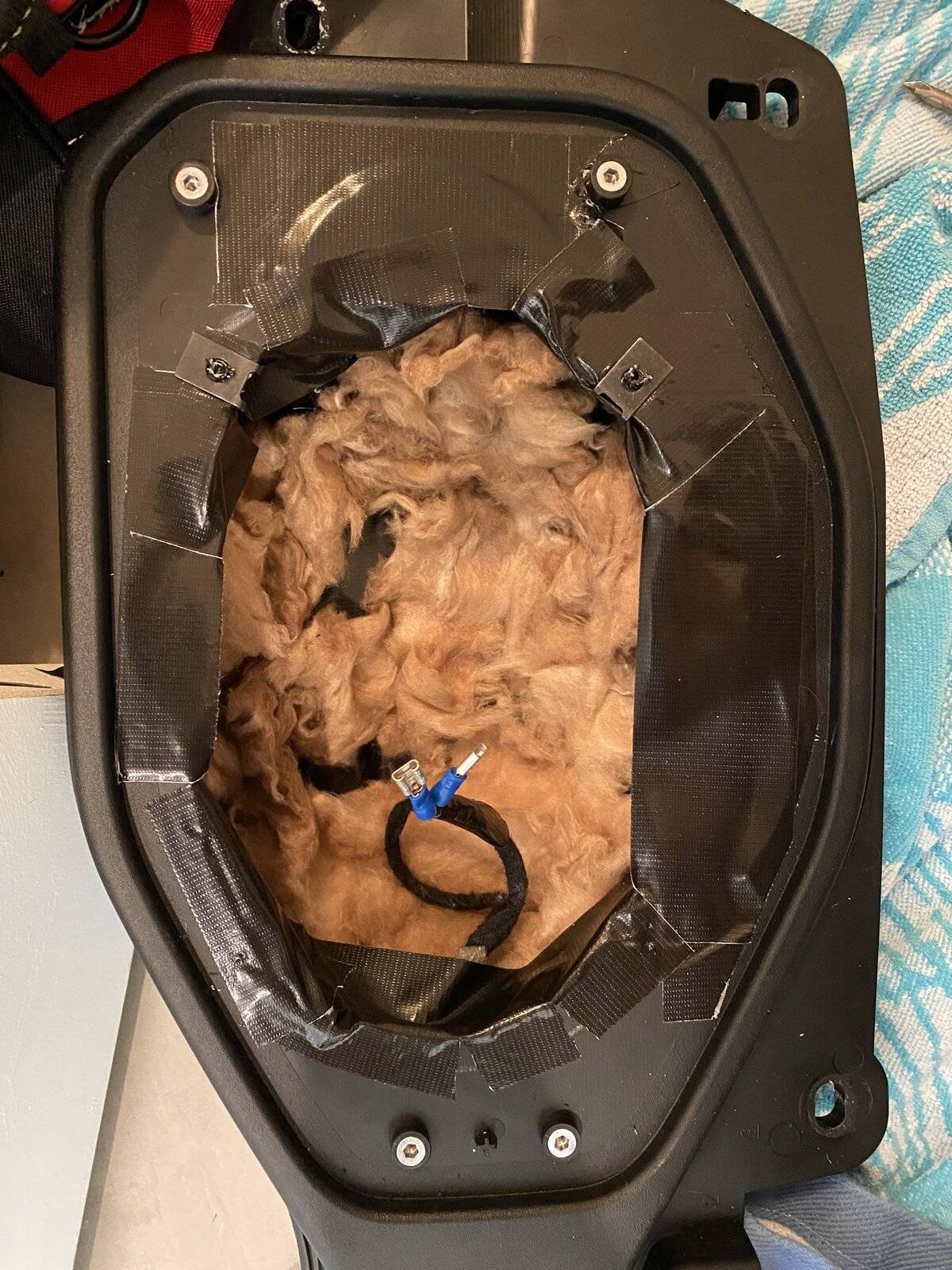

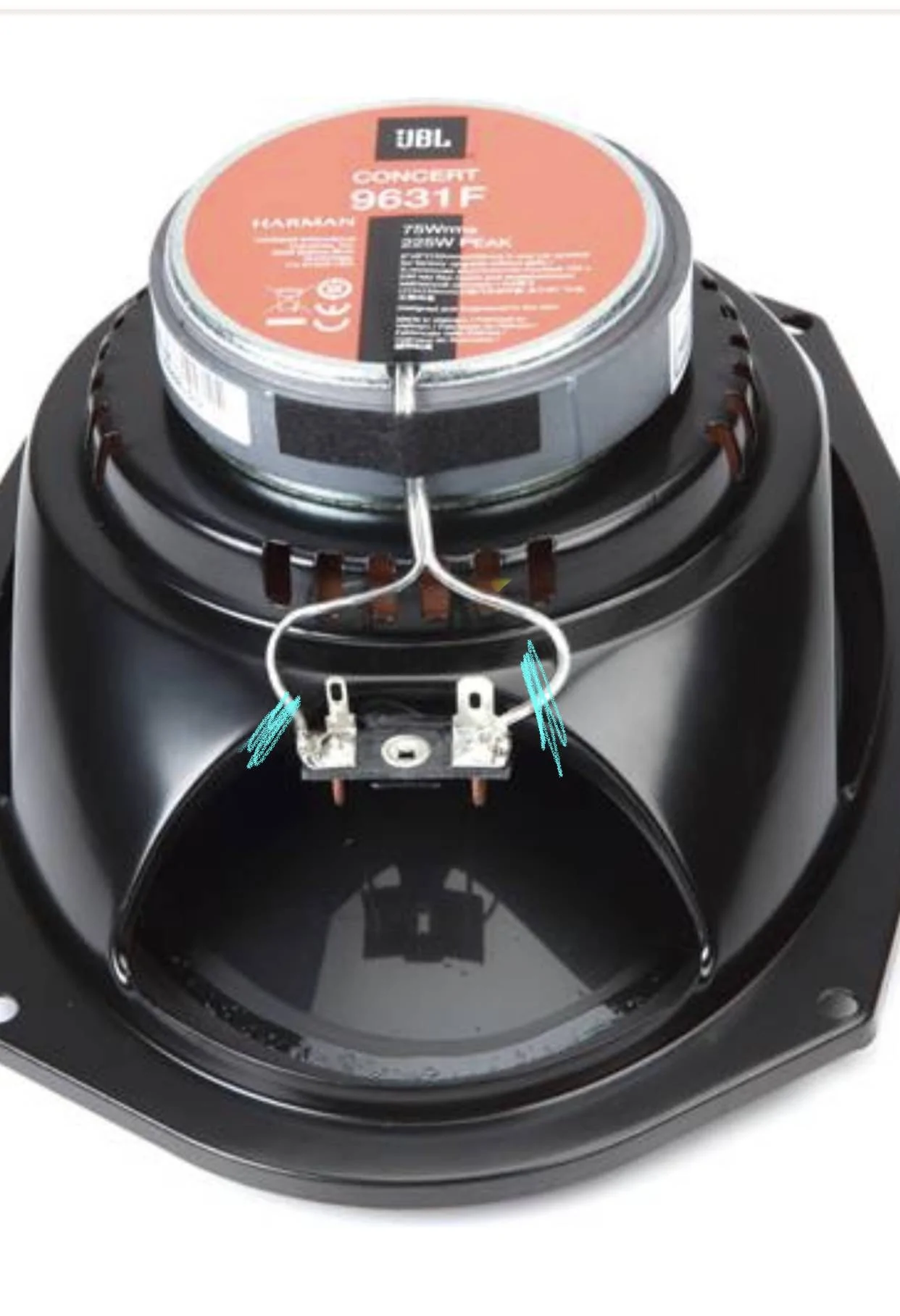

*Cut the connectors off the 3.5” speaker wires, strip the ends so you can hardwire them to the speakers (I used connectors, but a circuit is a circuit, do it how you like). Black wire is negative, white wire is positive, small connector on speaker is negative, big connector is positive. 15 min.
*USE THE SMALLER SPEAKER LINES, THAT WILL GIVE YOU A FULL SIGNAL TO THE NEW 6x9s. (System automatically recognizes no speakers on the other wires and the factory amp knows not to split the mid and high signals. Will not work if you use the larger 4” speaker lines, see the trouble @bem1 (and I) had in prior posts).
*I didn’t want to spend $60 for 6x9 speaker mounting plates, so I got creative and made a nice air tight seal with Gorilla tape and window stripping. I know, totally gangster, but I’d rather not explain spending more money on this to the wife. Also - there is plenty of plastic for the mounting screws so the speakers are solid and secure. Also laid in some fiberglass insulation. Most people use poly fill, (I did some research and insulation works as well or better). That took 30 min.

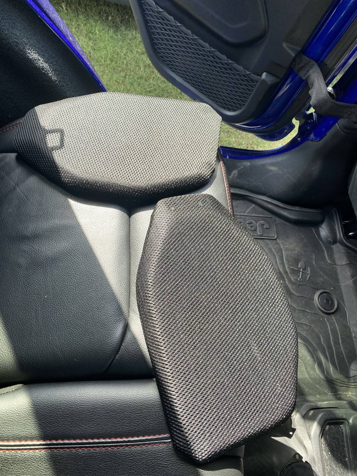

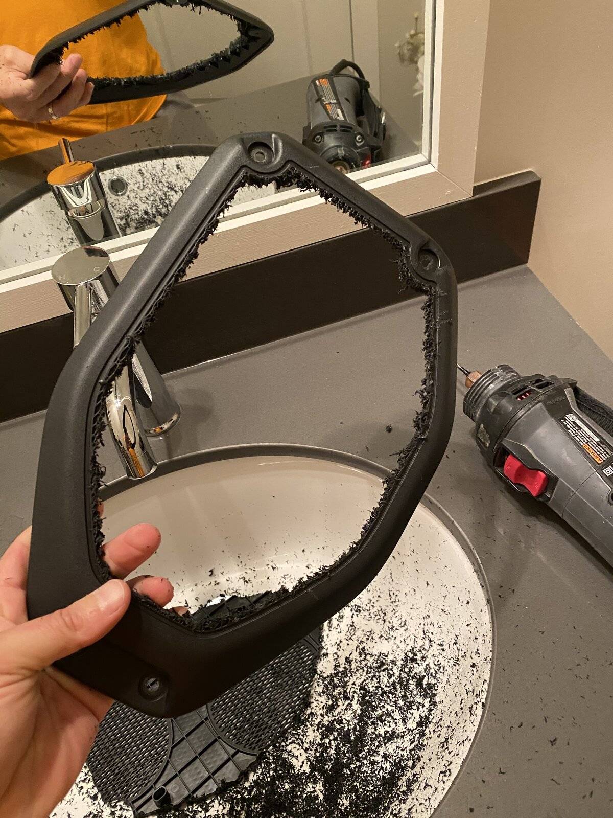

*Speaker covers - used the rotozip to drill out the plastic mesh insides leaving the frame. Covered the frames with speaker mesh (like $10 from Amazon) and secured it to the frames with hot glue. Used two layers of mesh. Then hot glued the covers to the soundbar at the four screw holes. 40 minutes. Took time to cut mesh to the right size. My 9yr old helped 👍🏽👍🏽
*Reinstalled soundbar, 10 min - turned on the Jeep and Shazam! I closed my eyes and jammed to Vanilla Ice like it was 1990.
*Sound is SOOO much better!!!! Full complete sound with the top and windows down cruising. Crispy treble, you can hear the little crackles of songs recorded on vinyl. Plenty of volume, I only take it up to 20 (half way) and that’s as loud as I can handle. People talk about the sound stage being at the front dash speakers, now the stage is all around you, voice and sound surround you.

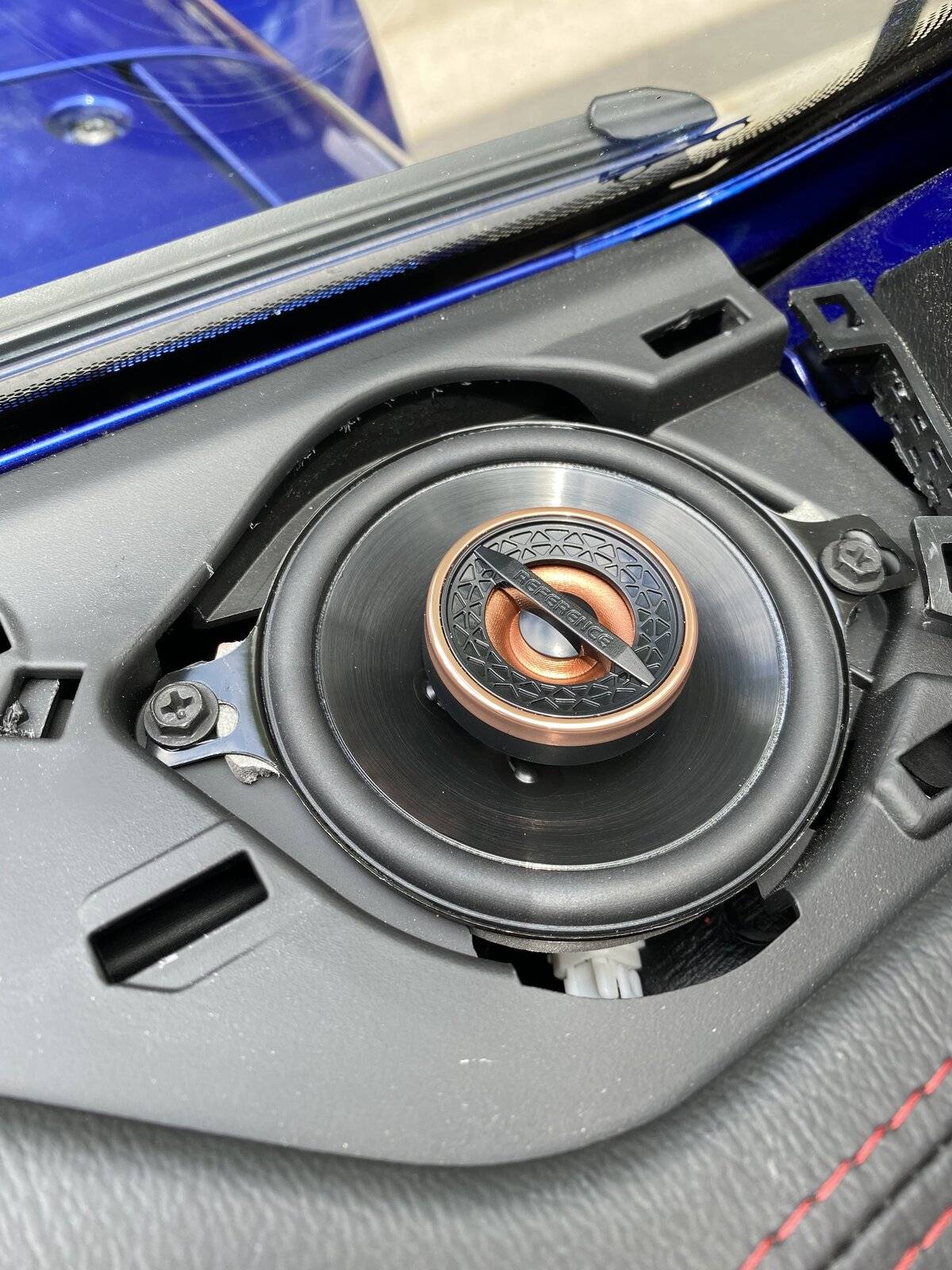

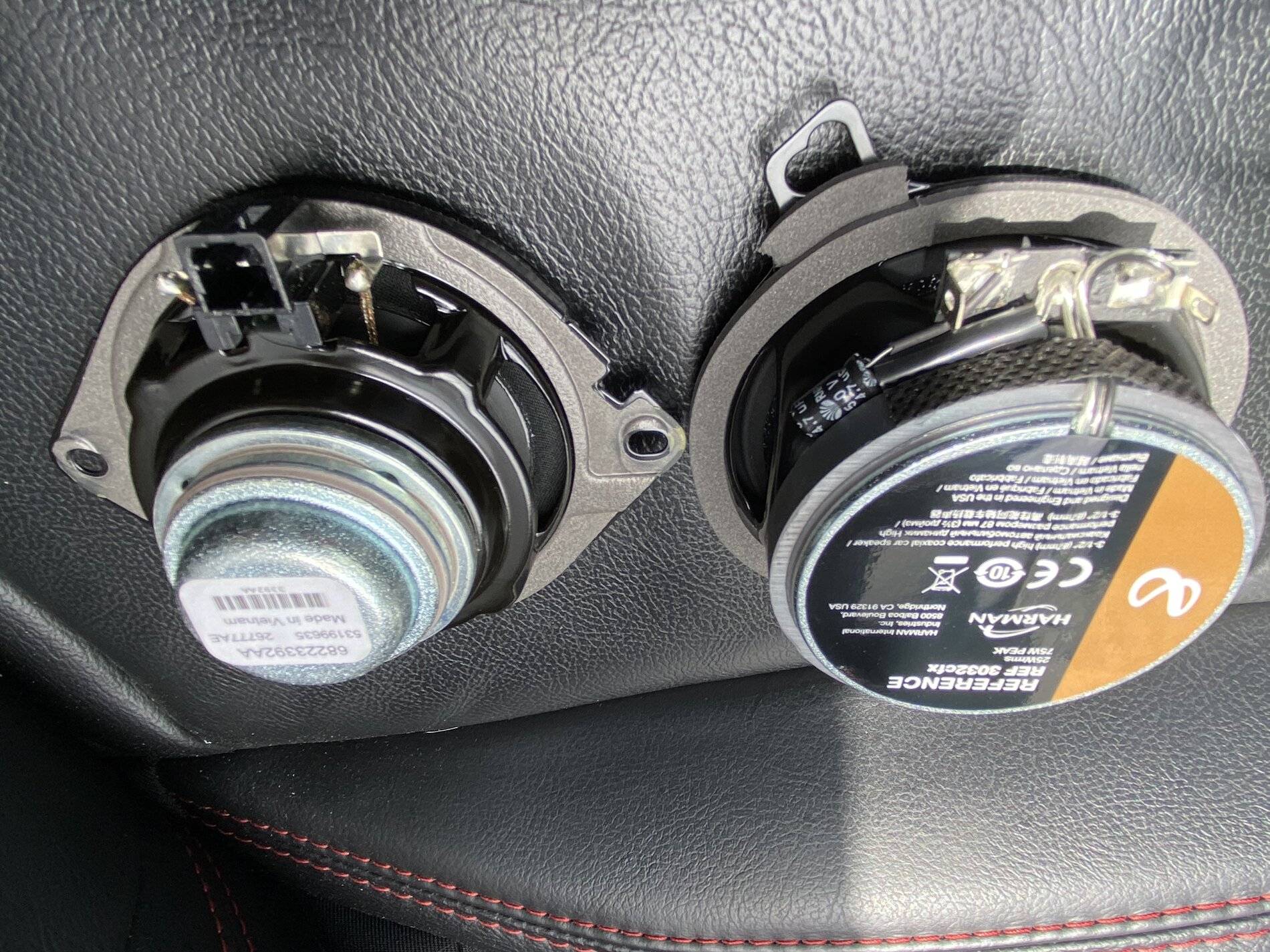

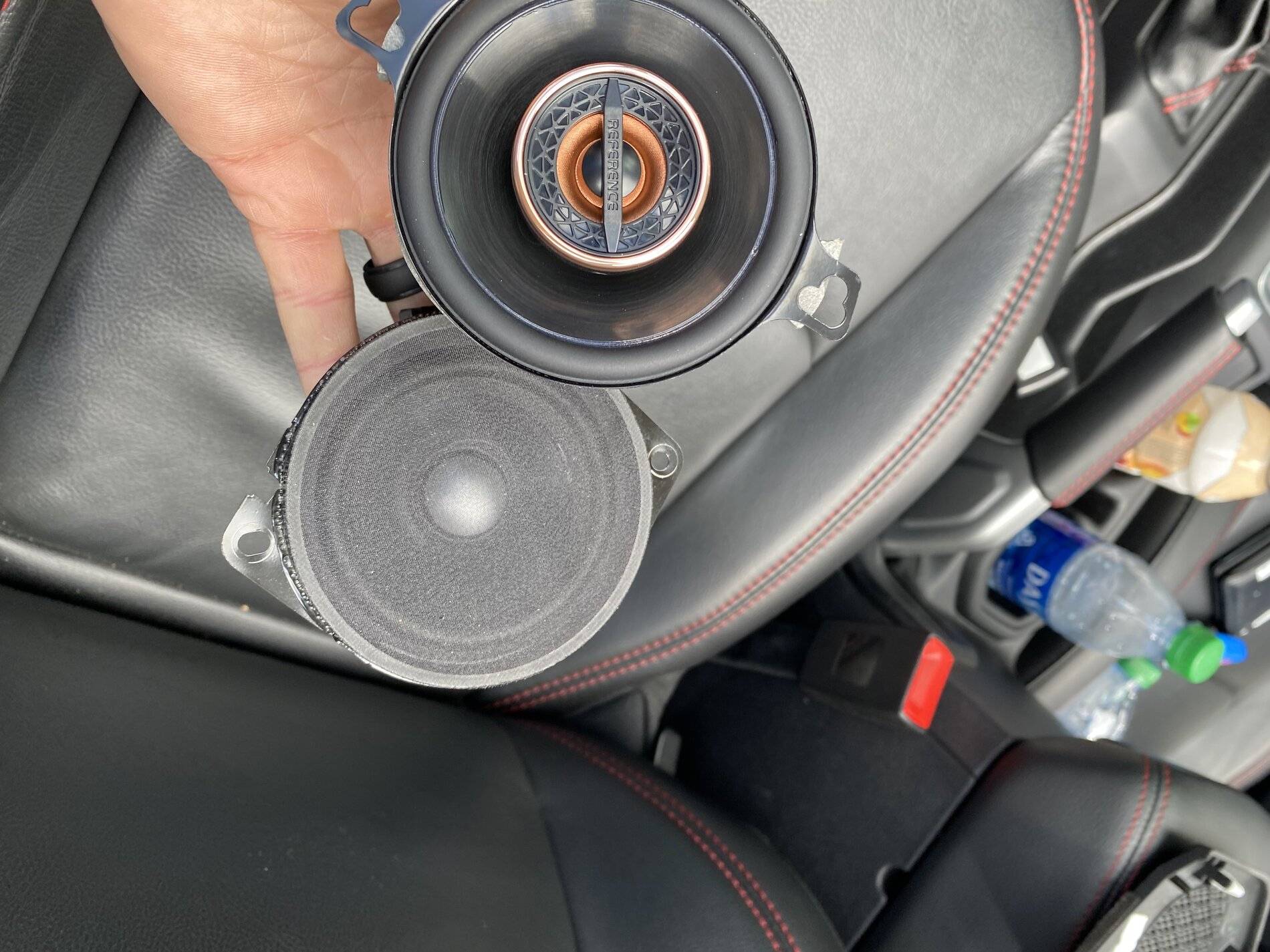

*My system also has the infinity 3.5” speakers in the top of the dash - $60 from Crutchfield and a 5 minute install, all you need is a screwdriver and the connectors that Crutchfield sends with them. Best lone upgrade you can do to ourJeeps. Voices went from muffled to clear.

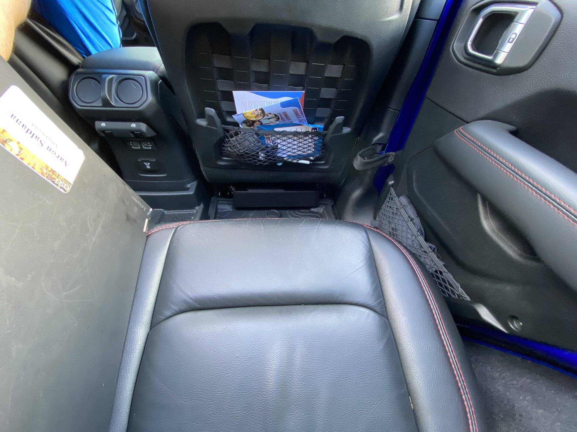

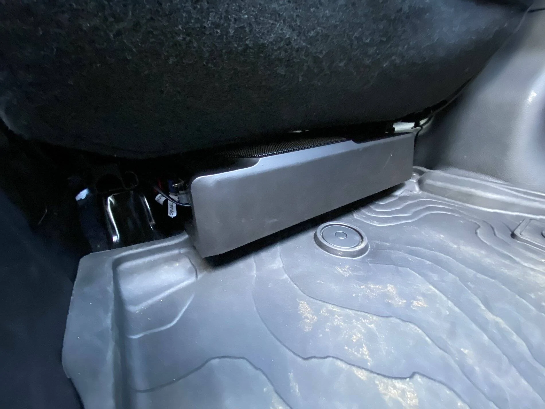

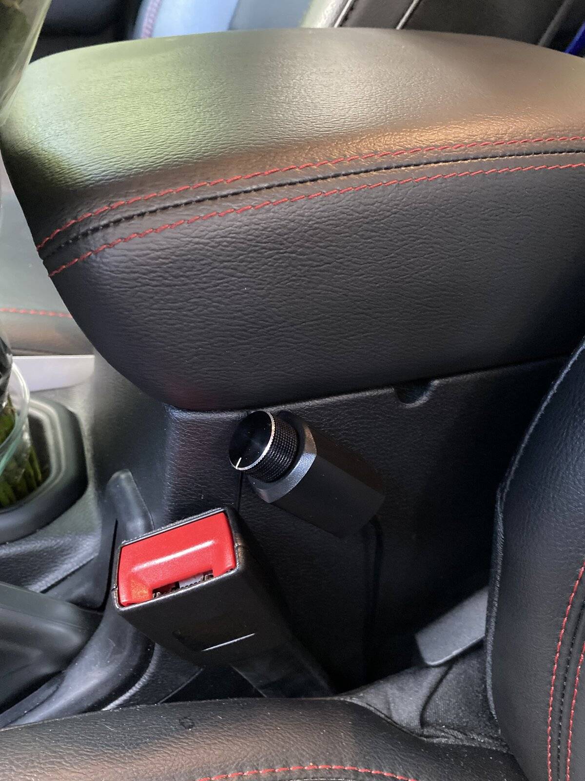

*To solve the bass problem (sad bass performance from factory 8” sub with top back windows down) I got the Crutchfield Sound Ordinance 8” 125 watt self powered sub, $160. Put it under the passenger seat, thumps are very clear. Initially tried it in the back, but it didn’t sound great back there. It has a little knob for you to adjust the bass up or down for anytime for any song. Screwed in the knob to the glove box. Overall, I’m 100% happy with this setup.
