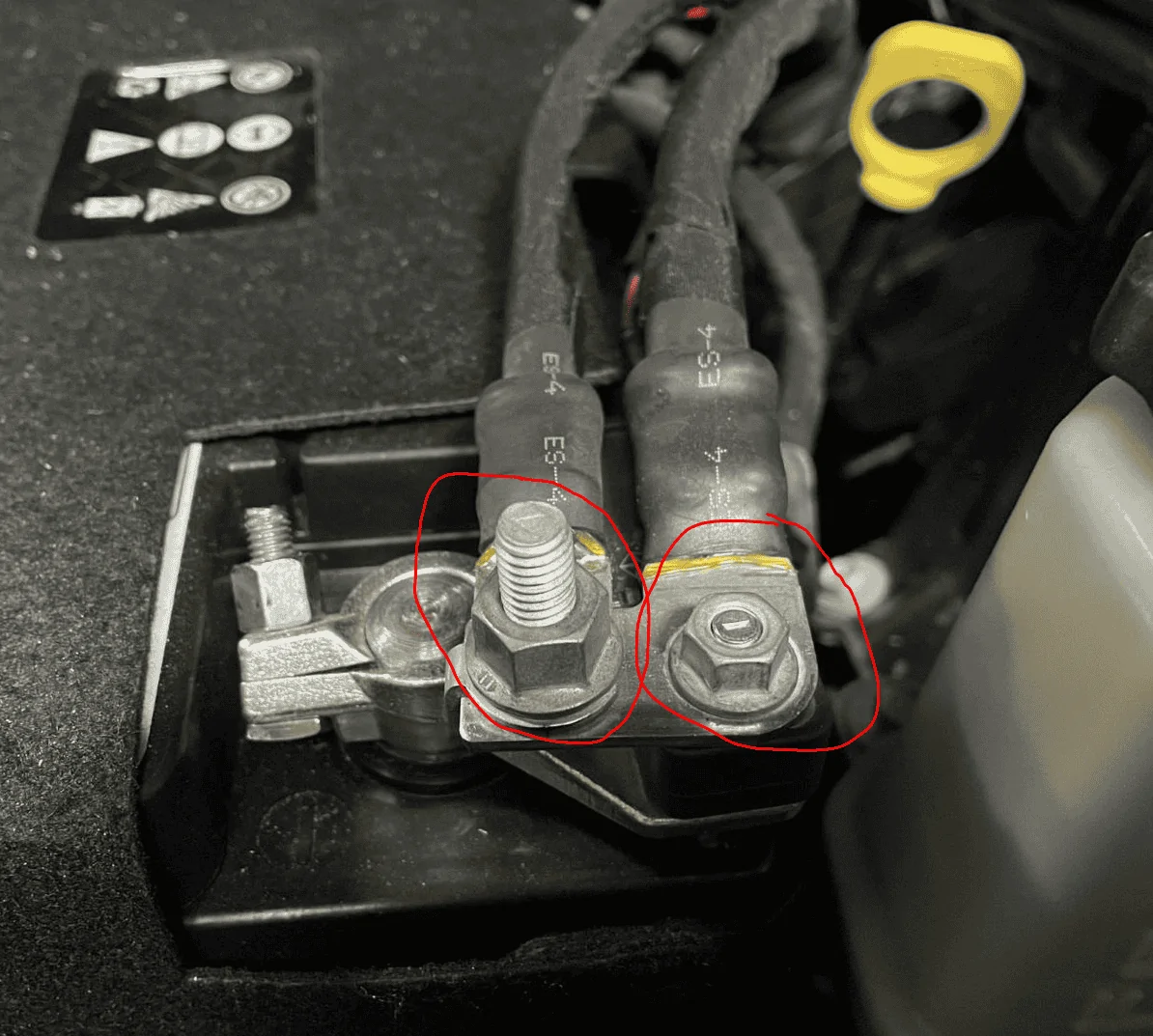

i had the battery disconnected on the negative side, and the two negatives separated.
probably 20 minutes.
maybe that is what triggered the redetection

jludave
Dave
Feb 13, 2020
4,158
4,287
The Isle of Long
IT Manager
So which ones did you disconnect? These?
Yes. Disconnect the main bolt to the left of those first. Then disconnect and separate those 2. Make sure they do not touch once disconnected.
