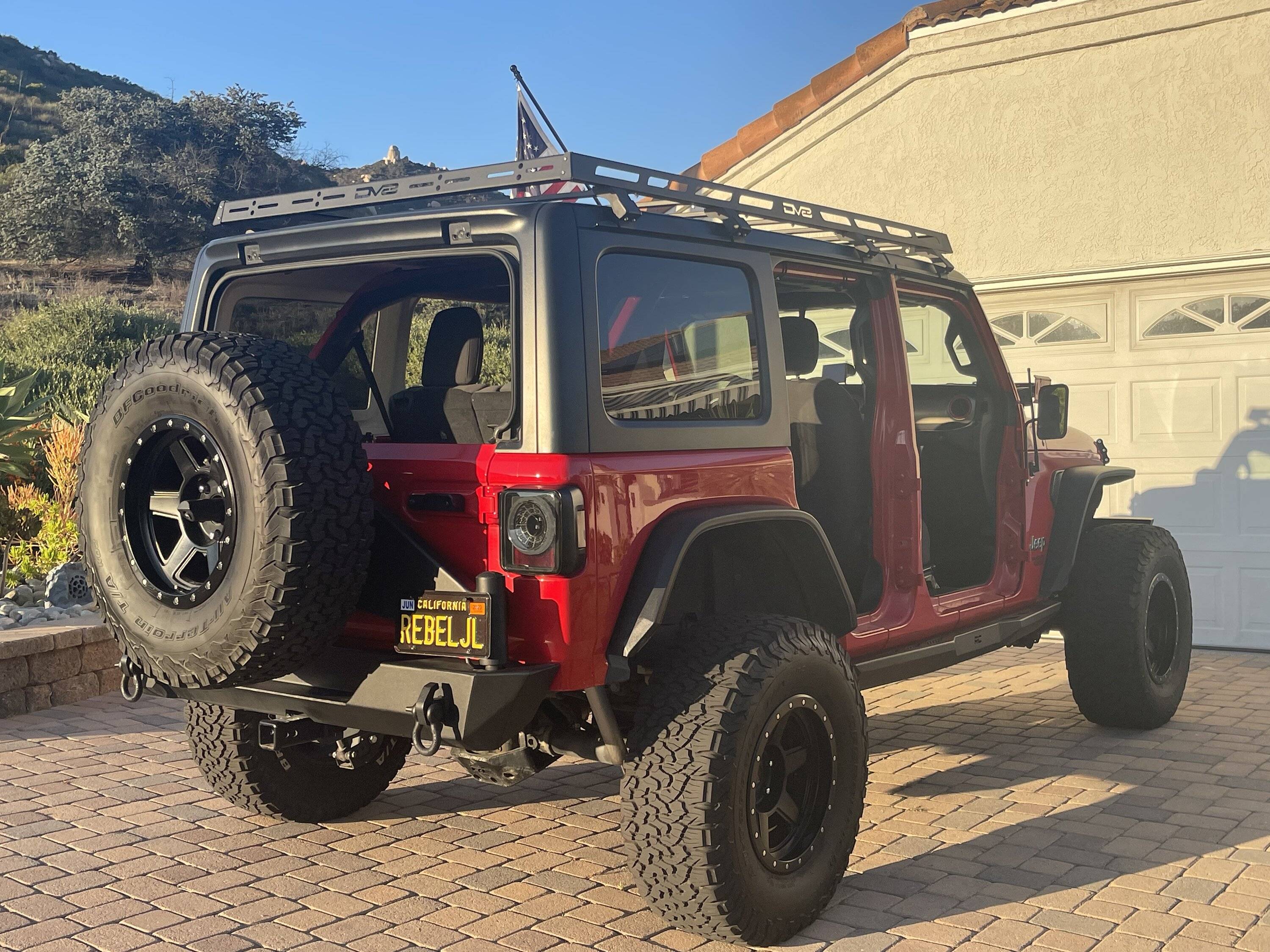

So I don’t love topless.
I don’t want a seat belt tan line and I love my roof rack. So, during the summer I typically put trail doors on (haven’t yet) but THIS year, I removed my rear window.
I freaking love it!
Yes, I am aware of the carbon emissions warning and will only have this with trail or no doors. So, no problems there.
I am mad I haven’t done this before. Highly recommend!
Jeep Wrangler JL Removed rear window IMG_4773

I've been wanting to remove the rear window and make a canvas roll up cover maybe using velcro.
Would you explain the process for the electrics and water? Thanks in advance.
So, the most important thing is you will need two people for the removal.
Remove the two covers up at the top.
We disconnected the hose, unsnapped the defroster and unplugged the wiring harness. (The hose will still be active, you could cork it, if you want but we didn’t.) Tuck the wires and hoses inside the compartments and then replace covers.
With the window up have some one support it while you unscrew the struts where they attach to the hard top. Then, remove the bolts for the hinges one bolt from each side and loosen the remaining bolt from each side so that they are almost all the way out but still supporting the hinge. Carefully and quickly remove the bolts one at a time while the window is supported by your friend. I have heard too many horror stories about the window shattering, so we were really careful to keep it level and supported while we were removing the bolts.
That’s it.
