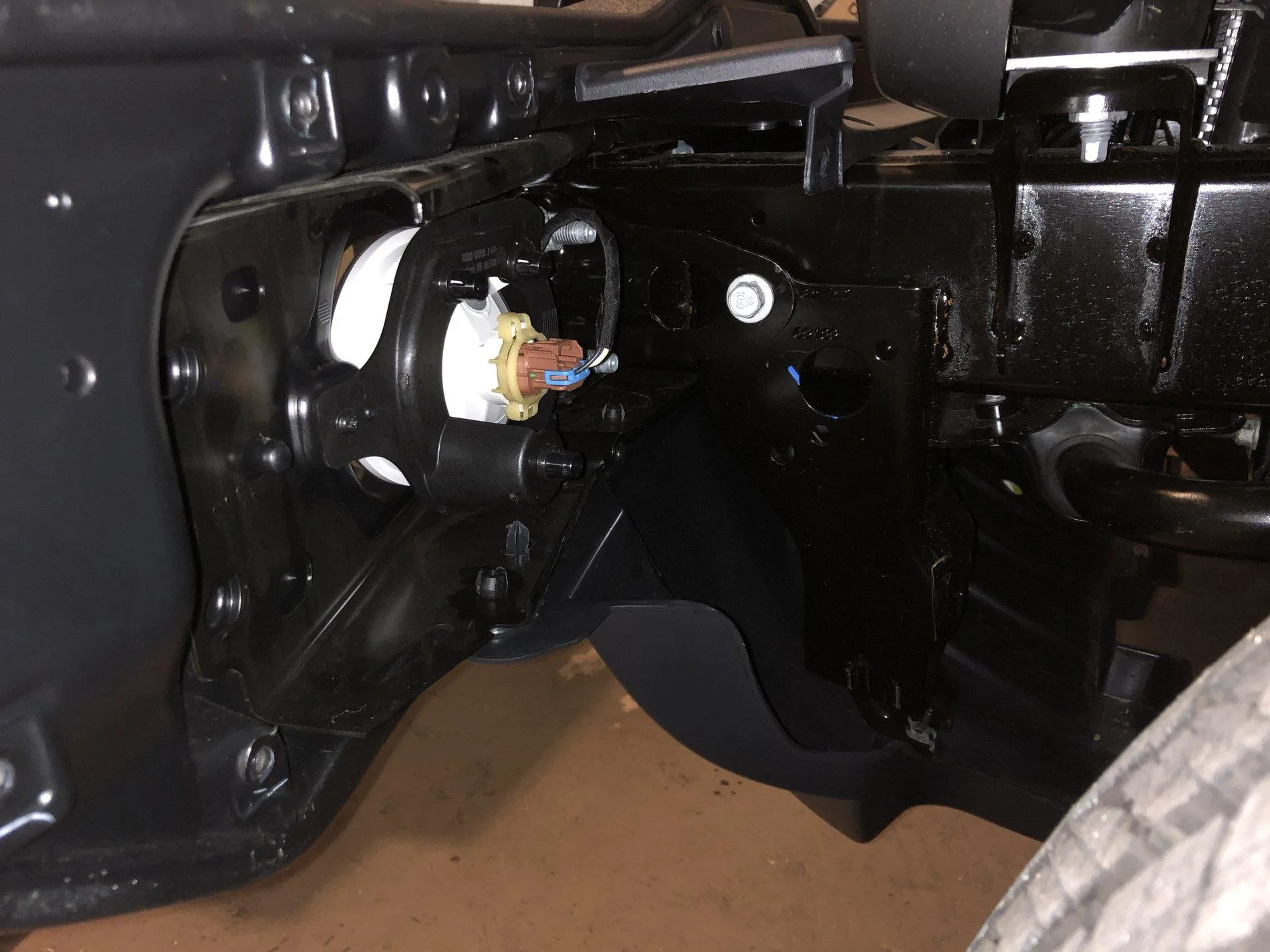

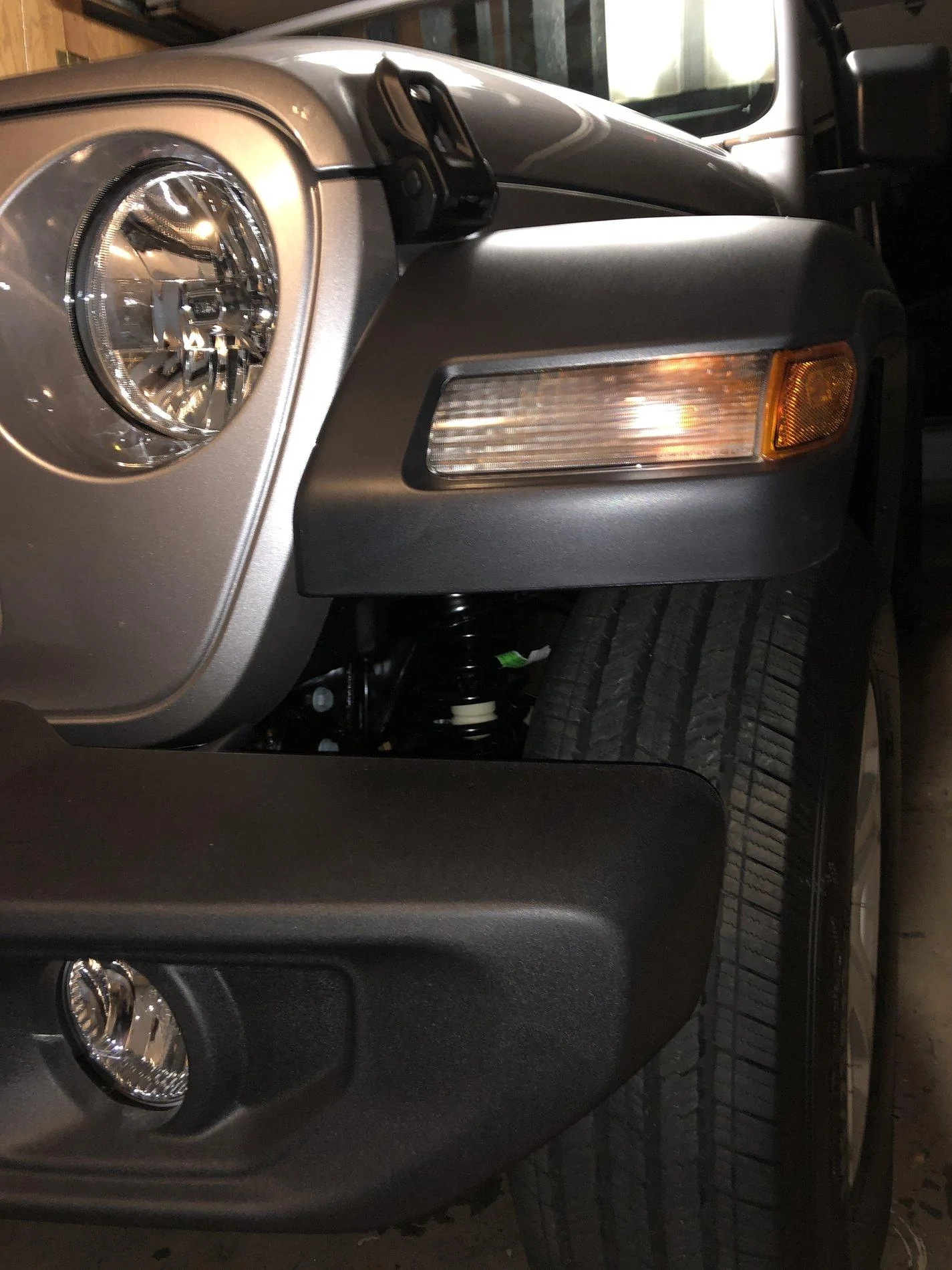

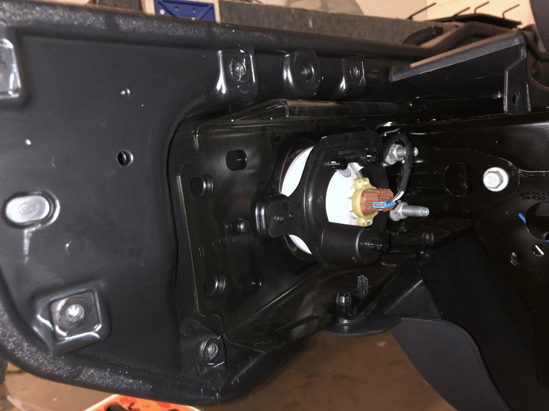

It was recommended I posted this in the show and tell section. I have not seen much information on this topic but am very satisfied!
During launch I read about the sport bumper/fender connection pieces and how FCA confirmed they were removable. I received my JL yesterday and I would be lying if I told you I didn't lose sleep over the thought of those ugly things. Today I was able to remove them, what do you all think? Do you think these connections should not be exposed to the elements? The bumpers were tightly connected threw 6 screws on each side but I would assume water would make it in especially at the recommended water height of 30" from the tailgate plate. What are you thoughts?

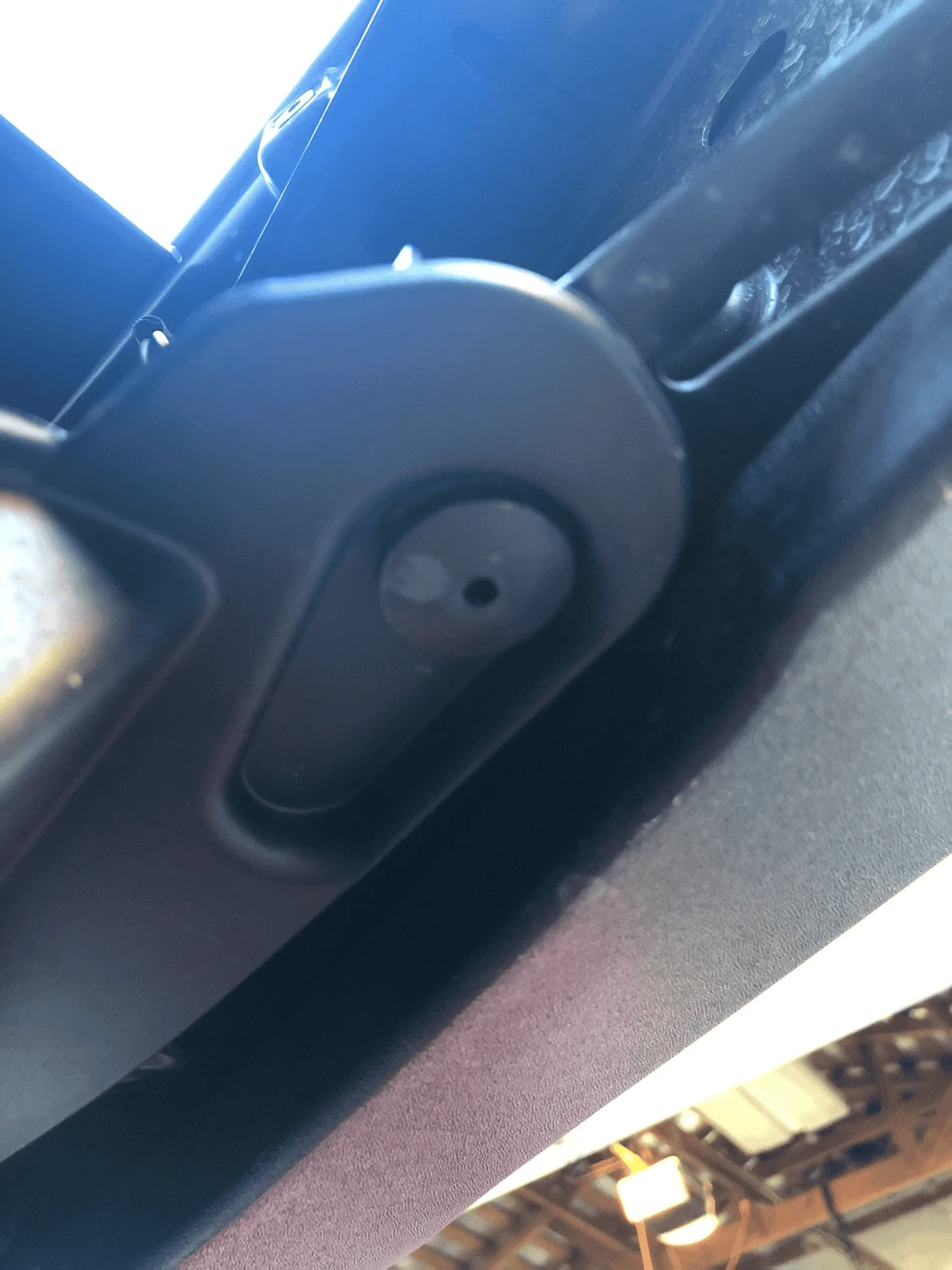

Everythig was pretty easy! Don’t be afraid to use some muscle it’s just plastic. Don’t forget in addition to the 6 screws per side the plastic pins! Goodluck let me know if you have any problems!

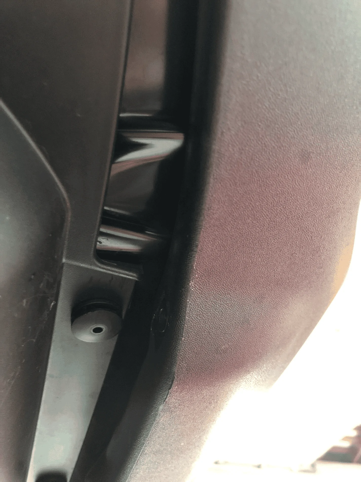

Sorry! I forgot to update this page this is the message I’ve sent to a few PM also there is 7 screws! Whoops it’s been awhile!
Hello! Of course so you’re correct there should be 7 screws per side. After i had to remove two of those plastic pins per side (see photo below) and then I yanked and did have to use some force to get it out let me know if that helps! Or send me a photo of your progress

These were the second things I took off (first were the stock side steps). One note: In order to access the bottom-most screw, I found it easier to remove the plastic skid plate.
It was really simple, there are 6 or 7 pop out plastic clips and two screws on the skid plate. Afterward, both the screws and the clips go back into place.
So far so good as far as the lights go. On my JK my fog light connections were exposed (I even had anti-flicker harnesses installed) and never had an issue with rain or water fording affecting the lights.
