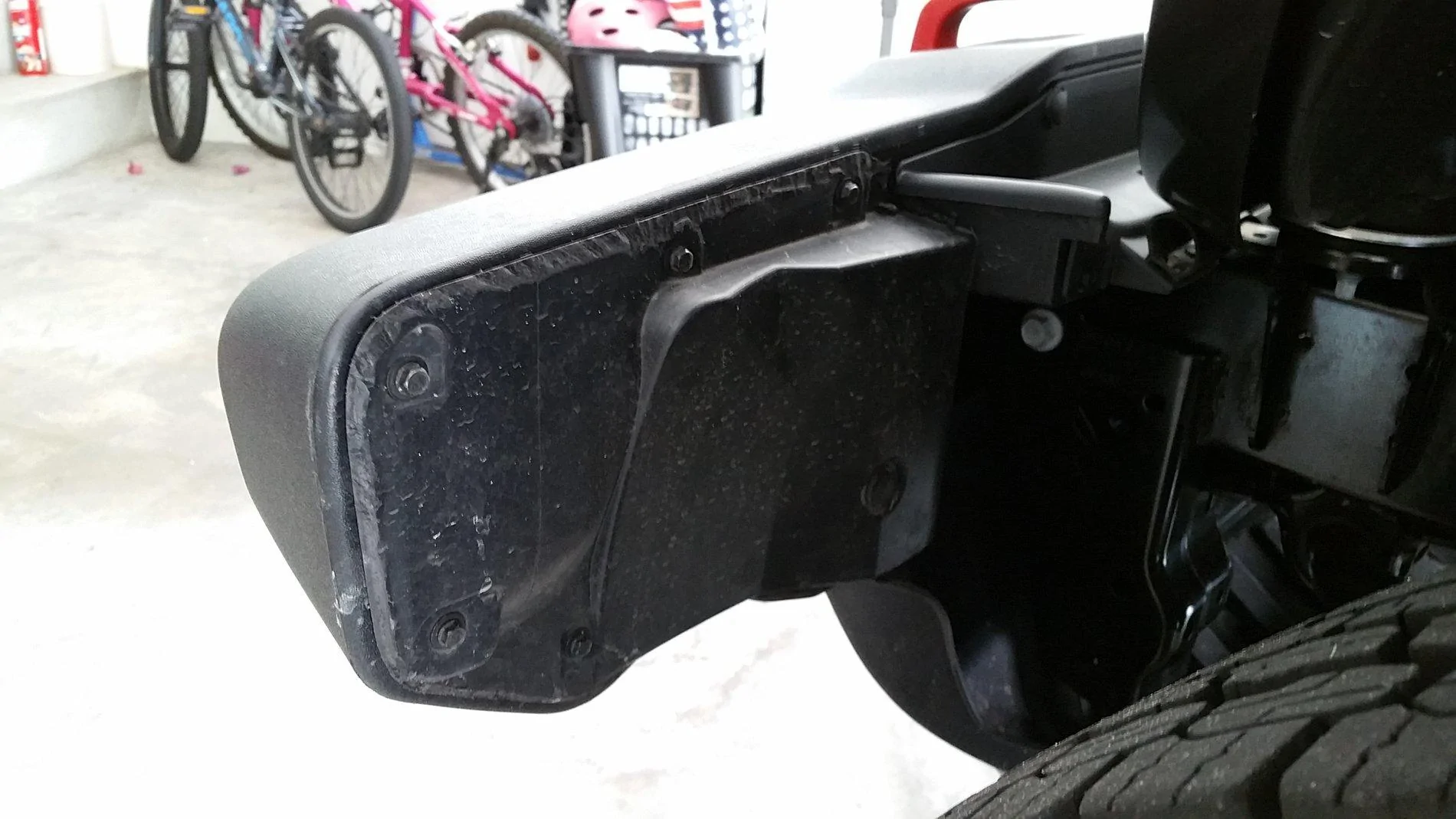

I removed mine this weekend. I live in Florida and definitely was concerned with elements getting to the lights, rain every other day thru summer and it looks like housing wires around the bulbs is not waterproof. I took a dremel tool with a general cutting bit and tightly cut around the line that meets with the back of the bumper. Was a little tricky and took my time, had to sand the edges a little in the end, but looks good now and still covers the fog light backs.

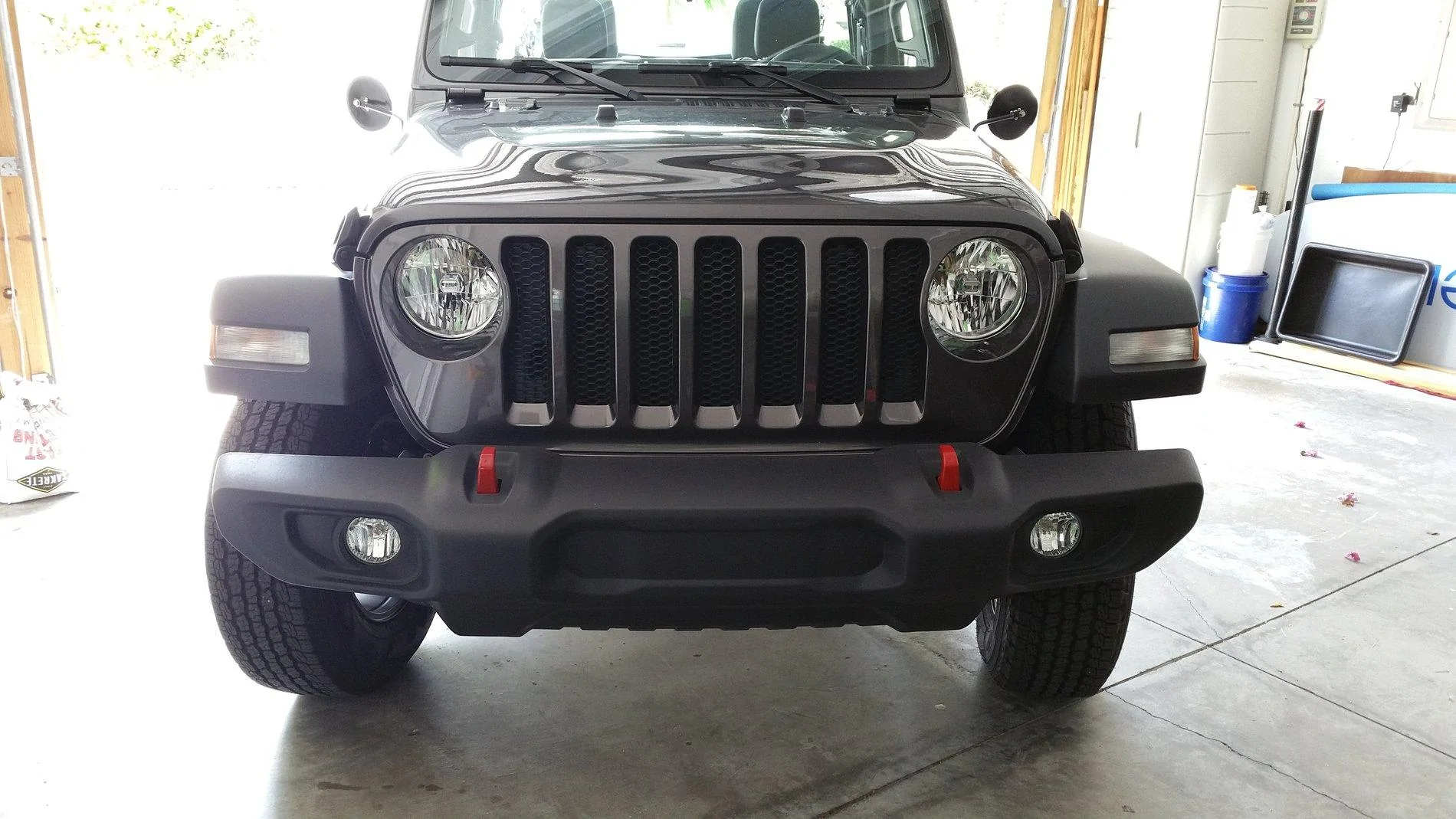

These are the original pieces, just cut . I decided to cut them to keep the fog light wires covered up. These photos just show my finished look.
