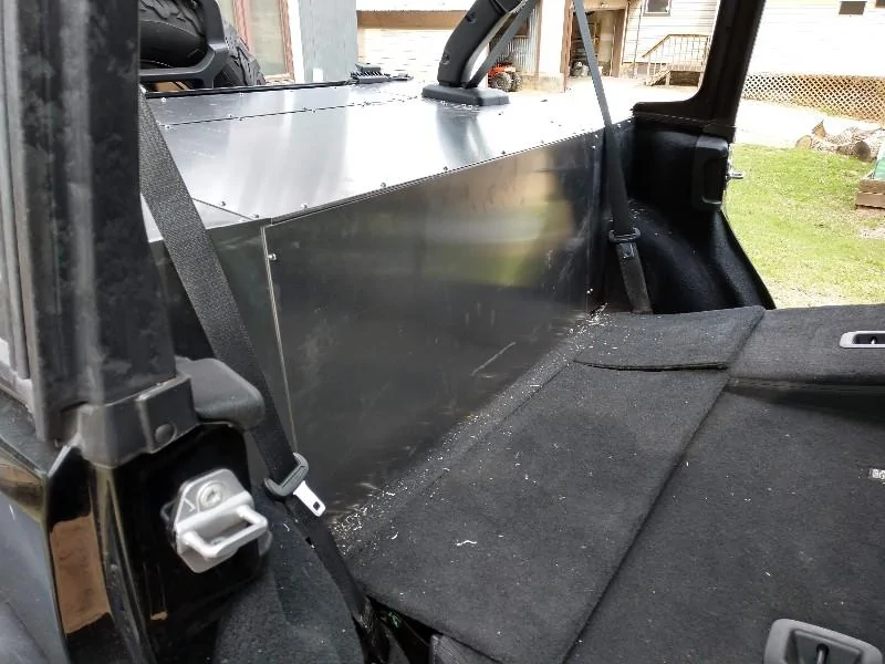

I made my own from 16 gauge aluminum with a 3/4"x3/4" 16 gauge square steel subframe. All fasteners are drilled and tapped for #10x24 machine screws. Body fasteners are 8mm1.25x50mm. The top double folds similar to the slipstream and is removable. I am adding some lockable compartments in the front over the wheel wells with the extra material for small stuff like field glasses, camera etc. I have a bit more detail and then paint but it works well. The hardest part was making all the piece patterns.
@CallMeJoe, do you know how much weight can the top of the box support?
