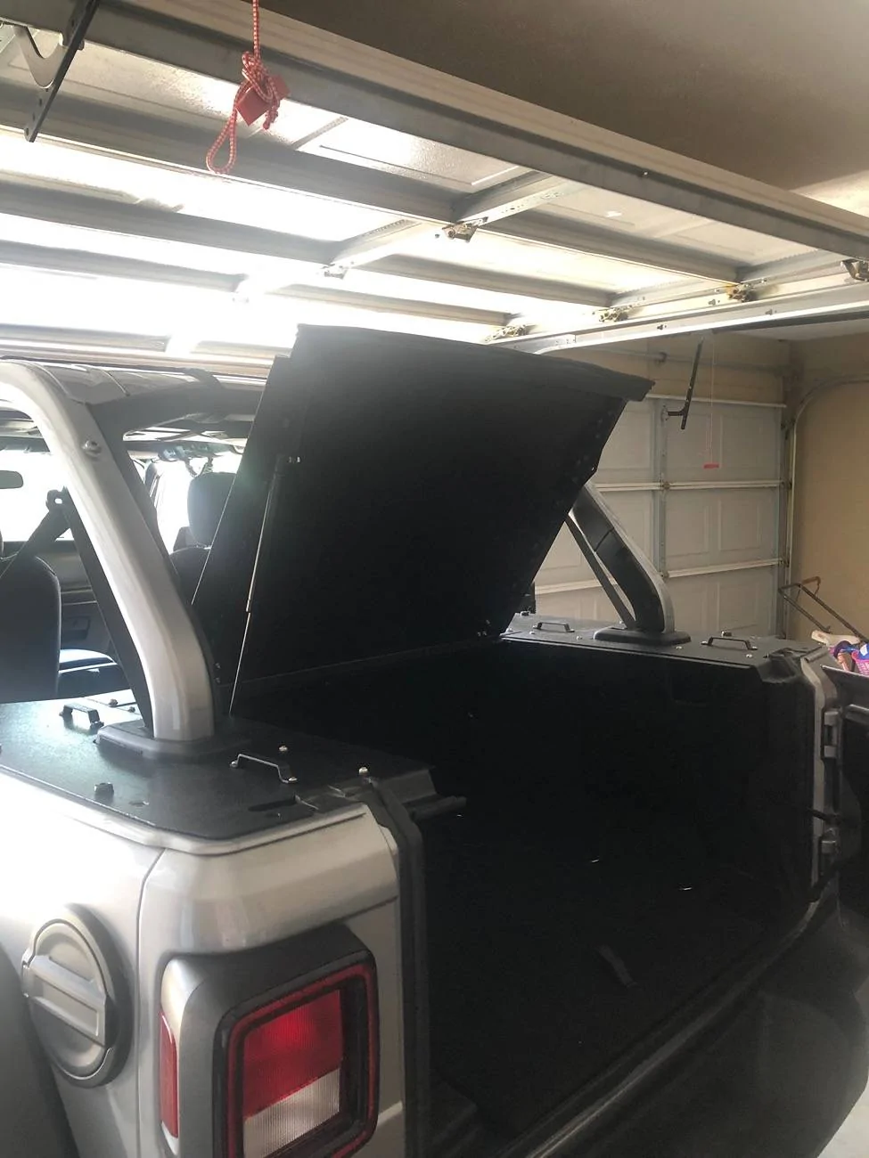

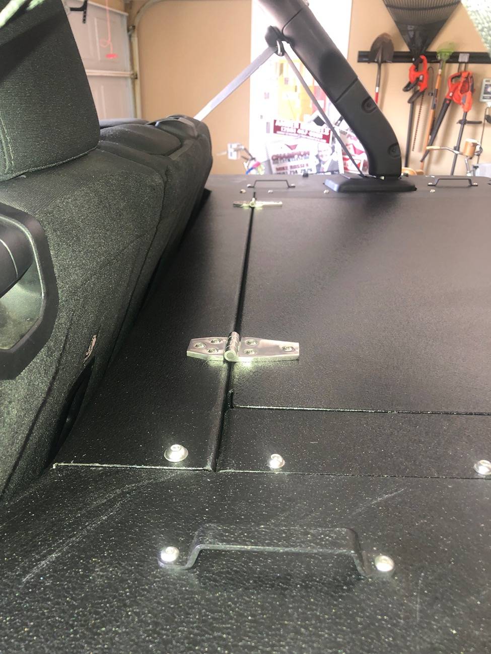

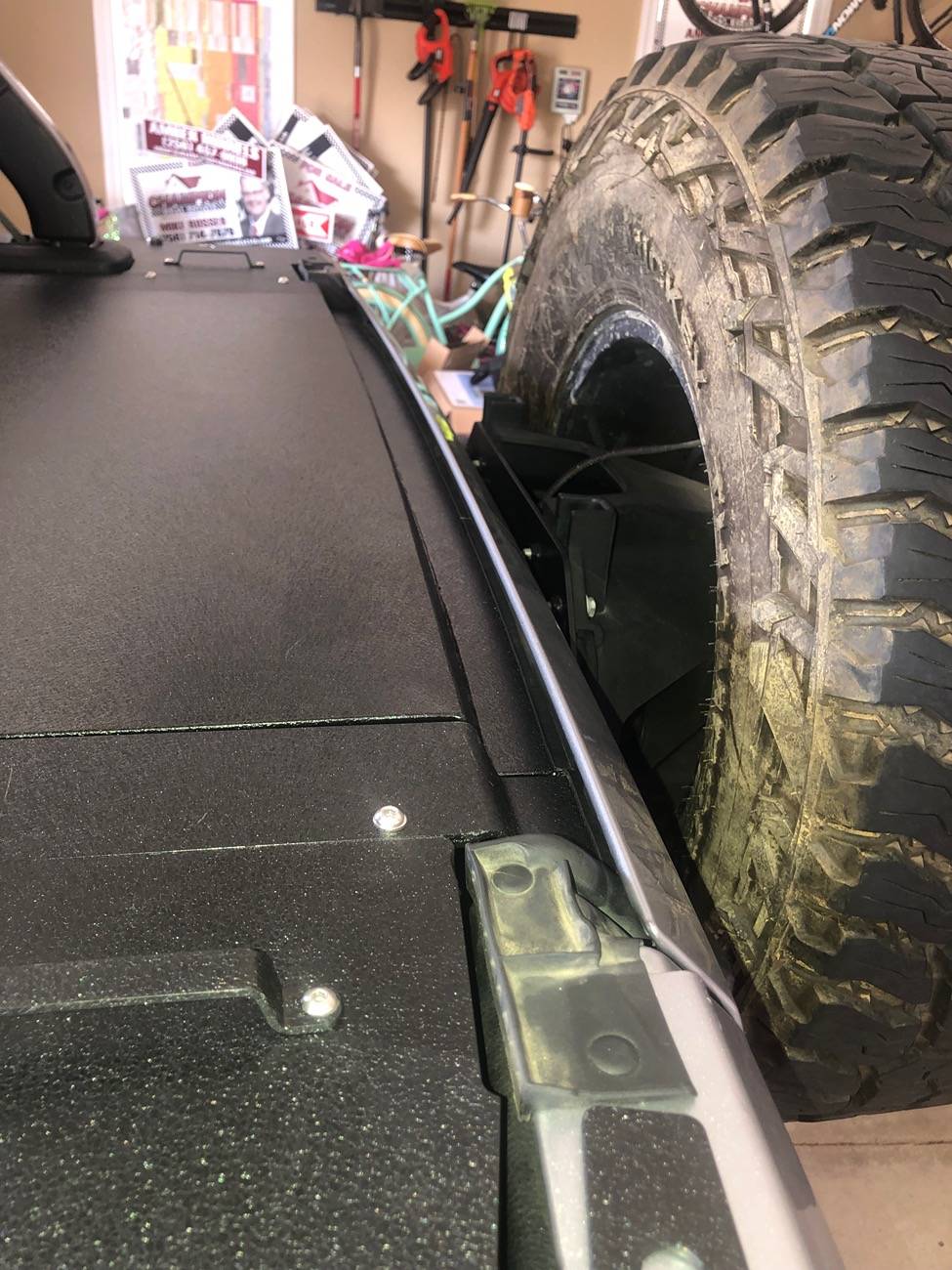

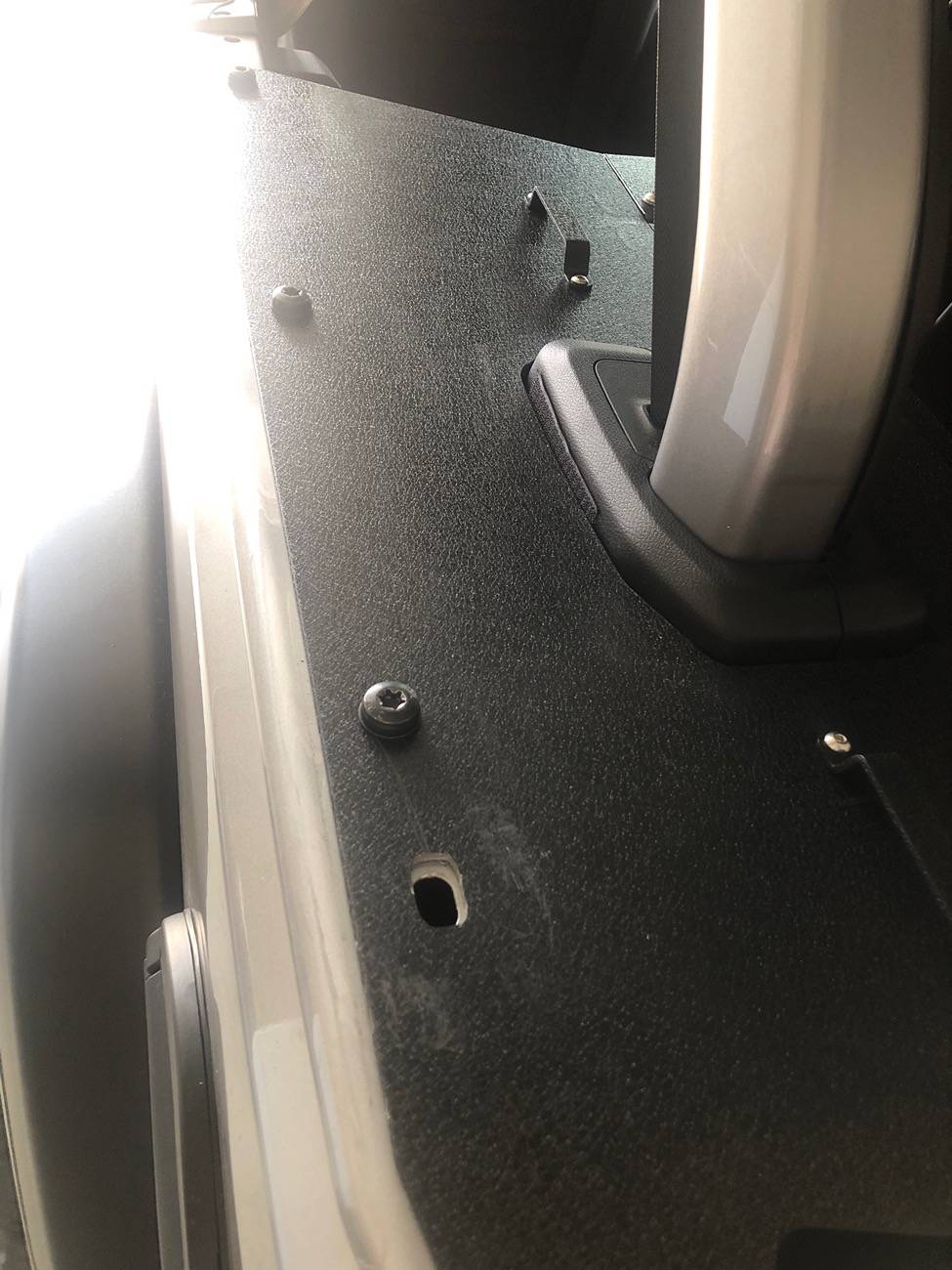

*Update* I found a DV8 Offroad Rear Storage Security Cover on FB Marketplace for $250 from a guy who sold his Rubicon and bought a Bronco 🤭. Took a while to install, because I had to drill two holes to allow the hardtop to be installed on top of it. I will post an update in a few months on my experience with it.

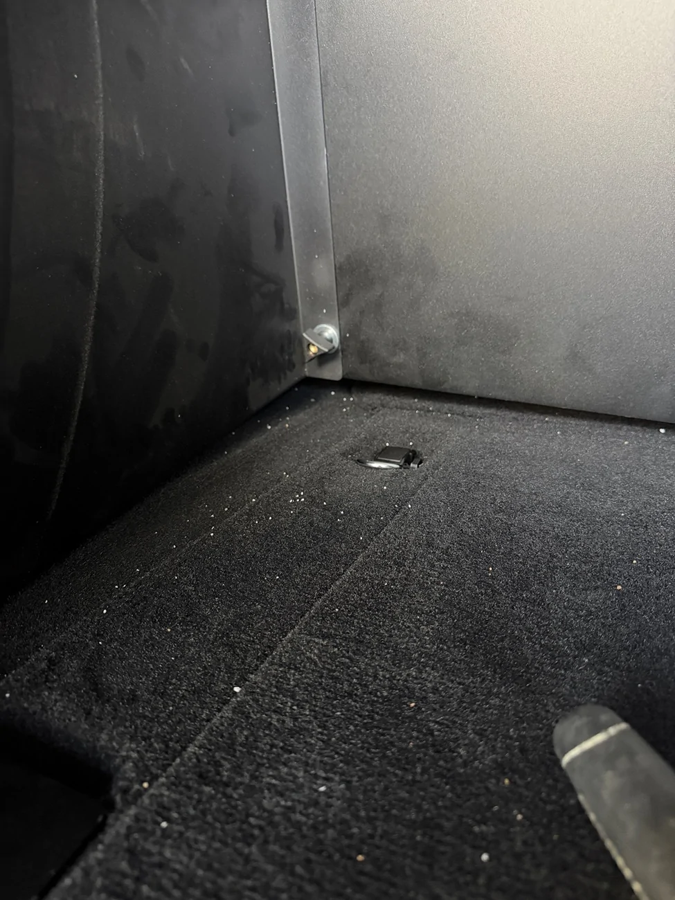

Did you ever have issues with the tuffy box being wobbly or flimsy? We just installed one and I can lift the whole back left corner up like 2 inches.
No, it shouldn't move that much. I don't believe it's anchored properly.
Interesting. We took it apart and put it together 3 different times and had the same outcome. There is only 2 bolts going into the floorboard. One on each side.

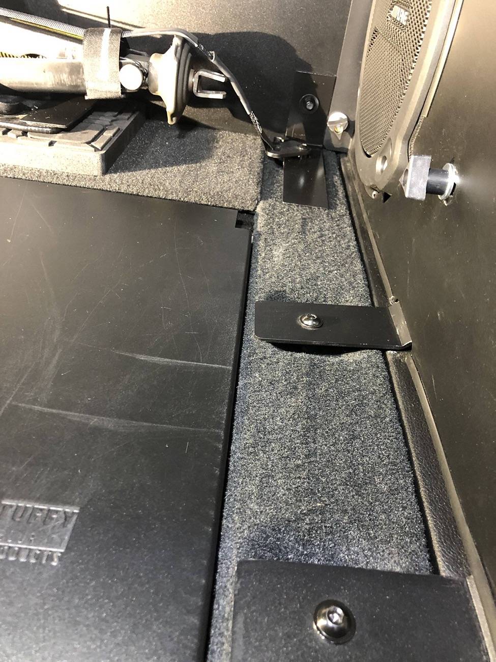

I added 4 more brackets for a total of 6. I used heavy duty Simpson Strong-Tie L-brackets from Home Depot. The mounting points are already there.
That's strange. It's been a while since I've had that system but I could have sworn it had two anchors per side. I never had anything move even a little. It was tight enough you couldn't get anything under it to pry. Have you contacted Tuffy?
