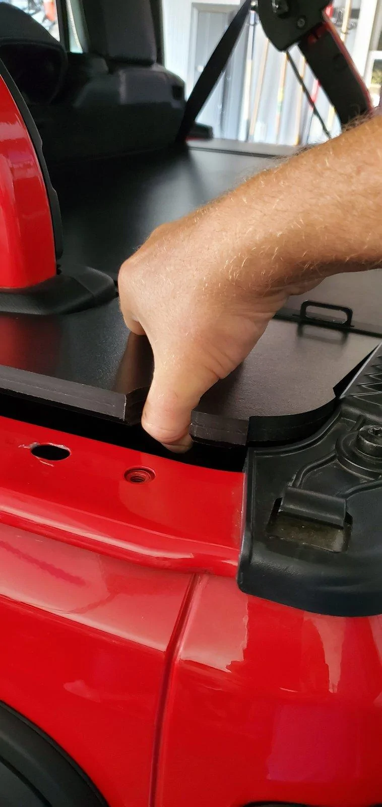

I just installed my Squadbox 2 days ago and have discovered a major flaw. You can easily reach into the hole on the back left side that is for the hardtop connections and pull out the left top cover piece. I have contacted Tyler regarding this and he has told me they are working on a solution for that and it will be about 3 months before they have a resolution. I am not happy considering it cost over $700, I fought this thing for almost 6 hours trying to install due to the instructions being horrible, only to now discover that it is not as secure as I need it to be.

Since it has been about 2 1/2 months since I installed this, I have emailed Tyler for an update on the solution and am awaiting a response. Tyler has been very good about responding, so I expect to hear something soon. To be honest, the fix that I did really wasn't difficult at all, I just took an L bracket and bent one side of it so that it was more of a Z shape, then screwed that piece to the underside of the back let top piece along the edge so that the Z bracket goes under the metal of the jeep, and it is very secure with that. Overall, I have been very happy with the Squadbox and really pleased at how easily I can remove and re-install the top and front piece behind the rear seat if I need to haul something larger. The one thing I will say is that you absolutely need to have your patience when you first install this, as the directions were very vague, however, when I purchased this, Tyler did provide his cell number and said to call him if I had any questions during the install. It is possible that the instructions have been updated since then. I have also heard very similar install issues with the Slipstream. Bottom line is that to have a secure enclosure such as the Squadbox or the Diabolical Slipstream, it takes some very good engineering from a manufacturing standpoint, and the product will be somewhat difficult to install. Again, I am very happy with the Squadbox and feel that I made the correct decision with going that route.

so I got a response from Tyler, they have a resolution for this issue and Tyler is shipping me replacement top side pieces within the next week. I would assume that the fix is the go forward with new orders.
