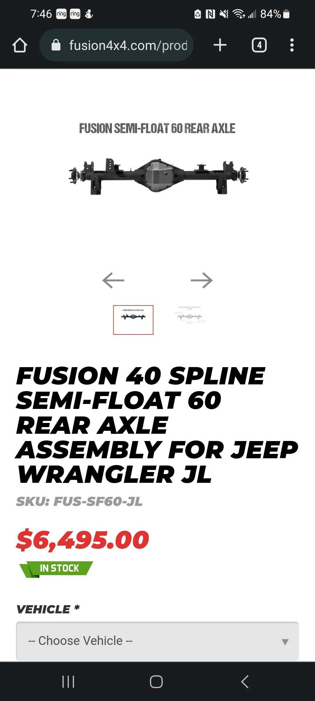

Could always go for the fusion 40 spline semi float 60 and keep your wheels and save $19k...
I’m already having to cry twice, I don’t want to cry 3 times. I’m considering skipping the 14 bolt and going straight to an 80 rear!?!
