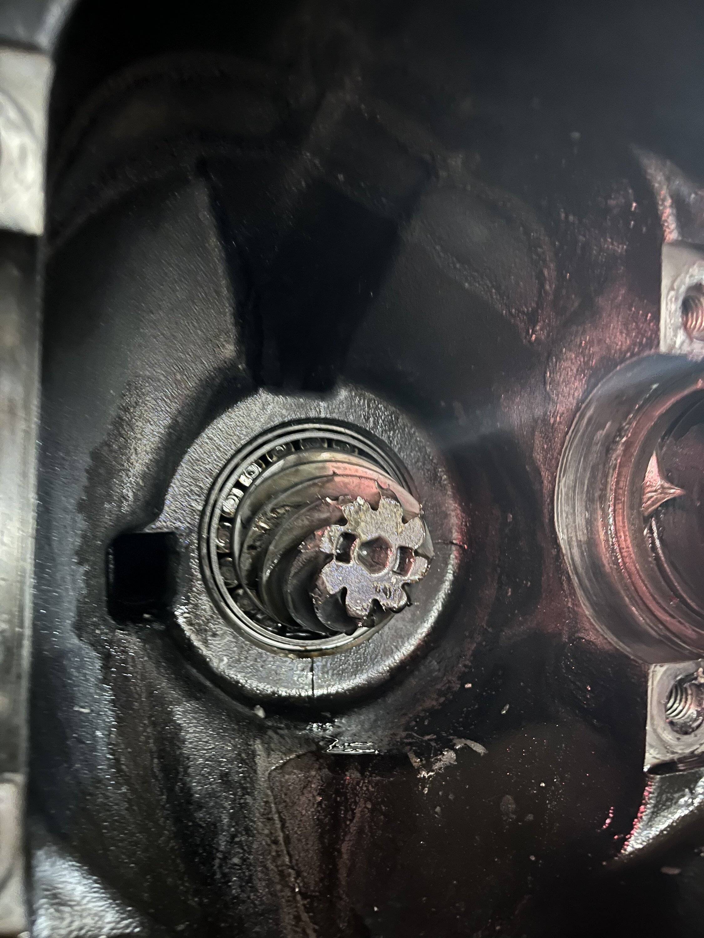

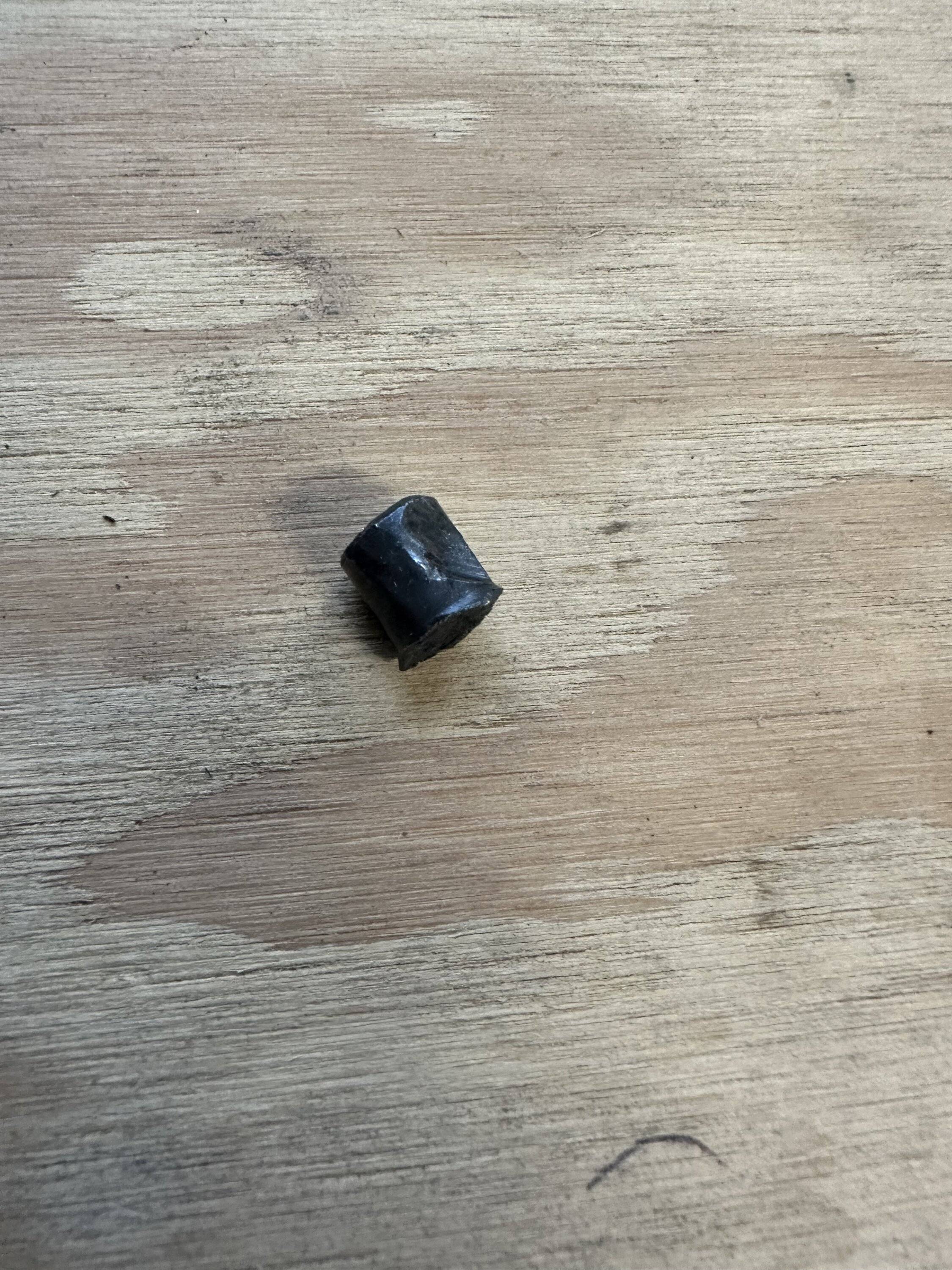

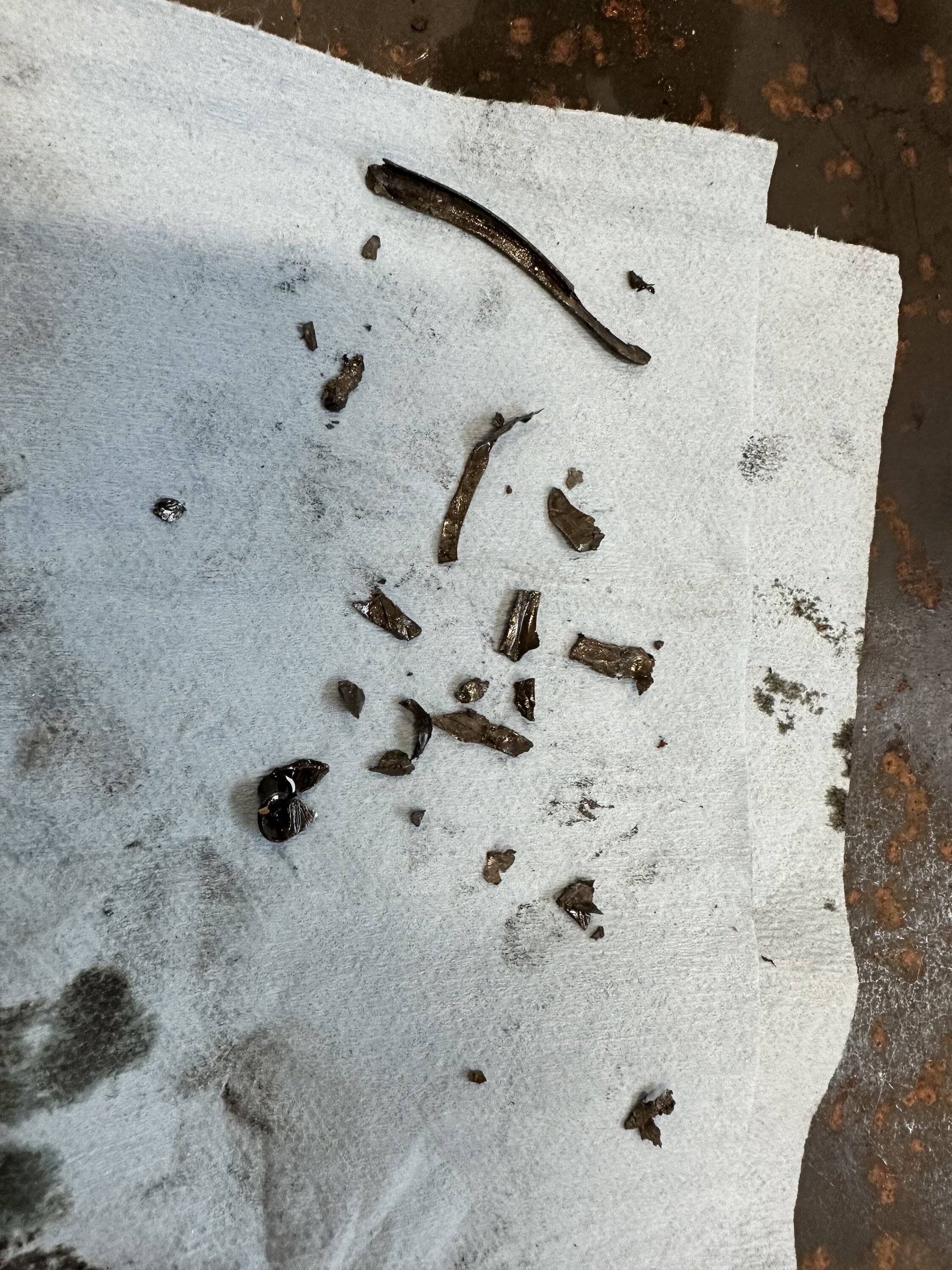

In case anyone is wondering how the Dana 44s will hold up long term with our amazing motors, here is my experience-
After roughly 35,000 miles, the rear locker failed and also took out the pinion teeth. I’m on 37”s with beadlocks. I do run in 2wd most of the time, but don’t do any hard launches unless I’m in 4wd or 4auto. Only 2wd donuts have been on sand.

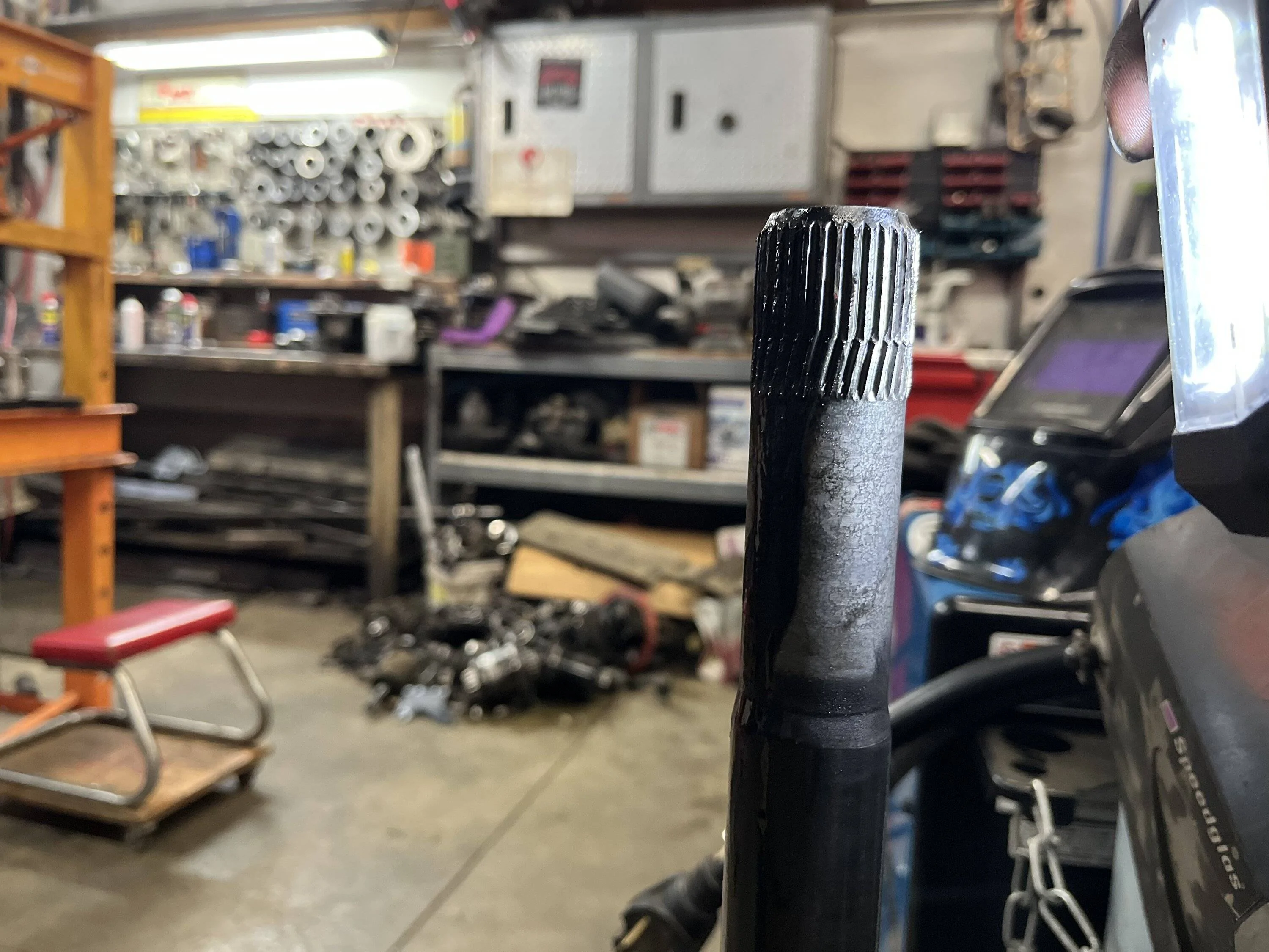

And the upgraded Dana Spicer chromoly shafts don’t like the power either ?

Nothing exciting when it failed, just snow wheeling in 4wd. Locker started clicking and not wanting to engage. Sounded like I had a baseball card in my spokes, but louder. But no noise when driving without locker.
