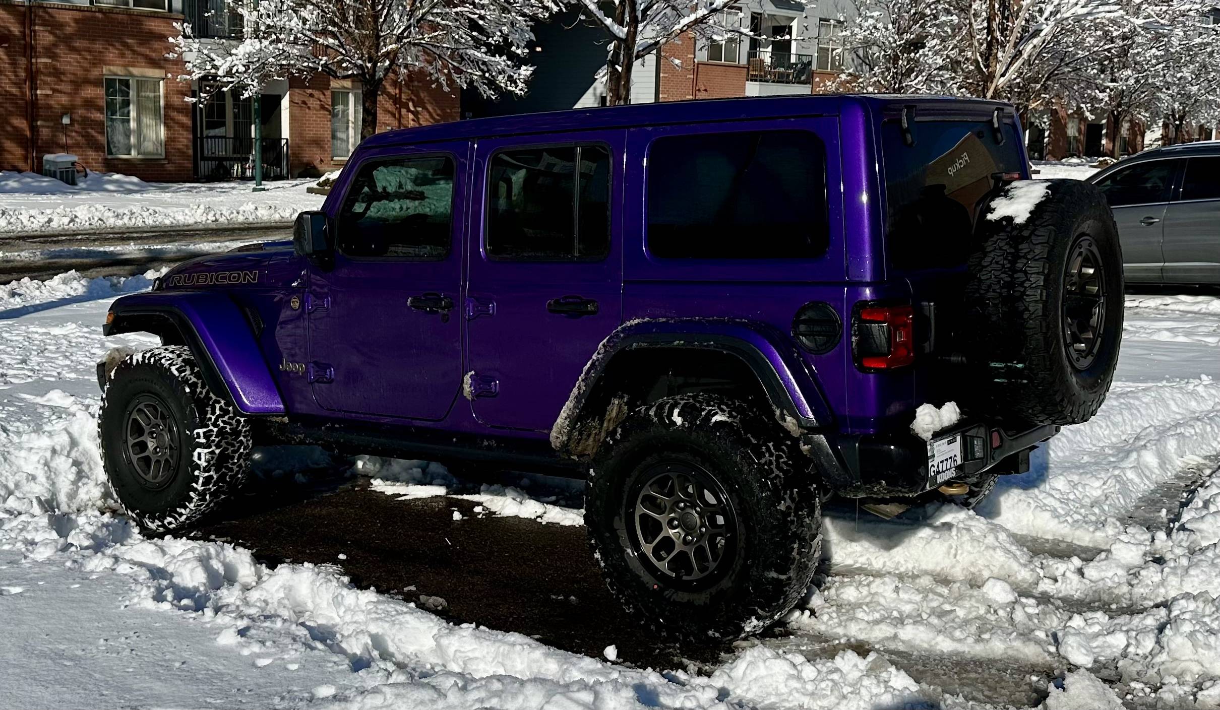

In case anyone is wondering how the Dana 44s will hold up long term with our amazing motors, here is my experience-
After roughly 35,000 miles, the rear locker failed and also took out the pinion teeth. I’m on 37”s with beadlocks. I do run in 2wd most of the time, but don’t do any hard launches unless I’m in 4wd or 4auto. Only 2wd donuts have been on sand.
And the upgraded Dana Spicer chromoly shafts don’t like the power either ?
Damn, that is a lot of miles. I have a 2020 diesel and I am still under 6k miles. I have a ton of mods and I am heavy on the pedal.
