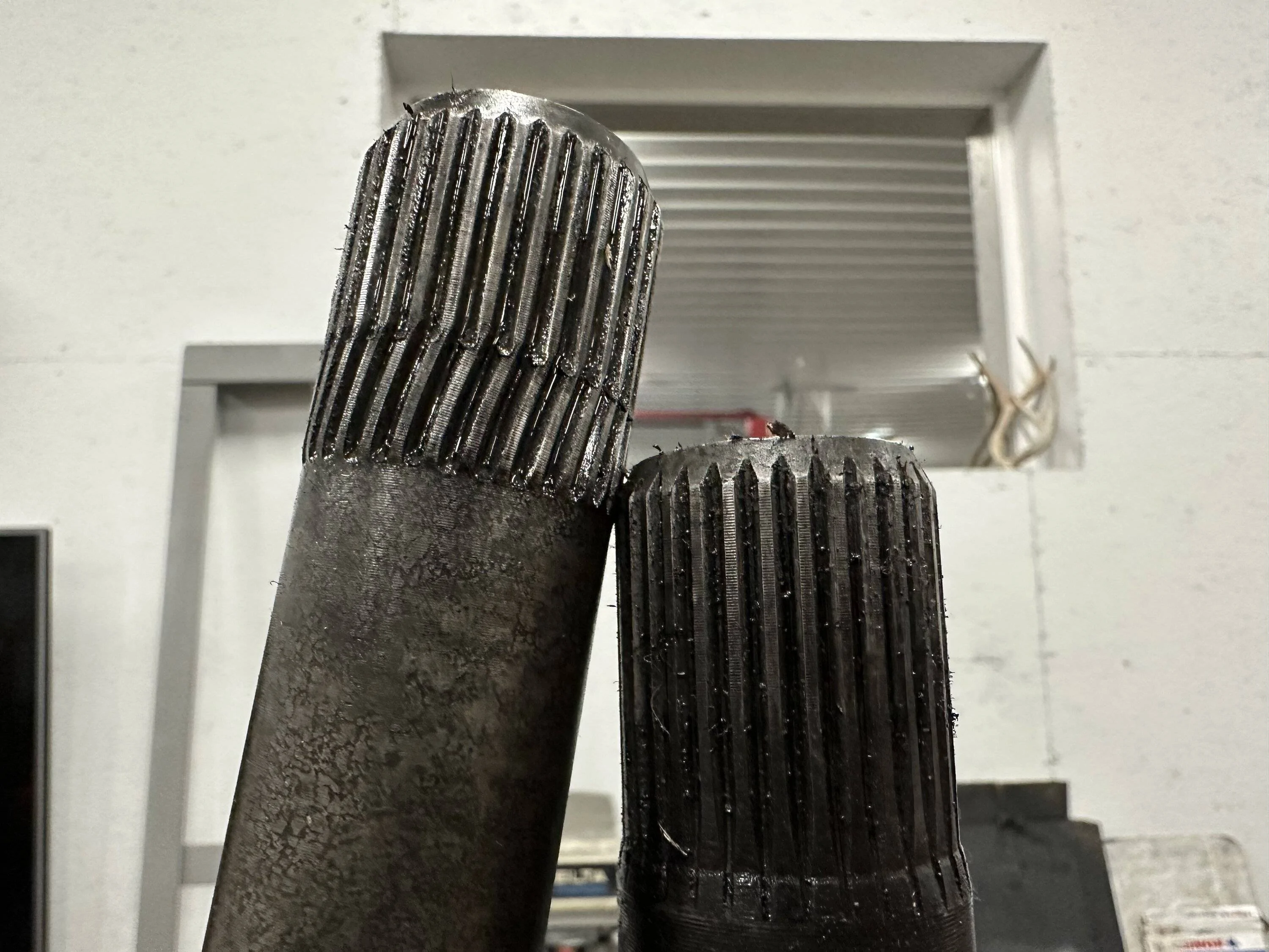

Driver’s side shaft was totally fine…
So at least you're sort of only slightly exceeding the limits. Incrementally, if you upgraded to the 35 spline shafts and an Ox or ARB 35 spline locker, you may take care of it.
Those look like they are either two different manufacturers. They are either two different models or the machining tolerances are very wide. The teeth area of the left shaft is a larger diameter than than the smooth section of the shaft. The right shaft is the opposite. The smooth area of the shaft is thicker and there is a slight taper down to the teeth.

22 JLUR 392
??? Camera angle?? both Dana Spicer Chromoly shafts, bought direct through a Direct Dana distributor. With Dana’s reputation though, I wouldn’t be surprised. Took me 1 year to get a U joint out of them…
