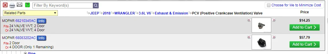

Does anyone know which is the correct part? I'm thinking about just swapping it myself and seeing if it fixes the problem.
