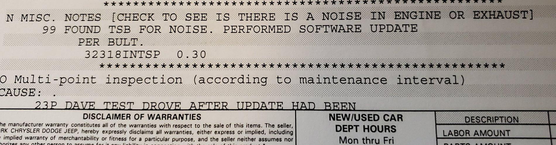

I just got my 2019 back today from the dealer for the steering TSB and some other services. I mentioned the rattling noise I was hearing on mine as well to see if there was something that could be done about it, or at least get it documented. I've been following this thread for a while and wanted to let you know they found a TSB for "engine noise" and performed a software update. I don't have any more details than that. The invoice doesn't have a TSB# or any specific identification for it. They told me about it over the phone as well, but I was at work and my mind was in 25 other places. It may be worth asking about. My drive home isn't very far and I didn't hear the rattling noise, but it's also cooler out now so the top is on. I mainly heard it when the weather was warmer and driving it open.

@Buzze Do you have the 3.6 or the 2.0? Is there a TSB number anywhere on that dealer report that other dealers could reference?
I have a 3.6. I took a screenshot of the line from my invoice and posted above. That's really all the info I have on it.

I dropped mine off today at the dealership and shared this information with the Service Advisor. Is there any way you can call the dealer to determine the TSB number they applied? I'm hoping my guy can find something. It would be nice to not have the motor knock! Thanks.

I just took my Jlur to the dealer. Dealer i choose was amazing as well. Got in line for the steering TSB without issue at all and told them about the engine noise, they found no noise (running 91 octane currently, i even drove with a tech and didnt hear it. Of course lol) i simple showed them the screenshot of the TSB from @Buzze and they ran the that TSB. The other tech there said its known by jeep but no real fix for the issue except updating the computer at this time.

Let the forum know if you hear less knocking. Last night, I added some 89 octane before I read about the potential TSB. I couldn't hear the knocking as I approached the dealer (of course). I sure hope they find a valid TSB.

Put 87 octane back in yesterday after the TSB they did. (Which was acctually for the fan not engine noise.) Knock is back. Guess im running 91 until they figure this out
