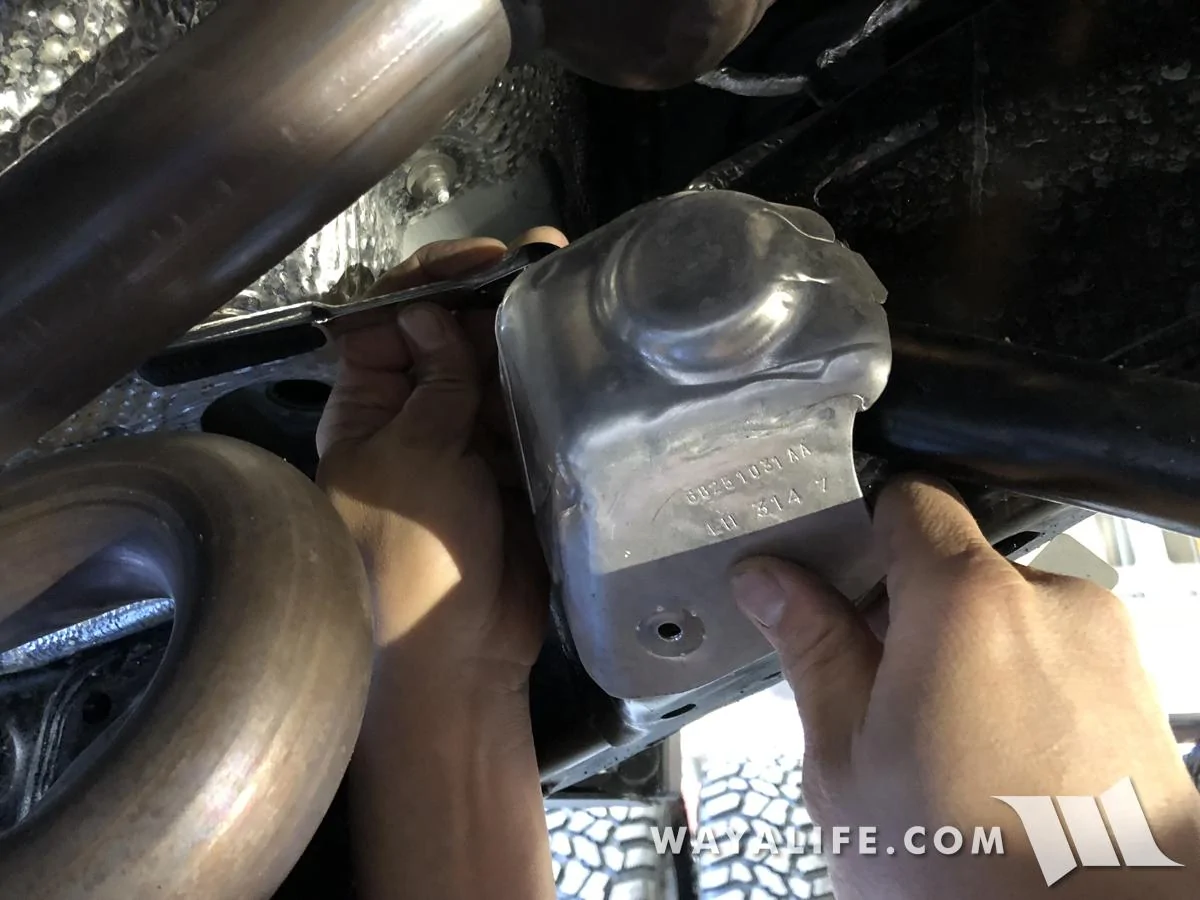

There are two heatshields inside of that flag nut you mentioned above inside of the control arm (covering the upper bushing/bolt). They could be loose and rattling.
I think i need to just to check all those! Any ideas what I can use to deaden the tin sound. I tried using electrical tape and JB weld muffler sealer.

Dunno man...just check the screws that fasten them.

It sounds like a tin rattle.... heat shield, muffler shield.... not plastic.

LOL yeah I'd suppose Jeep really doesn't need another fire from tape or sealer on a heat shield. Don't try to insulate a heat shield!
It was a temporary small ball of electric tape to determine whether it vibrated.
But yes I was worried about that as well.
