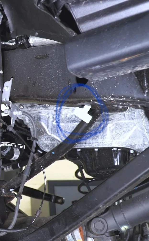

mine just started rattling the last month. I belive it's due to offroad runs. In my opinion it's not engine but something like heat shield vibrating. Also tried hitting items lightly with hammer. See photo.....this seems to be loud and possibly rattle???
Recommend reading the thread... we wish it was as simple as heat shield rattle but that shouldn’t go away with octane and worsen with temperature.
that’s the end of the flag nut for the upper control arm. That won’t rattle if your upper control arm bolt/s are tight.

I understand that. But it was a theory. Engine sounds fine! It is rattling and now bugging me alot
