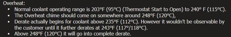

Dang! I was the thread starter and I'd still LOVE to have better cooling. Just got back from 10 days pulling a travel trailer and every grade, I have to really watch the throttle position, start the manual fan and gear down...even still, it bumps up against the de-rate temps.
I'm VERY interested in this radiator. It would sure be nice to have some real world feedback before dropping coin...

Thermostat change would be the first step 195* open if one is available anywhere.
2nd is look at what the cfm is on the fan at 1" static pressure if any specs on it.
Having the stat open sooner will help, fan on high speed on start, seal fan shroud so all the air is being pulled through the radiator.

changing a thermostat does nothing to change how much heat a radiator can exchange; all it does is change the minimum temp the system operates at.

how would you expect that a different temp thermostat would help keep these things cooler when pulling?
it might help coolant start out at a cooler temp, but that would mean it would just be fully open sooner and then we're back to the limitations of how much heat the cooling system could dump.

Most times if its cooler going down the road with a cooler stat and you hit a hill it gives you more time before you get to the temp limit, that usually allows you to make it up and over . Not gona argue with ya..don't believe it don't do it.

Wouldn’t having a lower temp T stat result in lower overall temps? These engines are designed to run at a specific operating temp range so I can’t imagine that would be good for it. Plus wouldn’t that accelerate fuel dilution in the oil?
With how finnicky these diesels are already, I don’t think that’s the route I’d be willing to mess with. A better radiator or remote oil cooler would be safer, though so far no one has had luck building the oil cooler solution. Just no where to mount the damn thing.
I just turn the fan on high and drop my speed. Seems to work fine.

i believe that in the very limited scenario you defined here you might indeed indicate a slightly lower coolant temp for a little while until you generate enough heat that your lower temp thermostat opens and/or you run out of "hill".
but you haven't done anything to increase your cooling systems total cooling potential, and once that 'stat opens (which a lower temp 'stat will do sooner) everything's going to warm up just as fast if you're climbing something more than a "hill".
and don't forget that to start with, we're dealing with a Compression Ignition engine, where our fuel charge is ignited by the heat in the cylinders created by the compression of the fuel charge in the cylinders.
that's not going to work the same (read: as designed) if you're starting out with cylinders that aren't running up to their intended temperature, and you increase the risk of carbon and other contaminant buildup because things aren't getting up to working temps.
(note that there are even warnings in our Users Manual about needing to avoid extended idling to prevent the risk of running too cool and potentially causing damaging buildup.)
