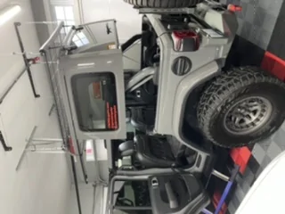

I bought the Racor lift and Topsy brackets a few months ago. I mounted two 5' long 2x4's to the ceiling joists in my garage. I was able to use 3 large lag bolts for each one. Then I mounted the Racor to the 2x4's using the supplied bolts. I also used 1" PVC with pipe insulation abound it; zip tied it to the bottom of the rack to prevent any scratching of the top.
Jeep Wrangler JL Racor Hoist System IMG_0199
