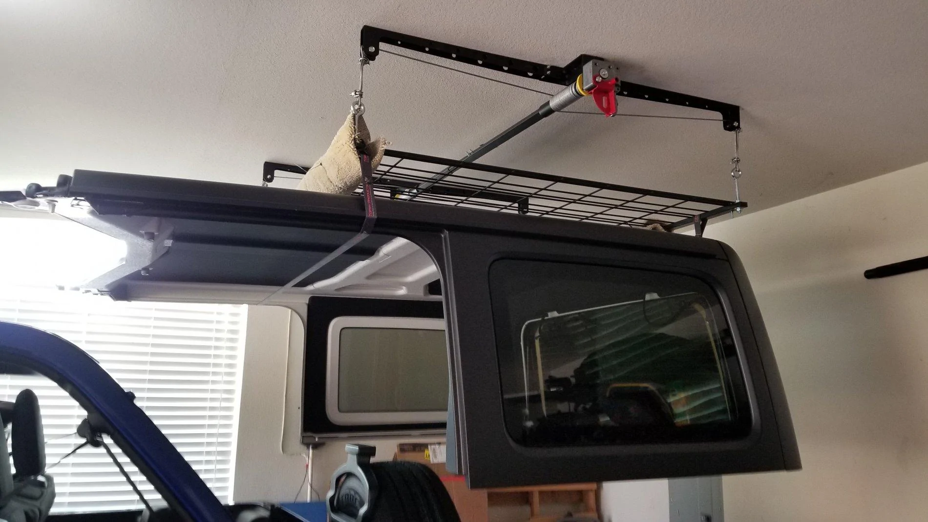

The wind was fierce today (30+ mph), but I went for it anyway. The hoist worked flawlessly. I had some old carpet that I used for protection until I get the pool noodles.

pipe wrap from Home Depot / Ace works well too.

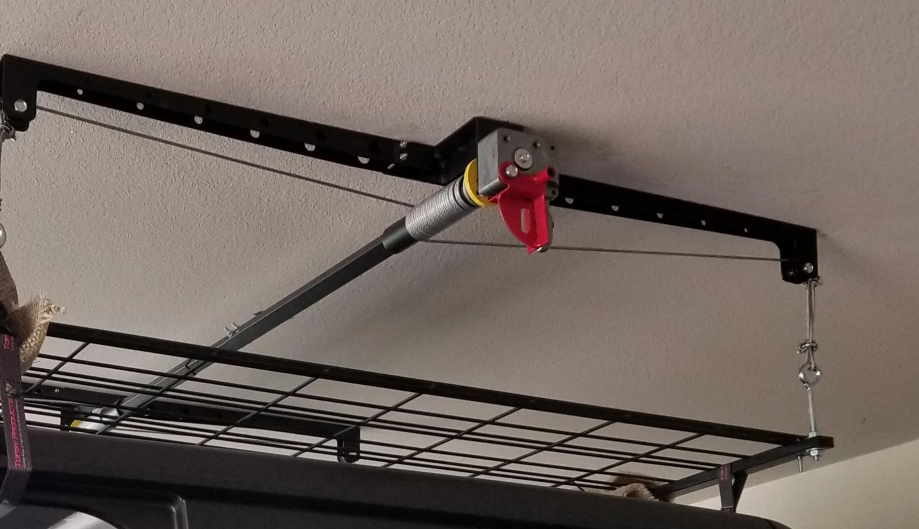

The yellow disc in the picture is the Topsy steel cam drive. You have to remove the plastic one and thread the new one on the cable before attaching the axle to the brackets on the ceiling. The instructions with pictures will help guide you. It isn't difficult to swap them out. You need a 10mm wrench to remove the U bolts.
Something else I did was to mount the bracket in my picture before attaching the gearbox. The Racor instructions say to attach the gearbox before mounting the bracket to the ceiling. If you are doing it solo, the added weight of the gearbox provides an extra challenge.

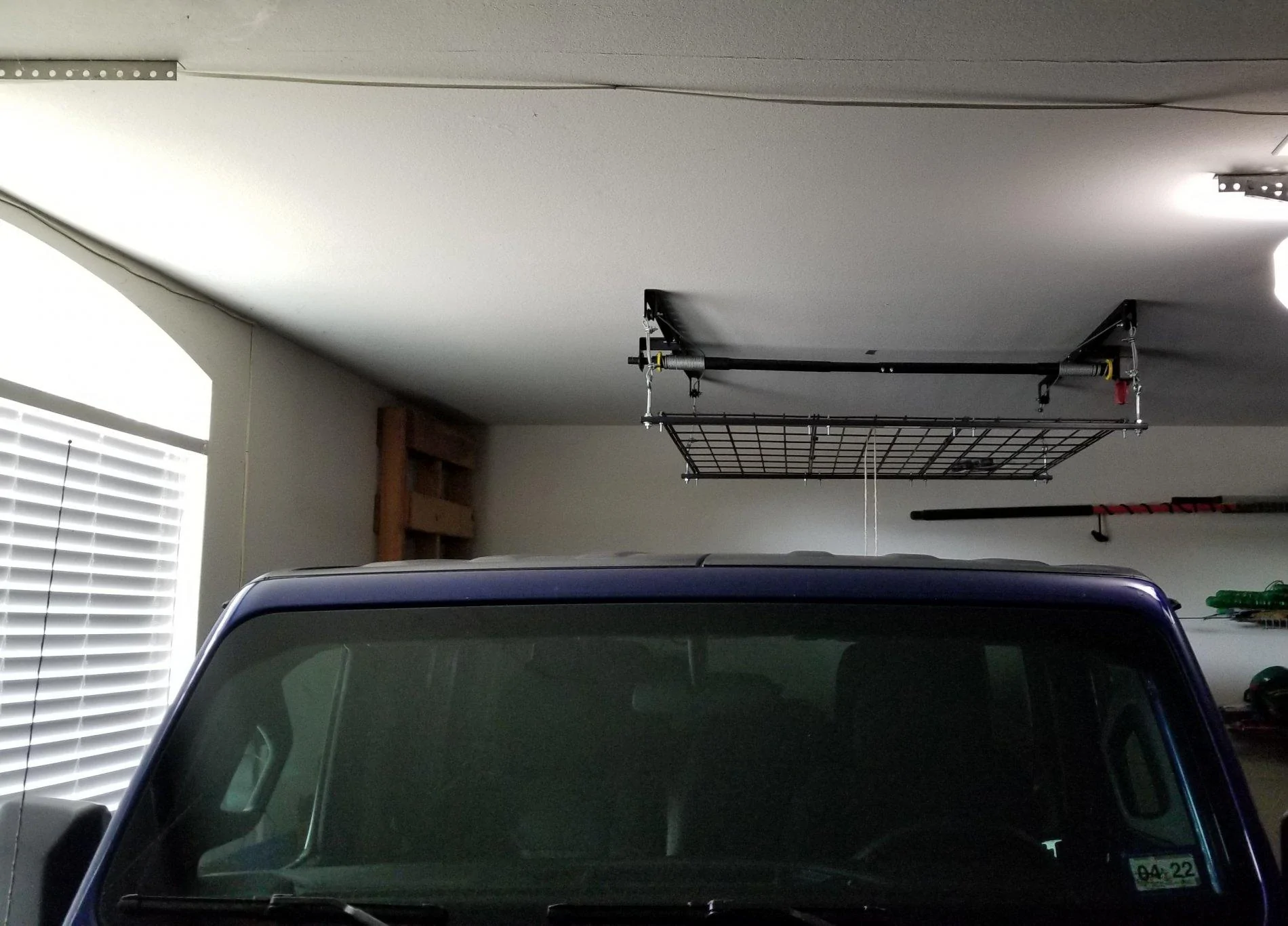

Mine is off center due to the joist placement. I didn't adjust with 2x4's because it wouldn't leave enough room. As it is, the rear glass doesn't quite clear the spare in the closed position.
I hope that helps!
Edit: Added pic
