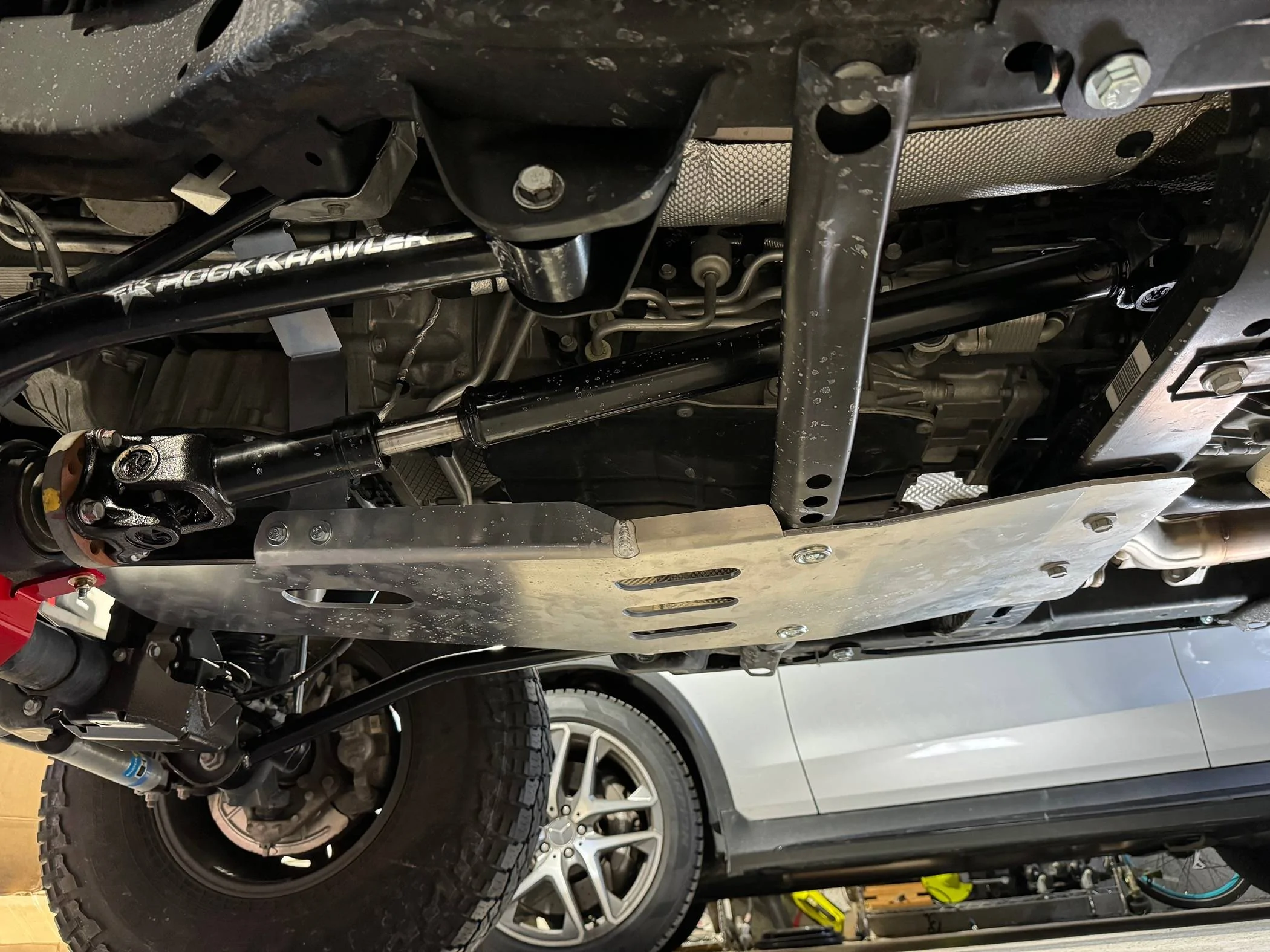

Again a ‘plug’ for the ValvoMax. I use the Fumoto as well on a couple vehicles, but I surely wouldn’t go off-road with that not being fully shielded with some kind of belly armor.

I had Fumoto on my JK, I have it on my 392, but I also had/have belly armor. I wouldn't use it without it.

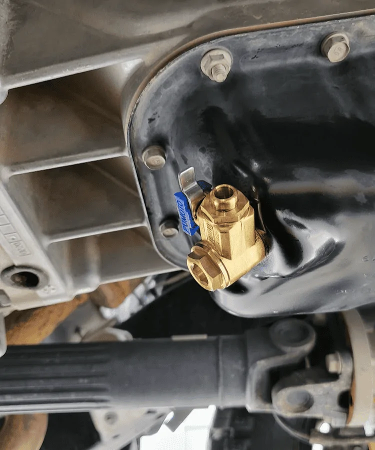

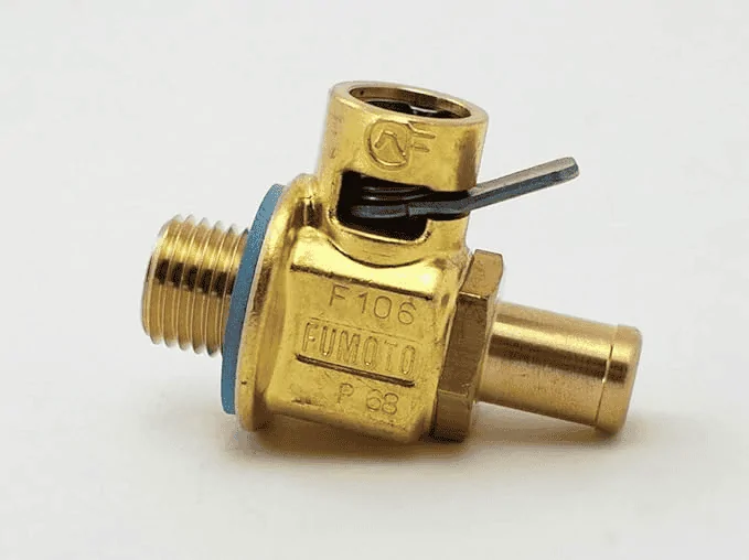

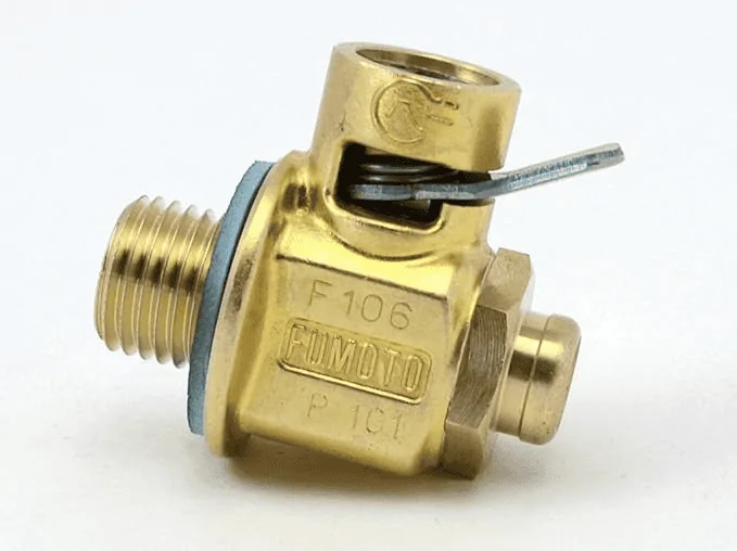

I have a Fumoto installed but I'm switching to a lower profile oil fitting designed to hold a drain tube securely. ValvoMax, Stahlbus and NoSpill all have an integrated drain tube and seem to be lower profile than Fumoto.
The beauty of using a quick opening drain valve is draining the oil straight down a tube into a container without spills. I still need a small drip pan for the filter and filter housing drips, but the sump can drain straight into a container. Simplifies and speeds up oil changes which stay cleaner.
The Fumoto doesn't hold the drain tube securely enough if you have the long spout version, but hardly at all if you use the shorter spout version to try to reduce how much the spout hangs below the pan.
The other difference is the petcock valve the Fumoto uses versus ValvoMax's check-ball valve (looks similar to Stahlbus and NoSpill). Not sure if that's a functional difference that makes one valve better than the other.
You'll want to purchase a length of vinyl tubing with a fractionally smaller inside diameter. The one I keep on hand needs a firm press to install it, even when the valve is well-heated. The fit is almost too snug, but that also guarantees it will stay in place even when errantly bumped.

good link, thanks. The tube I'm using looks similar and was part of a simple tube kit Fumoto sells. The Fumoto tube kit included a couple plastic fittings that snap onto the brass lip of the Fumoto. The tube by itself worked better than the plastic fittings did, and stays on the longer spout fairly well at first, but not well enough to be secure and starts to slip off if you have to move the drain can a little. The tube doesn't stay on the short spout at all.
I considered looking for a slightly tighter fitting tube to make the Fumoto work, but instead for the Jeep I switched to the ValvoMax for various reasons. Stahlbus and NoSpill look like they have similar function to the ValvoMax.
