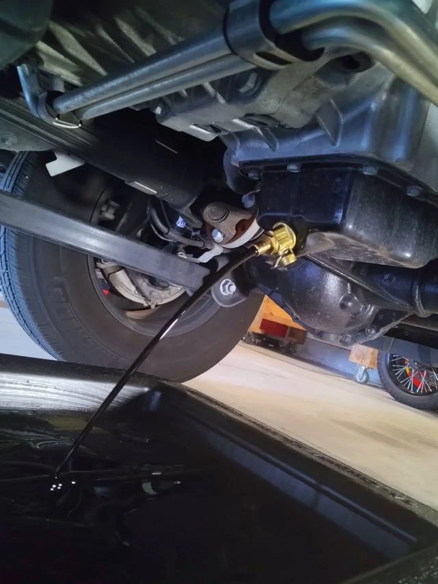

Definitely the underbelly of an asphalt cruiser...... OK maybe an occasional gravel drwy. That QO as is would never last a day on any badge of honor trail.
The photo was provided to help the OP.
The pic shows the beta test just after the valve was installed, prior to purchasing an engine/transmission skid plate. But thanks for filling in the blanks preemptively.
Rt on....got it....Getting ready to install my skids. Lets see yours and how they coincide with your QO.
