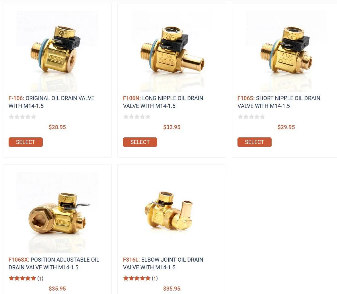

Still waiting for the ecodiesel to arrive and wondering if there are restrictions in the area of the oil drain bolt that would exclude any of the Fumoto valves.
I’ve got a straight one, F106N, on mine and there’s nothing in the way at all. I’m NOT running any aftermarket skid plates and don’t off road to any level that would put it at risk of contact with anything.
I bought a stahlbus valve a while ago and after denting my oil pan on some rocks I decided to hold off on installing it until I put skid plates on. I installed Next Venture Skids a few weeks ago along with a new oil pan and put the stahlbus valve in.
Thanks to all who shared their thoughts. Will get one ordered today that will fit my needs. So good the hear the short nipple works with skids installed.
