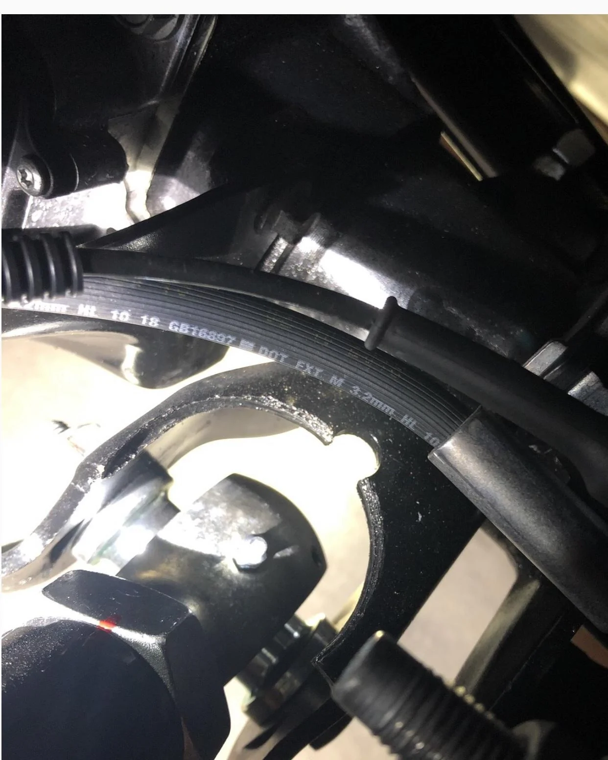

Does anyone know if the Rock Krawler front LCAs have this bend inward for better tire clearance at full steering lock to lock? I know they seem to have a bend upwards for clearance against rocks, but they appear to not bend inward. Anyone can confirm?
This is important for me because my tire is basically a hair from my stock LCA at full lock.
EDIT:
I found the answer to this already, thanks.
I'll answer again here for anyone that doesn't see the other thread. RK LCAs do not bend inward, they bend upward for ground clearance. If you check out their install instruction on their website they give recommended minimum backspacing for each tire size based on model and lift height.

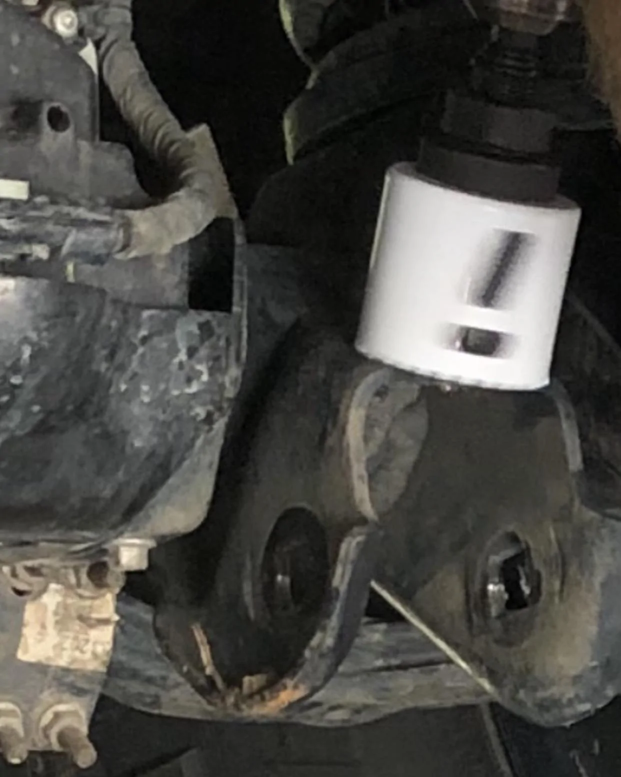

If you go with rk xfactor lcas, a couple things to keep in mind. The grease fittings are hard to get to, and the jam nut might hit the bracket at full flex, depending on length of your shocks. To alleviate this problem rk recommends that you notch out your lca bracket like this....
Jeep Wrangler JL Questions for Rock Krawler Front LCA 14A7C8B8-347E-48D8-8D09-FEE6A4FD0C63
I used a metal hole saw to cut mine...
Jeep Wrangler JL Questions for Rock Krawler Front LCA 8DDF13FD-FFCF-47EC-9142-F473C21DC2E8
Of course if you don’t have a problem with the jam nut hitting, and you don’t want to notch your bracket, you can use a 90 degree grease fitting, it’s still tight but you can get a grease gun on them. Or you can take them loose to grease them.... :) ... imho these are some of the best arms on the market.

That is a sizeable hack into the mount that has to weaken it. For my RK arms, I cut out about half of what they recommend and it allows full droop. The problem is I now cant get the hard to find 000 grease into the fitting without dropping the arms. I tried 90 degree fittings and cant seem to get grease into them. All things considered, I would buy Metalcloak if I could do it again....these arms are a pain and I dont like hacking the mounts.

It doesn't weaken the mount at all. It's just extra metal you're trimming away. Completely non-structural.
