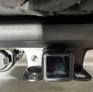

vetygud
Michael
Jul 13, 2022
435
1,104
Nisswa, MN
2022 Jeep Willys 2 door Sarge
Retired LEO
I installed the Air Lift 1000. Easy install with a single fill valve next to my hitch tube. It is nice to adjust the pressure anytime for load, hitch mounted bike rack or trailer. It stopped the sag and has stiffened the rear end up for the better. I've had the air bags for a year and a half with no problems. I use a Milwaukee 12V pump that I carry to fill or adjust when needed.
Jeep Wrangler JL Question regarding sag when towing Air Lift fill
Jeep Wrangler JL Question regarding sag when towing Air Lift right
Jeep Wrangler JL Question regarding sag when towing Air Lift left
