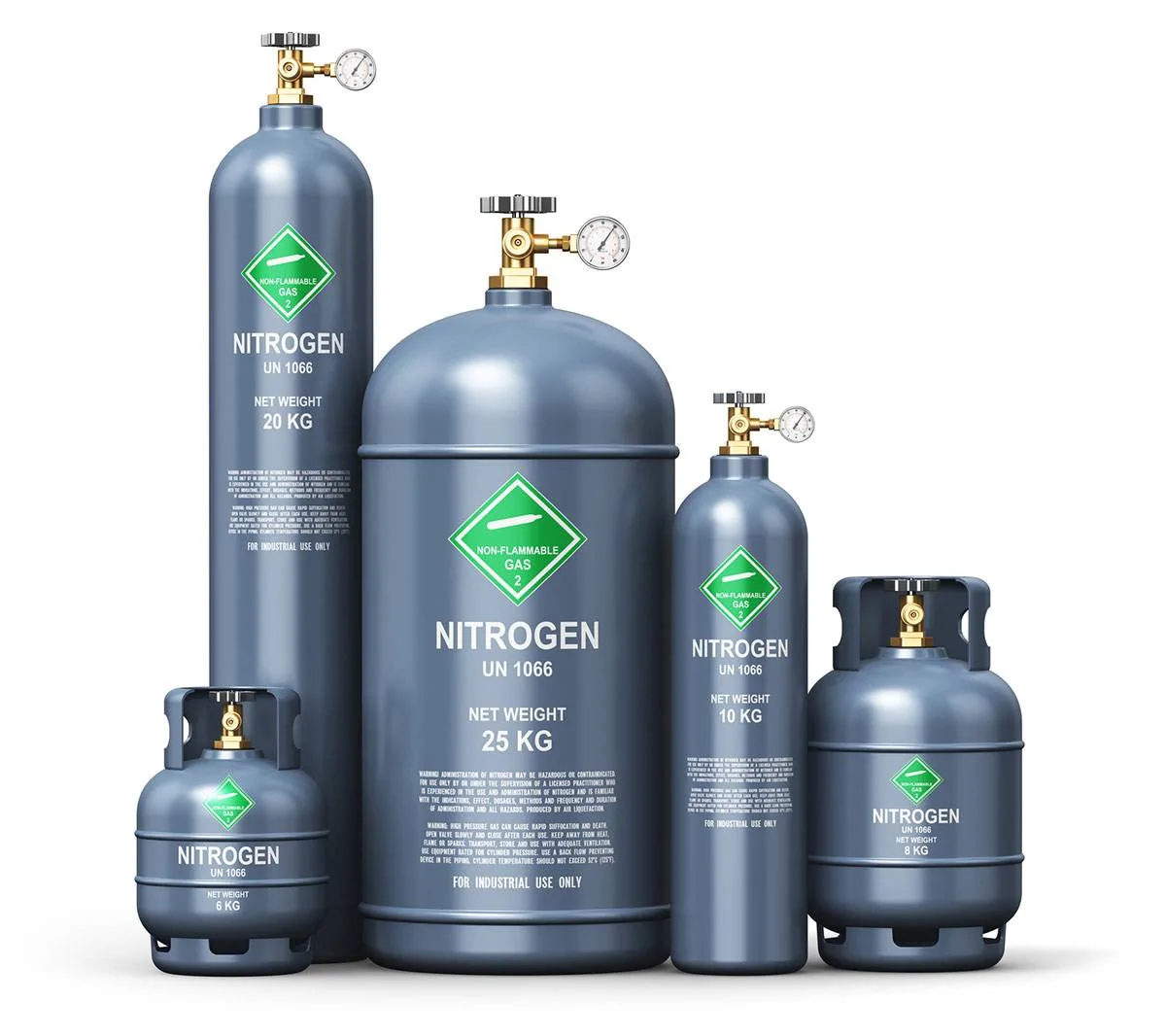

What size will we need to carry to air up after airing down, possibly several times before getting a refill ?
Jeep Wrangler JL Question about increased PSI while driving 098AD292-36C2-48FA-BA4E-B5FD414559E2
:facepalm:
