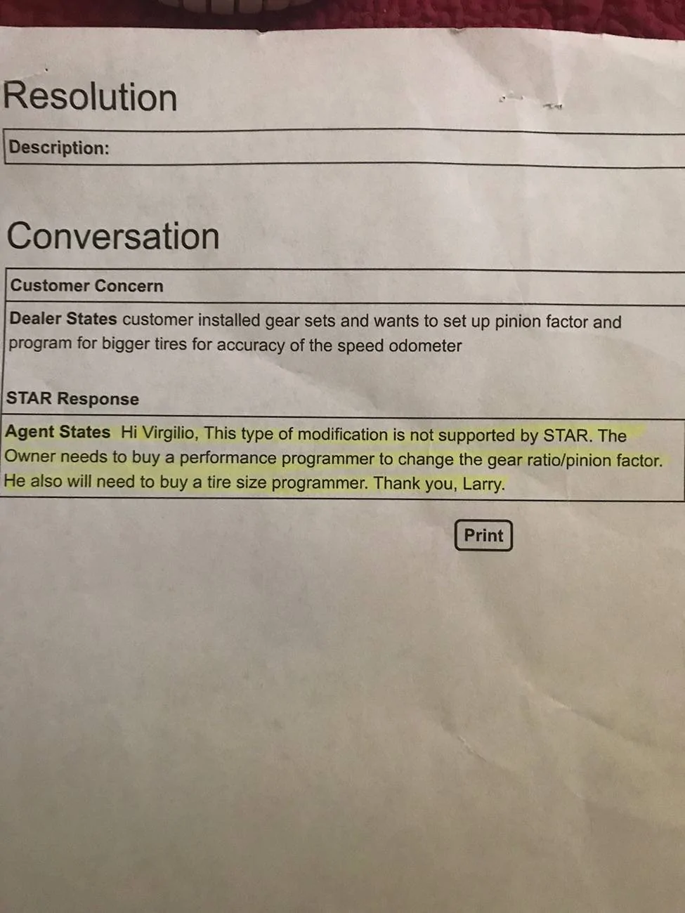

Shouldn't the dealer have dealt with calibration when doing that install?
Old post, but this dealer response is from October of 22
Jeep Wrangler JL Programming after lift & tires? 4FCB225F-1829-4B12-8C49-92E93CFB6F51
Saved in case they ever bitch, blame, or deny warranty due to the Tazer.
The dealer installed the 35s, initially refused to calibrate the Jeep to deal with them, then apparently eventually gave in and did it.
Maybe it has changed in two years, but that’s what I got when recalibration was requested 🤷🏼‍♂️
Request due to “Service 4WD” — input shaft speed, wheel speed. Jeep couldn’t fix it and aftermarket was their “fix” amazing.
