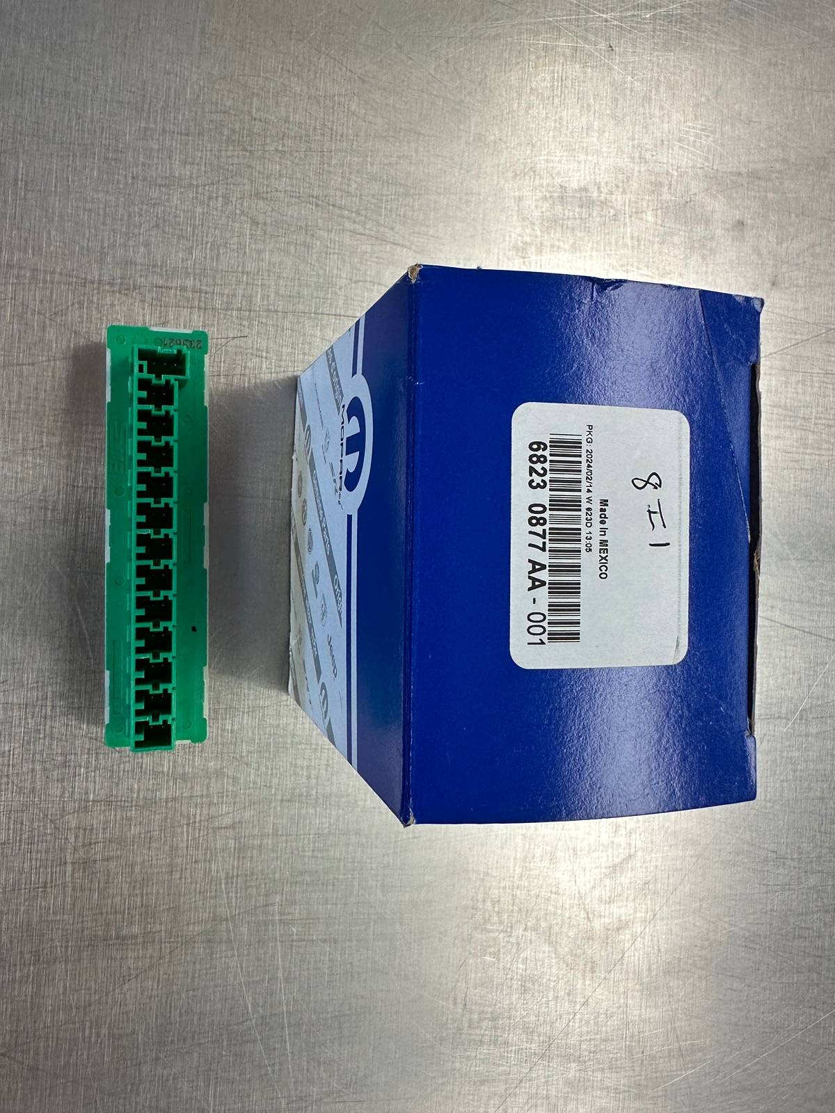

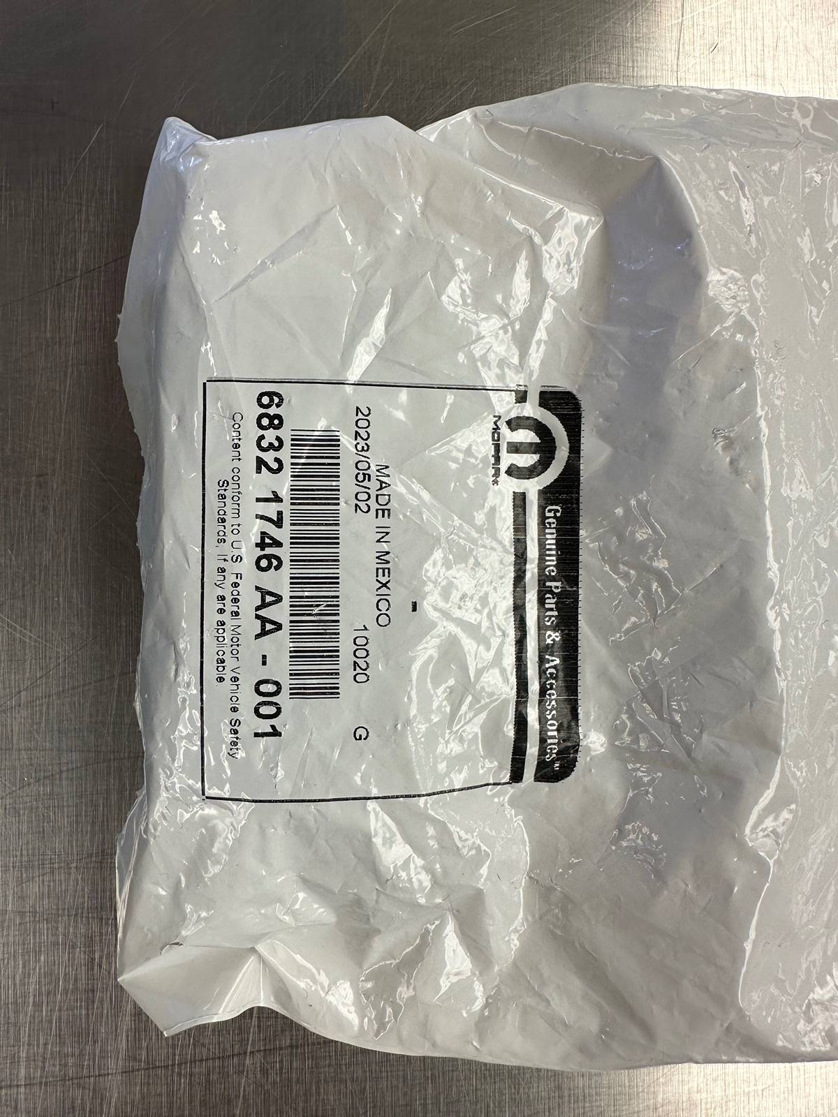

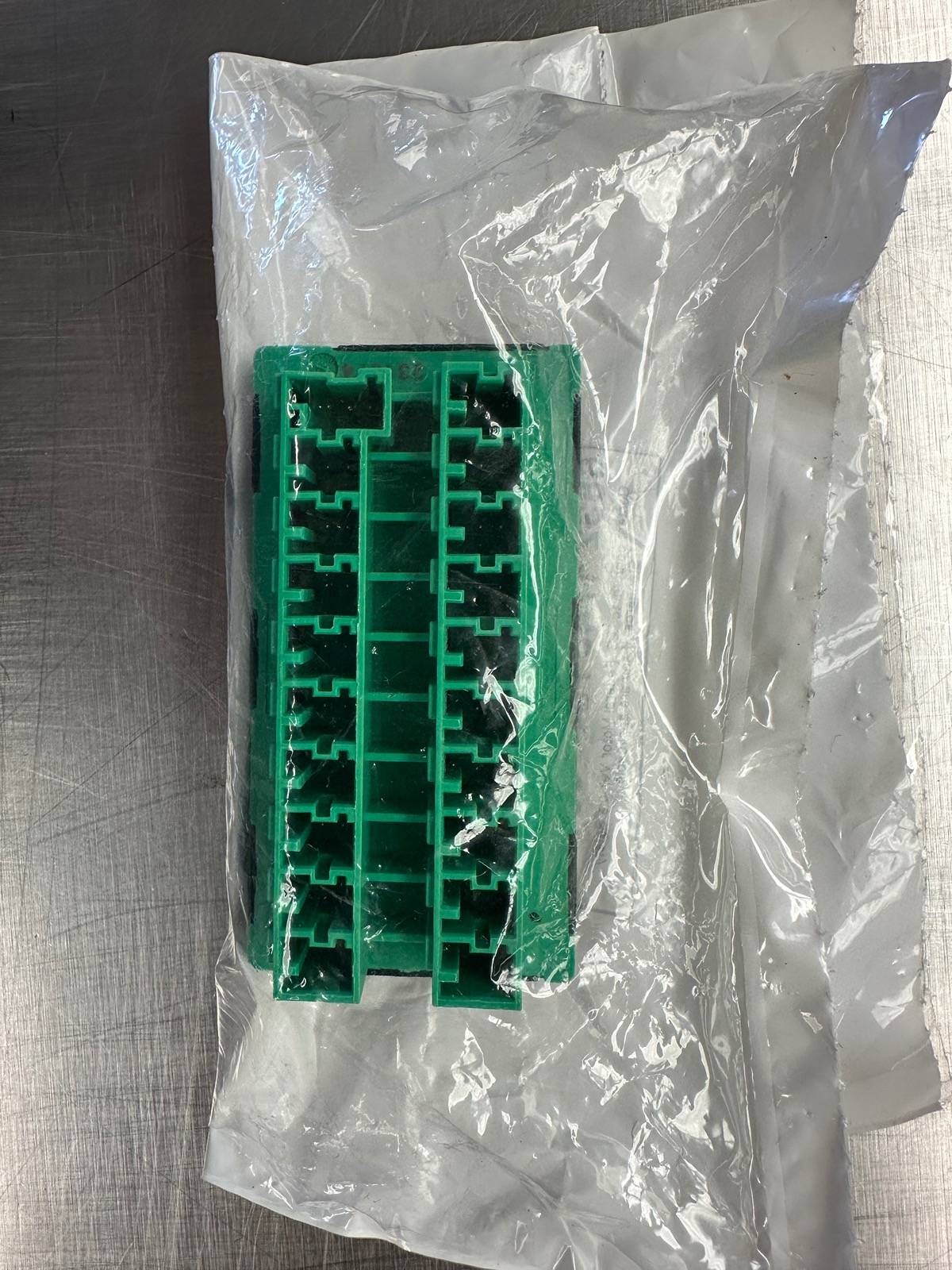

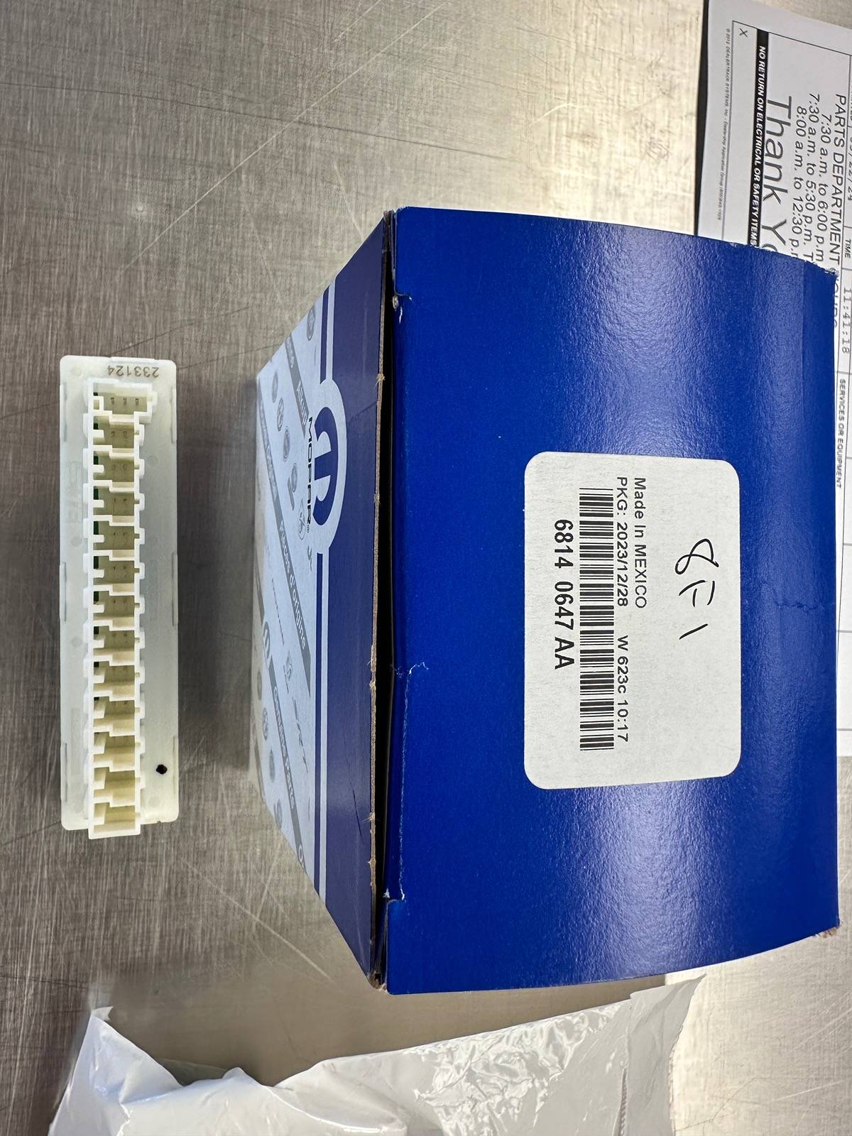

Pics of all potential options for CAN BUSS CONNECTORS
Jeep Wrangler JL Problems IMG_0437
Jeep Wrangler JL Problems IMG_0436
Jeep Wrangler JL Problems IMG_0435
Jeep Wrangler JL Problems IMG_0434
