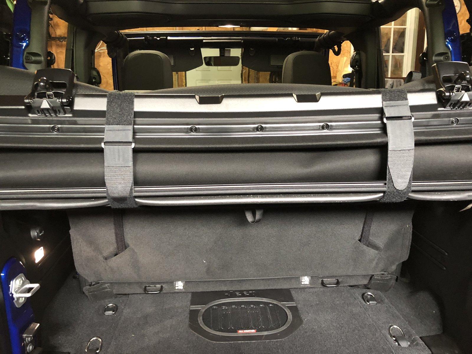

Is that the straps that came with the Jeep?Solved any future problem. Put on these Velcro straps today and there is no movement on the freeway or even while off-roading. Abrasion no more.

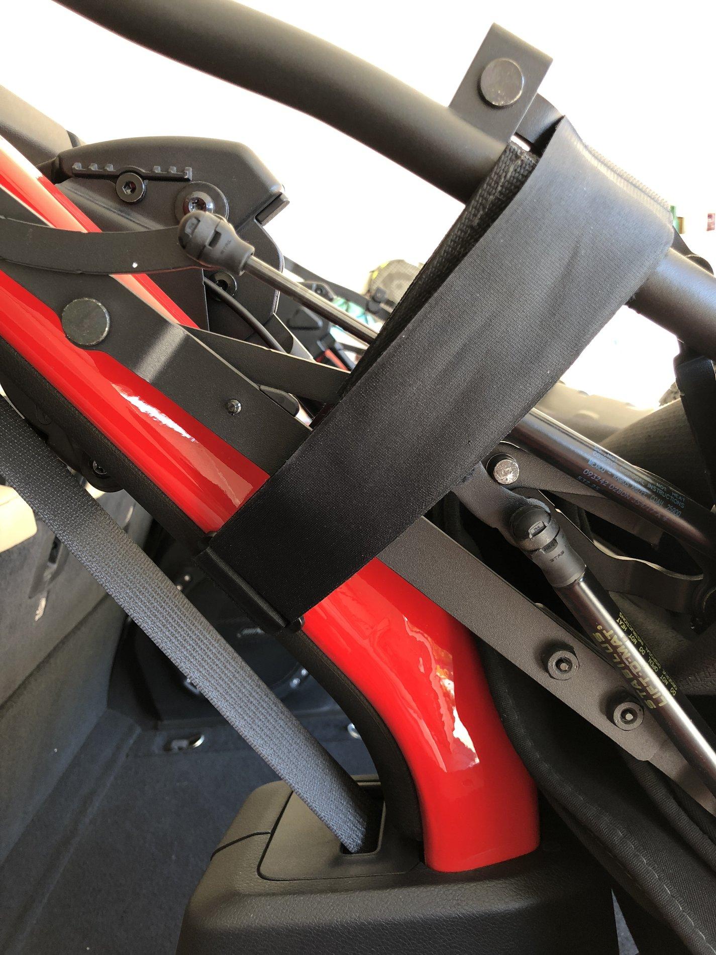

No, these are not. I do use the straps that came with the Jeep to keep it secure in sunrider mode. You can see the factory strap peeking out from under the larger one by my rollbar.Where did you buy those?

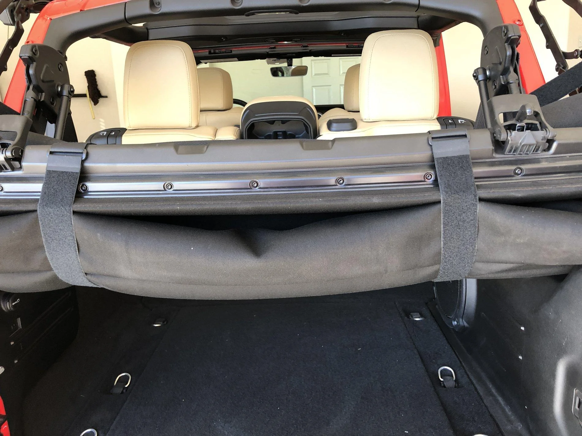

Thanks for this! I went to Home Depot and purchased these same straps. They do work great and keep the top bundled nice and tight!Solved any future problem. Put on these Velcro straps today and there is no movement on the freeway or even while off-roading. Abrasion no more.
Thanks to you I got two of the straps from Amazon too. However, I strap mine around the rear window bar with just two straps. I also release the straps when I'm not driving around just so I reduce the stress on the bar. It is aluminum so it should handle it ok anyway.Over 2000 highway miles and several trips offroad with these straps on now and there is ZERO movement and ZERO additional wear marks.

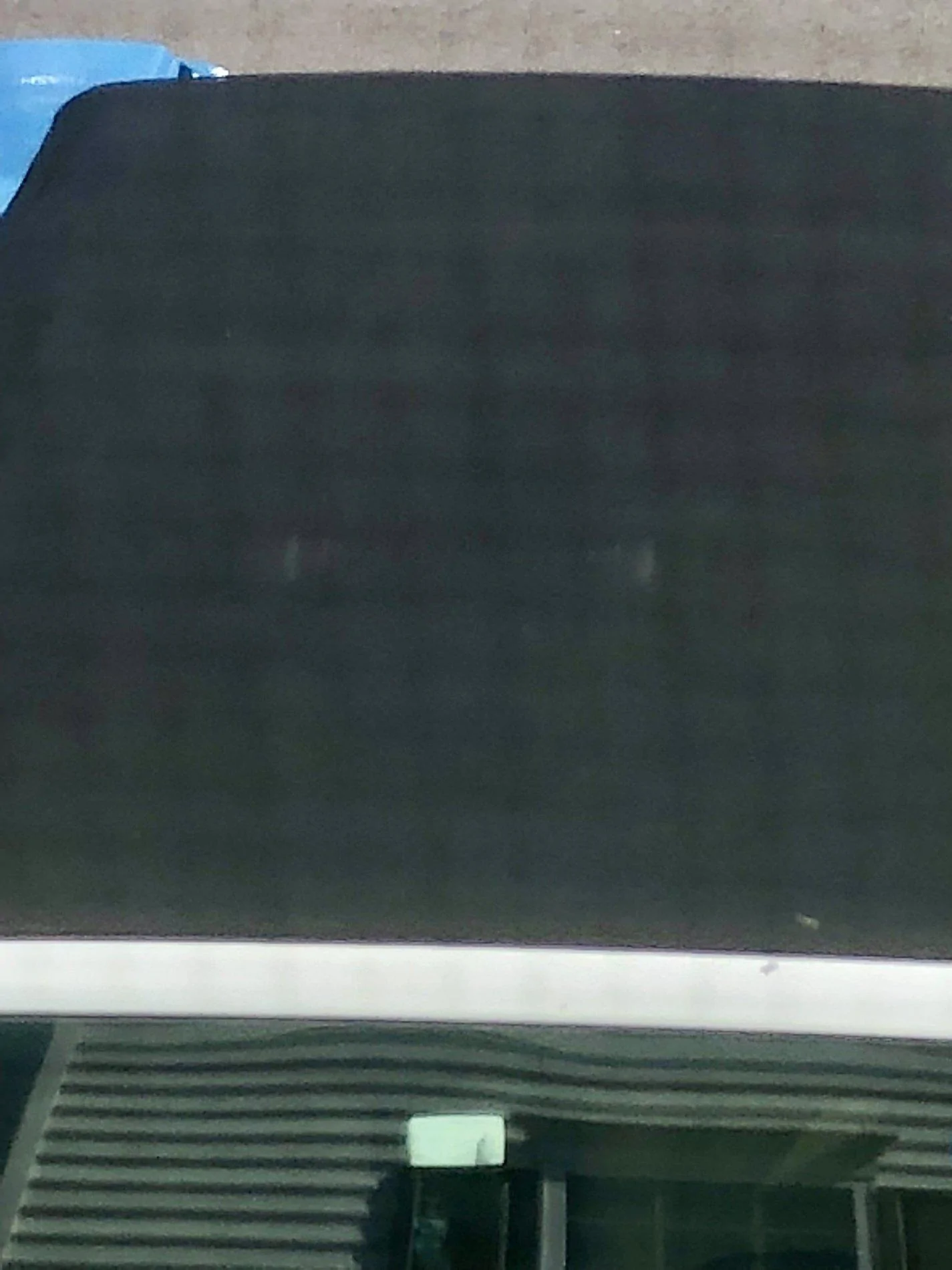

My 2012 911 did that too, right behind the drivers side windows. It bugged me, but I kept telling myself that there’s a price to pay for a top that folds down. I guess we shouldn’t be surprised to see some abrasion when cloth meets cloth in a vehicle.We have 911's that have the same issue when the top is folded. It is not really much wear, mostly visual. I've seen most tops show wear like that, slowly getting worse for 10 plus years. I wouldn't be too concerned.
