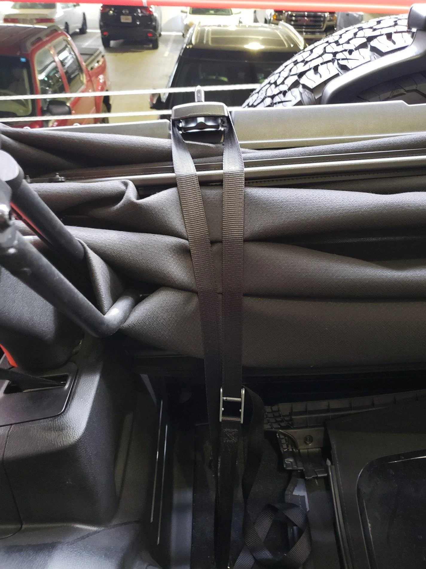

szobell
szobell
Nov 28, 2017
315
442
Utah
2018 JLUR, 2015 KL, 2009 JKUR,
  • Thread starter
  • Thread Starter
  • #14
Solved any future problem. Put on these Velcro straps today and there is no movement on the freeway or even while off-roading. Abrasion no more.
