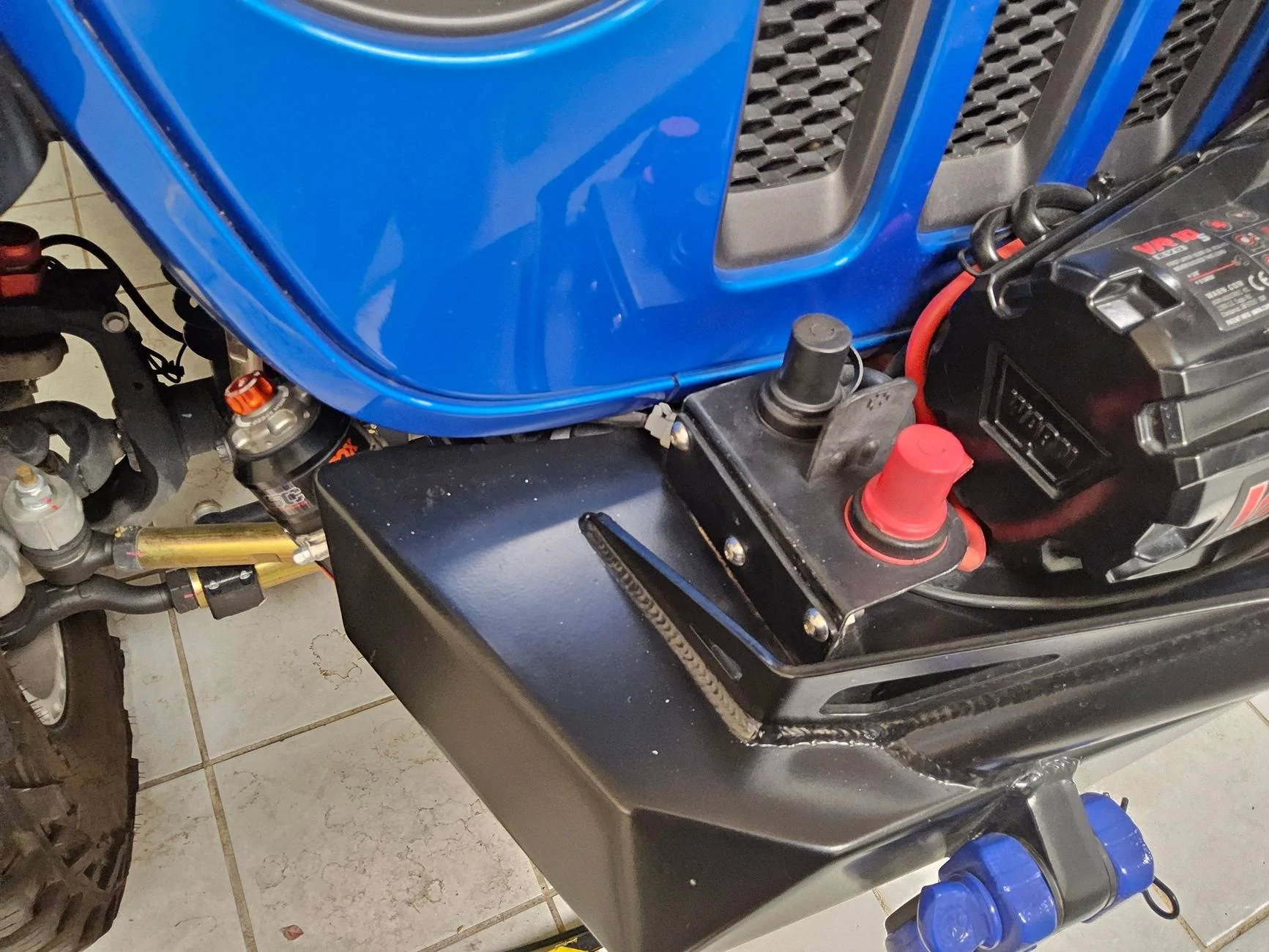

My external power connection for my ARB Twin Compressor and/or Jumper Cables. No need to raise the hood. The power point is connected to my secondary/accessory battery.
The compressor pulls almost 80 amps. And, only about 5-6 minutes total to air up from 10 pounds to 35 pounds for all 4 tires.

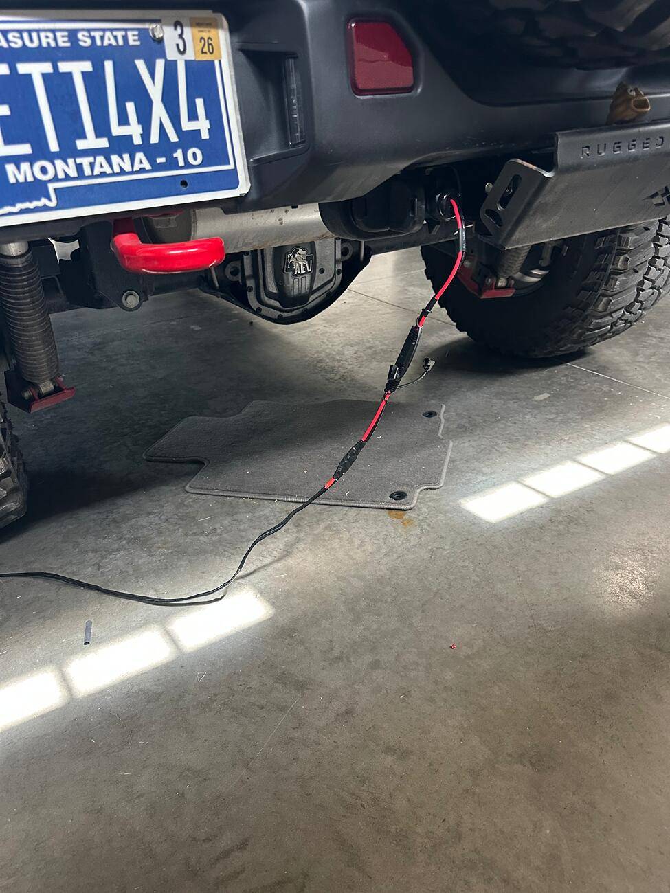

I guess i like being able to carry my Viair to different places without having my jeep there. I can run it off the 7way plug. works great so don't have to pop the hood. I do have a set of aligator clips with sae connector so I can use it hat way too.
Jeep Wrangler JL PORTABLE AIR COMRPESSOR MOUNTING IDEA {filename}
so this plugs into your alligator clips of the compressor ?

“Friends borrow

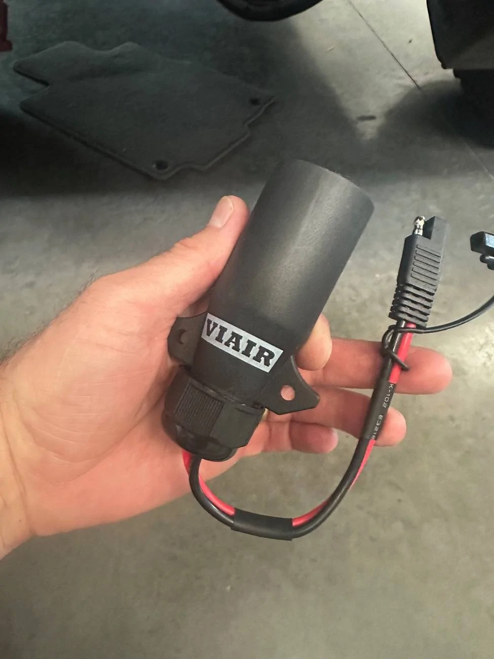

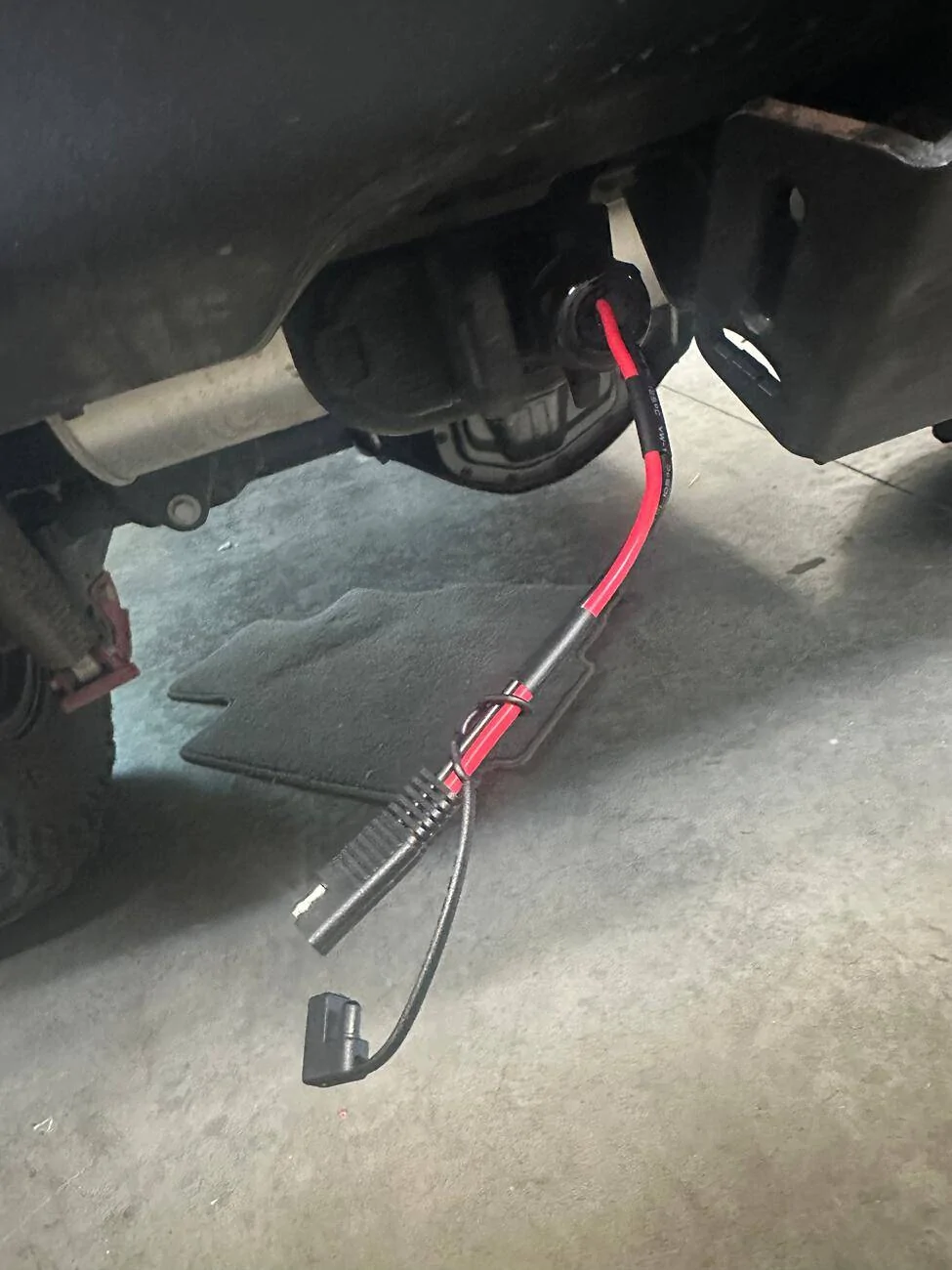

no my compressor plugs into this which plugs into the 7 pin but I also have aligator clips that plug into the compressor if I need to use it on a vehicle that does not have a 7 pin. I snipped the aligator clips off the compressor and replaced them with a sae connector
