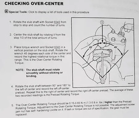

After 6500 miles, non stop frustration and $1500 in aftermarket parts I have made the decision to throw in the towel and get rid of this thing. Bottom line is that it is not safe to drive, you can massage it around and drive super careful and get where you are going, but make no mistake if you have a situation where you have to react to some other dumb driver this thing is a death trap. Had a run in with a box truck yesterday on a mountain road that sealed the deal for me. He came around a sharp right hand corner in my lane. I was going up the mountain luckily and reacted by yanking the Jeep to the right, he also moved right and missed me by about 18". Problem is once the Jeep went right I tried to ease it back to the road, the passenger side tires were on the shoulder and well below the drivers side tires and there was not enough of a response. Forced to yank the wheel I was shocked that the Jeep rebounded dead left and carried me clear across the opposite driving lane. I managed to gather it up from there and did no damage but honestly after logging 100k miles in two JK's I can positively say that both of my JK's would have handled that situation with little more than some cursing from me. Bottom line is that after a Falcon Nexus 2.2, adjustable LCA's with caster set, a yeti track bar and a new steering box this thing still stinks. The box seemed better for about 200 miles, or until the weather warmed back up over 20 degrees and now it is as bad as the original box. There is a dead spot where the wheels do not react, once you get through that spot the wheels seem to react too quickly and when you are forced to make quick adjustments, like to avoid an idiot in your lane the Jeep is completely unpredictable. I have a line on a couple of 2018 JKUR's and will be dumping this thing at a bad loss as soon as possible. To all who have the poor handling Jeeps, beware and be careful, if you are forced to take evasive action on the road these things are worse than a handful.
Chewi
Did the dealership conduct the "Over-Center" test as described in the Star case at https://www.jlwranglerforums.com/fo...has-play-and-drifts.3691/page-179#post-554123 ? They should check your old steering box and the new steering box that is now failing as well. Obviously a large amount of steering boxes are having this problem and they should keep replacing it until they find a good one.
