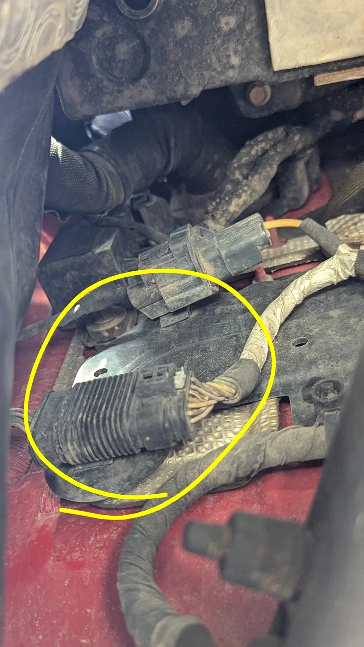

Dan, I don’t think wheel speed sensors kill power steering or black out your dash.
Dying auxiliary batteries light it up like a Christmas tree but I haven’t heard of them dropping their tantrum with a key cycle.
Turn your steering wheel far left and climb in the R/H wheel well like you’re going to inspect the auxiliary battery. Look to the left on the firewall for a large wire harness connection clipped to the firewall down in that area. Unlatch it, check the pins for moisture and then reconnect it. That connector has been cited as susceptible to poor connection causing intermittent annoyances similar to what you described. Not saying that’s the problem but others have mentioned it affected them and I believe Jeep published a TSB on that critter a few years back.
If that ain’t it, I’d check the CANBUS terminal block under the glove box. That usually throws a ton of random codes and goofy events but it’s usually not self-healing with a key cycle.
Good luck!
Is it this?
Jeep Wrangler JL Throwing All Kinds Of Codes, Errors, then Blackout! 1000035736

Battery is next, but we're trying to get the connector under the aux battery undone. The lock tab on the connector was brittle and broken. We're going to check it and hit it with WD-40.

The one spelled out in the TSB has a flip latch and was a large (28 pin or so) connector.
Pins looked perfect. Hit it with WD-40. NEW Walmart Platinum Plus is now in.
