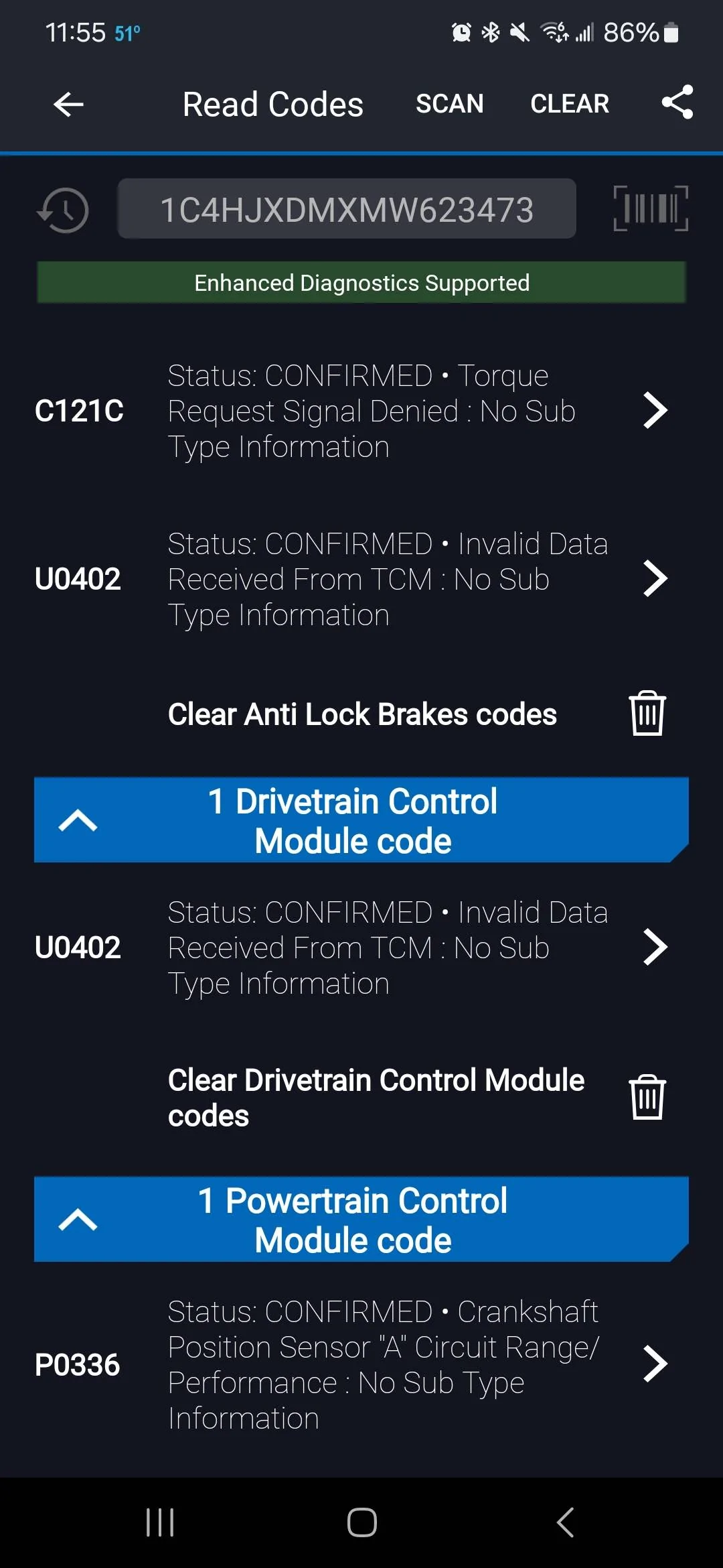

So this issue showed up again. If I clear all the codes, it barely makes it out of the driveway before it shuts off. If I don't clear it, and shut it off for a bit, a CEL remains and runs just fine. Last night I went to go to the store and the CEL was gone and is still gone. My crank-shaft position sensor just arrived but wondering if it is that or a bad TCM.

I am relatively new to Jeep but on other brands it’s known as a “cascading fault.” If you google that term it will give you some insight but - basically - it’s usually a sensor or another part trips one fault which - in turn - trips another and so on.

Correct there is only one fault here and that is the intermittent loss of signal from the crank sensor. That results in the TCM receiving by and redistributing an invalid engine RPM signal, thus setting faults in other modules. The crank isn’t variable to you might as well just swap the sensor out and cross our fingers when this one shows up.
