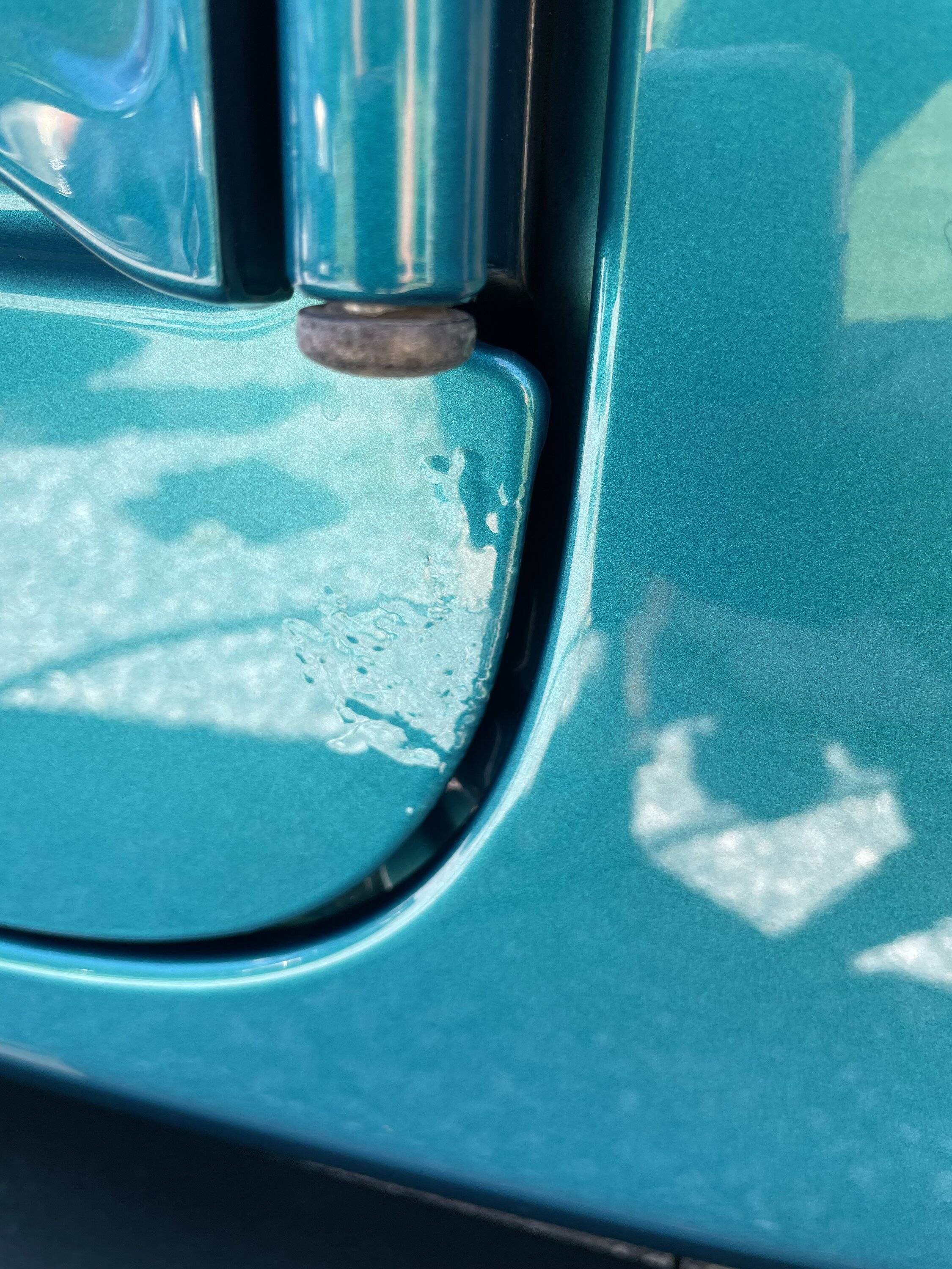

Apparently the "engineers" do not understand the dissimilar metal and battery idea. But they do know how to play video games. How ignorant can they be? Even the aluminum boat builders know not to do stuff like that. In order to fully isolate, this will require a sleeve, probably of a PVC type material, for each mounting bolt and an insulating backing plate. Any aftermarket guys reading this? It would be easy for someone to mold this stuff up and sell it, ultimately preventing more Jeeps from suffering the corrosion fate.

2018 CGM I first noticed it about a year and half ago and it has since gotten worse. I have it on all edges of the hood, around and on all hinges except the tail gate. There is also some on the bottom of all 4 doors.
My dealership’s body shop was very helpful in putting in a claim but openly told me this won’t fix the problem. It will come right back in a year or so or show up in new spots sooner or later. (Jeep only wants to cover the “repair” of the current effected spots not fix the root cause on the panels) This “fix” will push us just outside of the 5 year warranty for some of us, before it shows up again. Smh

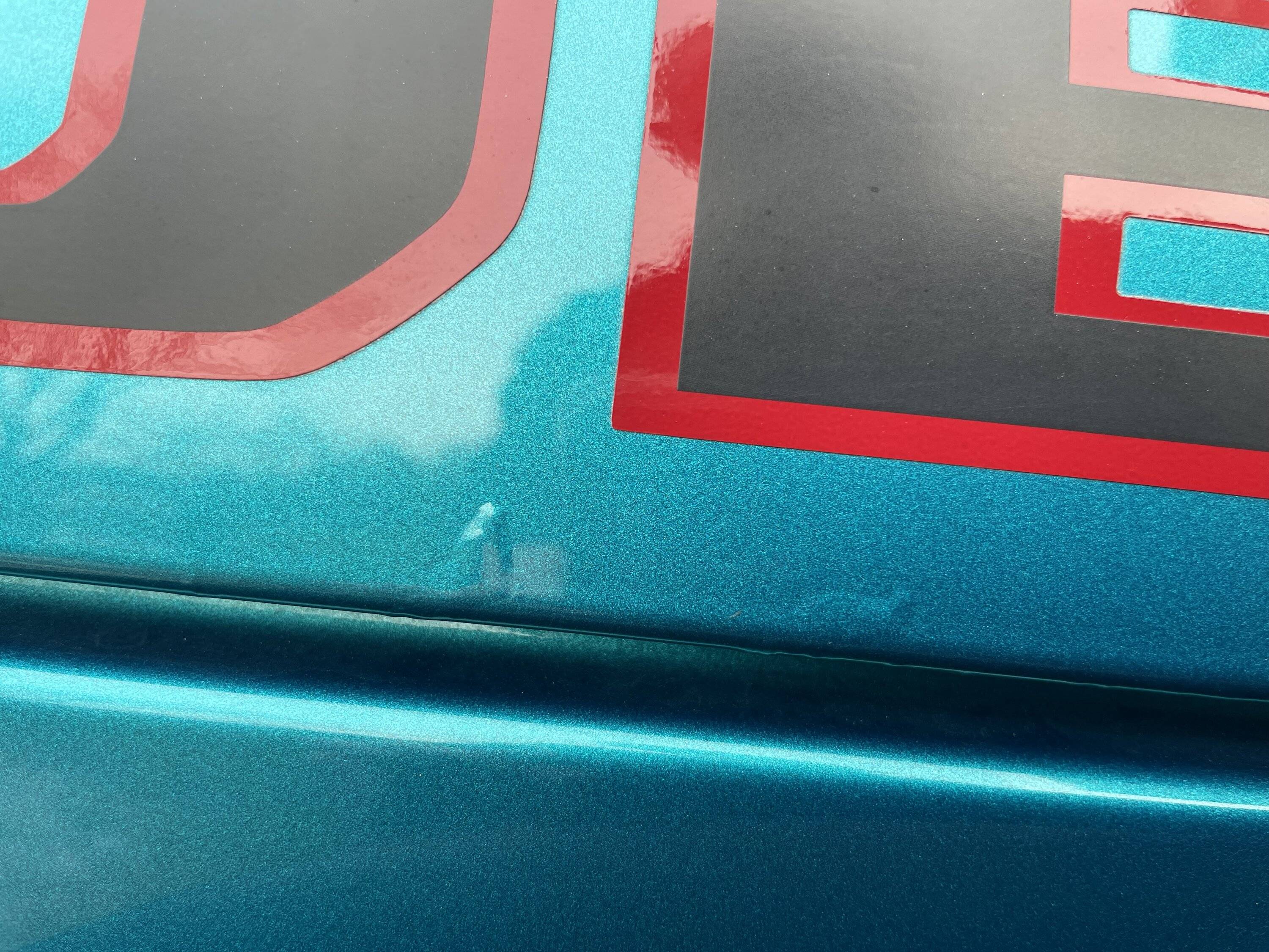

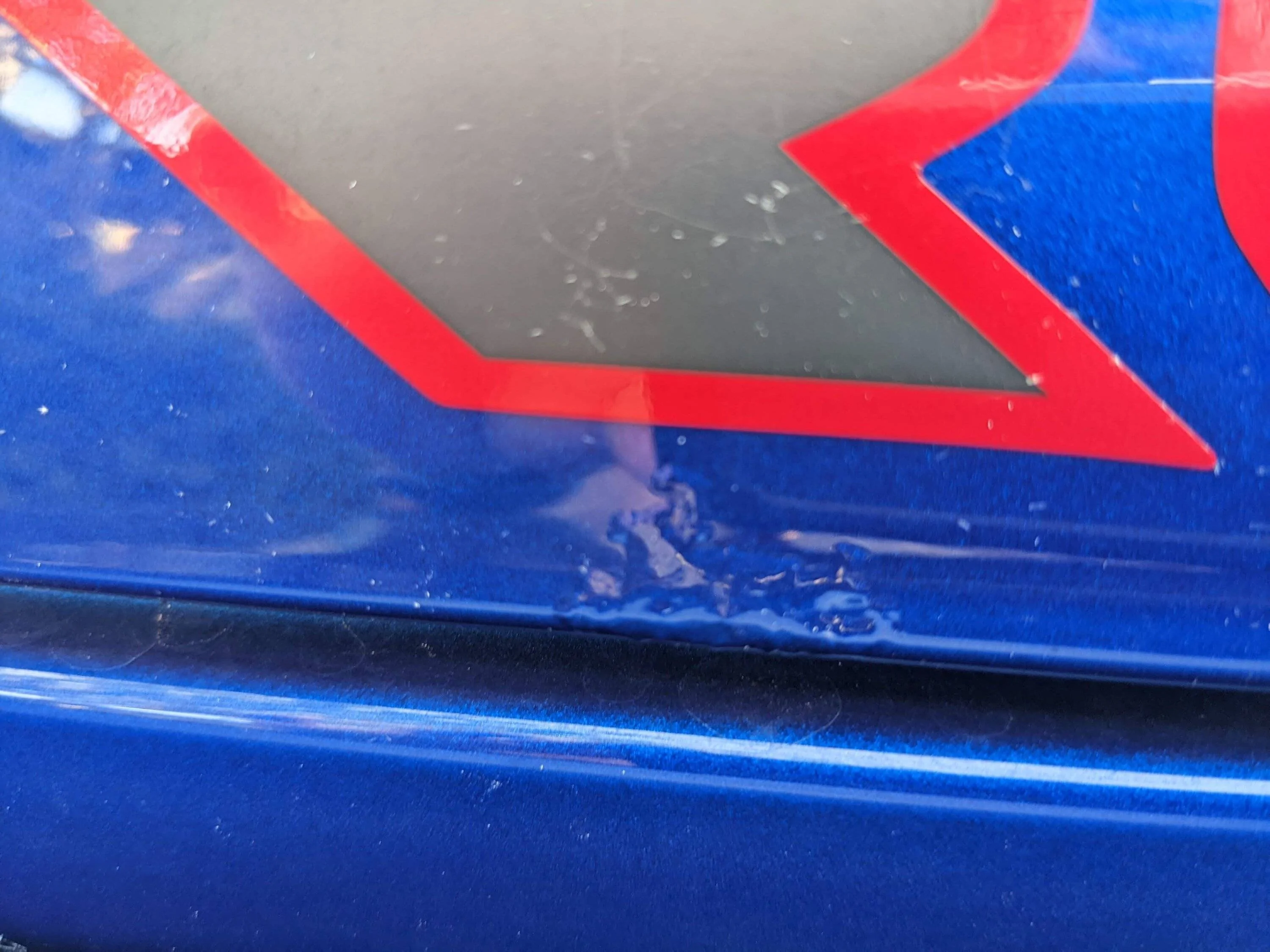

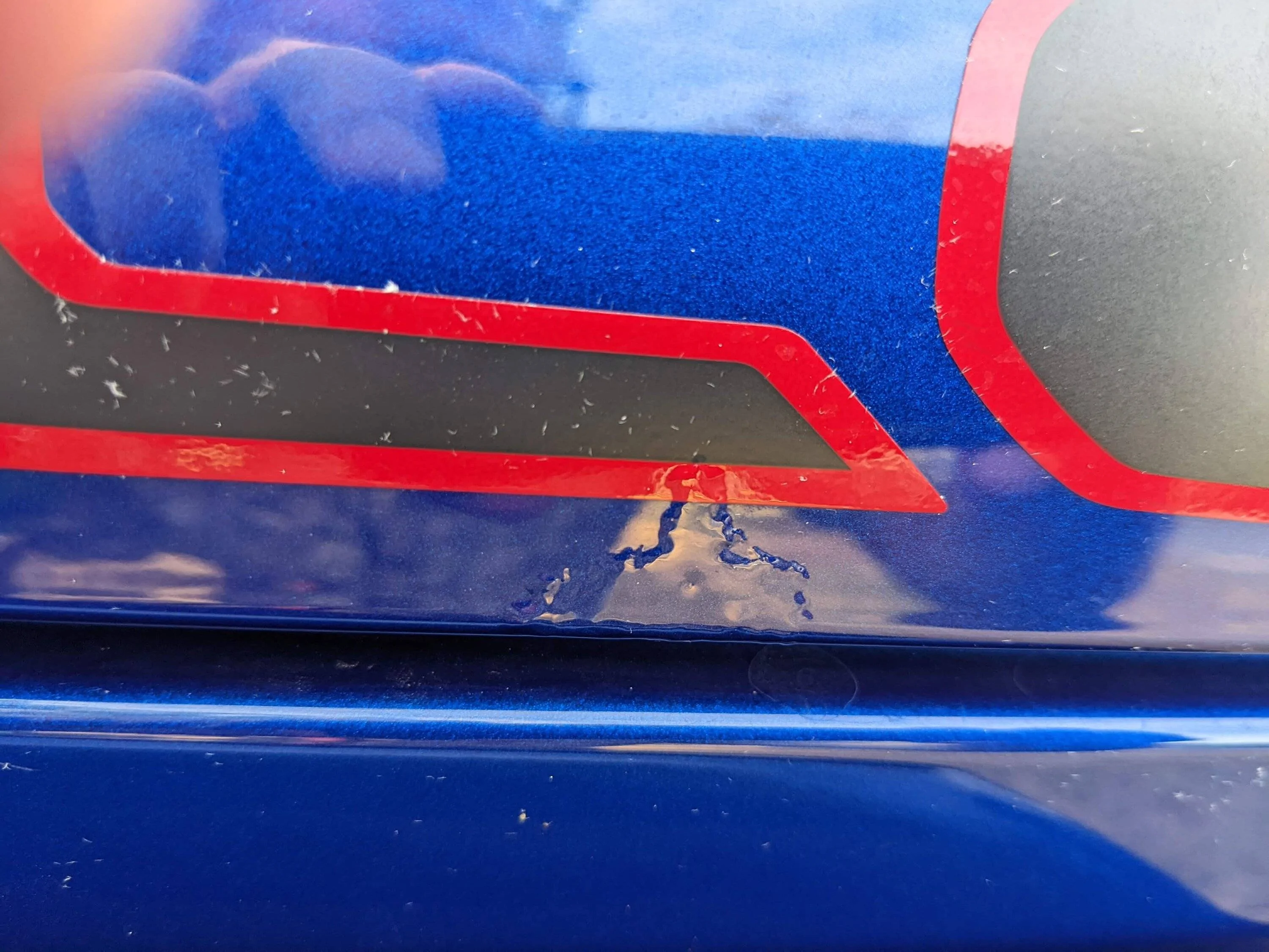

Bringing my ‘20 Rubi to a Jeep dealer with body shop this Friday. Just noticed these bubbles with only 27k miles. I have no bubbles around the hinges but this clearly shows that while there exists an opposing metal issue regarding hinges the factory did a horrendous job prepping in the paint process. Having bubbles on door and hood edges on essentially brand new vehicles is unacceptable. I am going to tell the dealer I refuse any form of spot repair and as I’ve mentioned before if this becomes too much of a hassle, I’m simply trading it in.

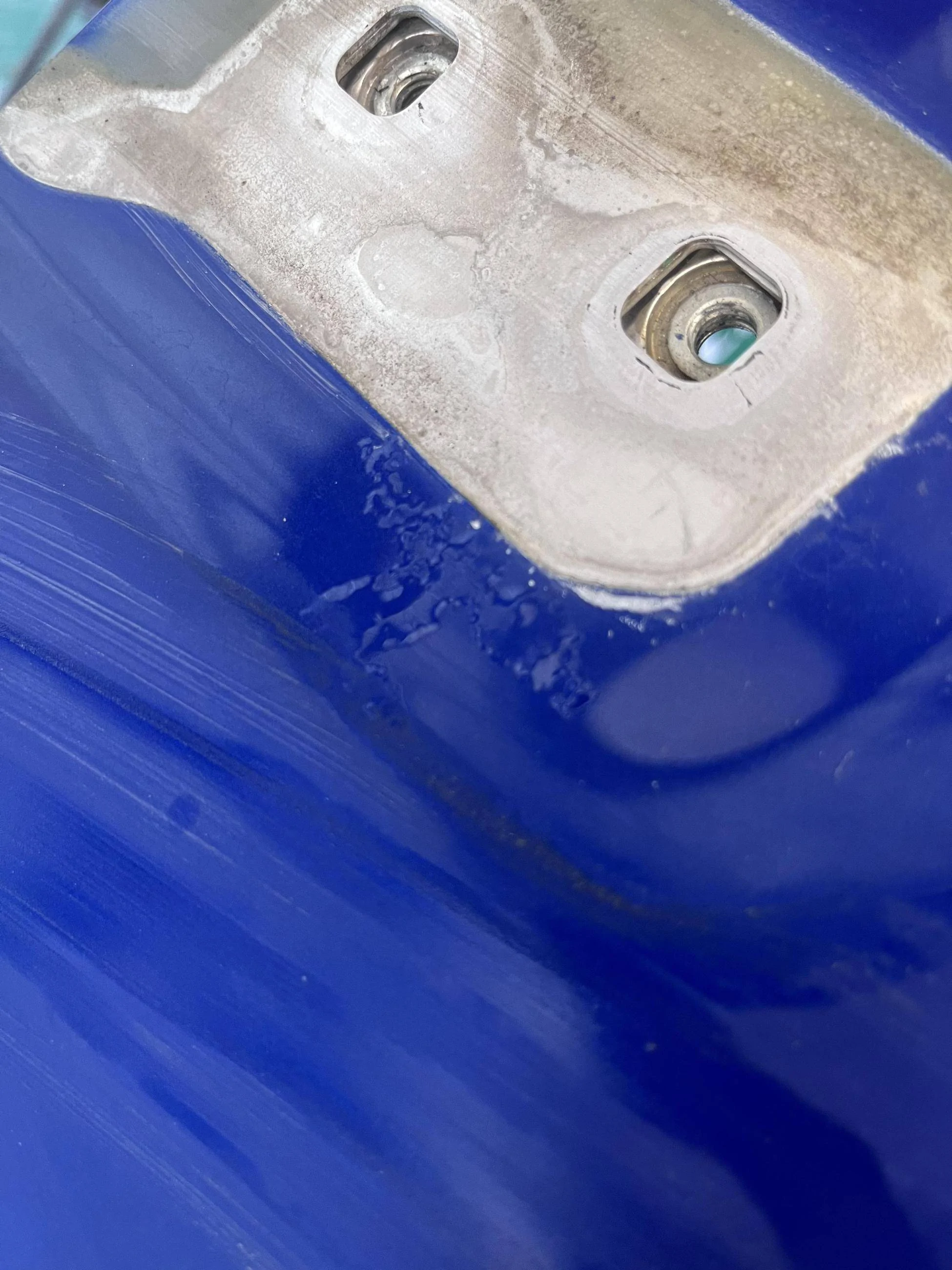

2020 JLRU with 34k miles. Just noticed bubbles on driver side edge of hood a couple of weeks ago.
Dealer said that they got approval to fix under warranty.
Took her in early Monday. Advisor thought she would be done by end of day. Tuesday he called and said won't be finished until Friday. Technician said all decals have to be removed, paint stripped, then repainted.
Friday afternoon the advisor calls and says the hood is done, but the technician found corrosion on one of the hinges and they're working on that.
I am pleasantly surprised they looked for spots that I didn't notice.
So there doing spot repair as well. Curious to see how paint matches. ??

Just over 2 years when I noticed them on the bottom edge of the drivers door.
