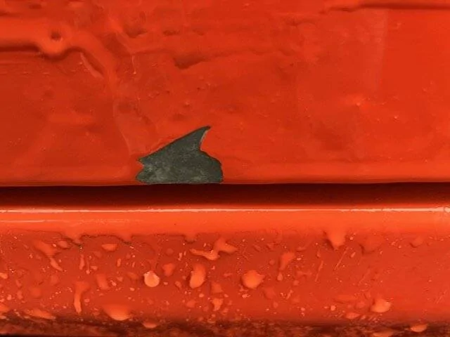

Based on panel edge blistering/bubbling I doubt it is hinges at the rot of the problem!
This is the bottom of my drivers door.

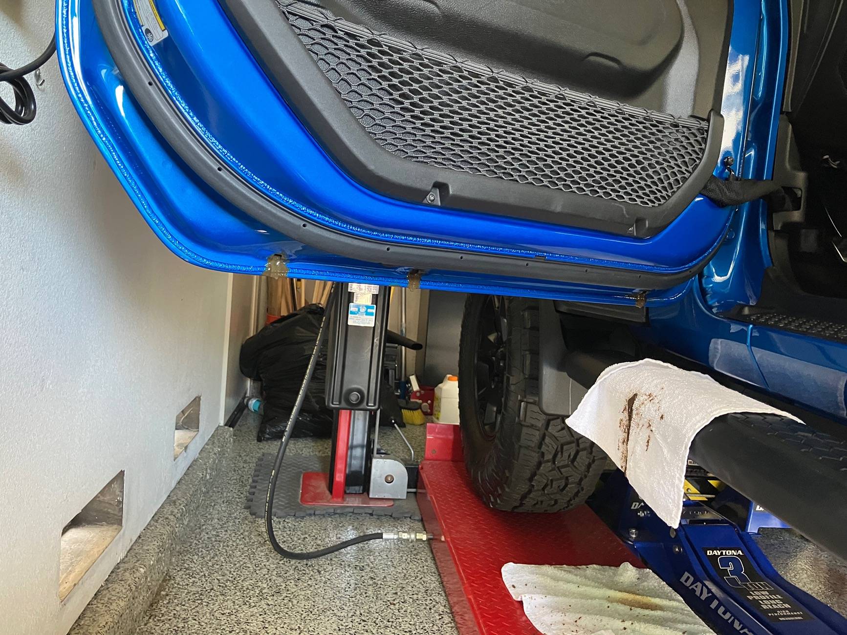

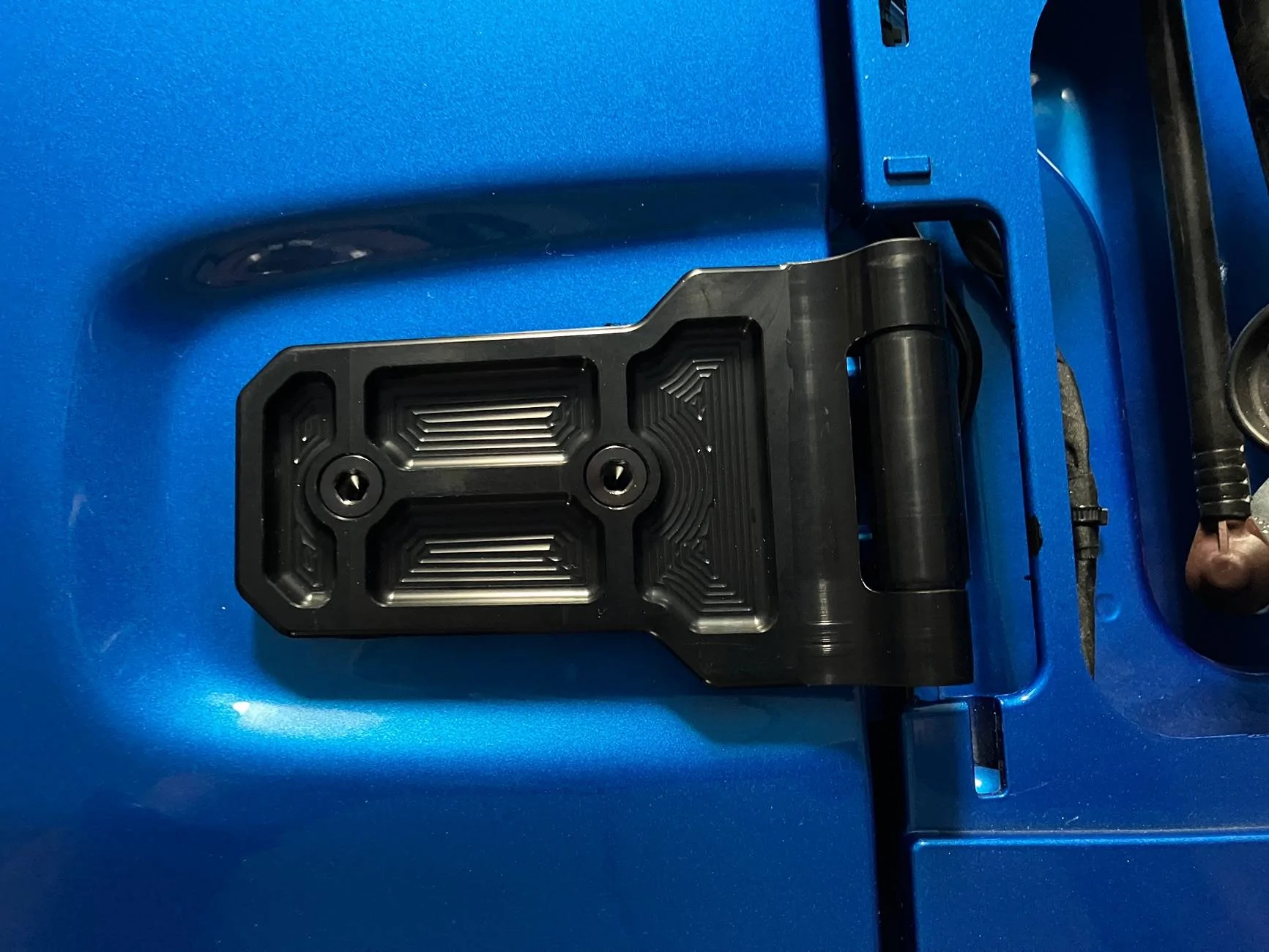

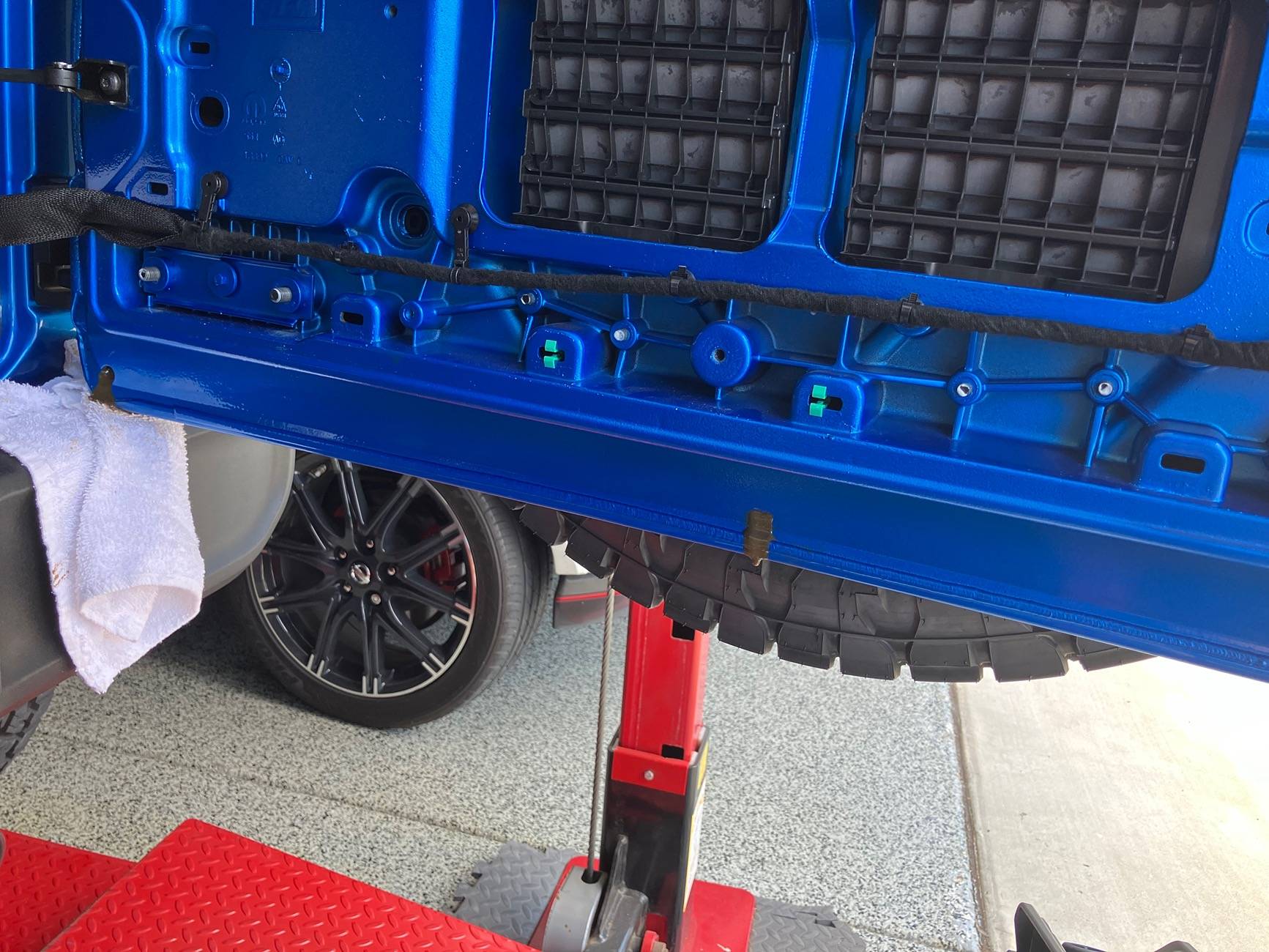

I have a 22, built august 22. No bubbles or issues yet. Replaced all the hinges, prepped and painted all raw aluminum under all hinges. Applied cavity wax to tailgate, hood and doors at the seams. I just don’t want the hassle of getting it fixed, only to have it come back because they are repairing it in correctly. Maybe I get lucky, maybe I end up having a high end shop do it correctly.

I hope it all helps. What brand of hinges did you use?
