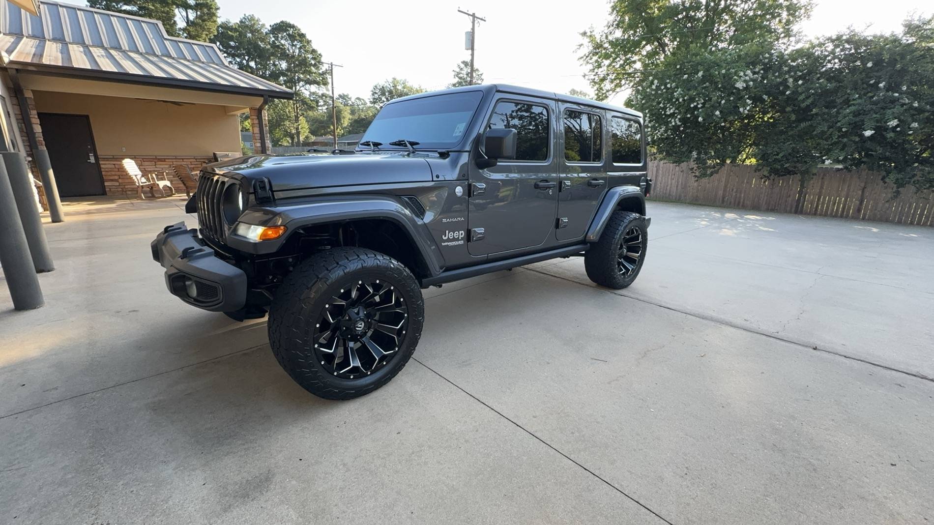

Update to my update lol. None of the doors lined up correctly. Windshield had a whistle. I brought it back and they said it may be fixed by tomorrow.
I got it back last Monday. Driver door was so out of alignment that it wouldn’t close. Not only that but found out the door was left open since that Friday. Left it again and picked it up that afternoon. Door still didn’t close right but I just said screw it I’ll do it myself. Got it aligned and all is good. Paint work looks good. Just glad to have it back. Almost 5 months without it!
I’m glad to hear they fixed it for you and it turned out ok. The fact that it took 5 months is the reason I’m probably not going to mess with it 👎🏼
