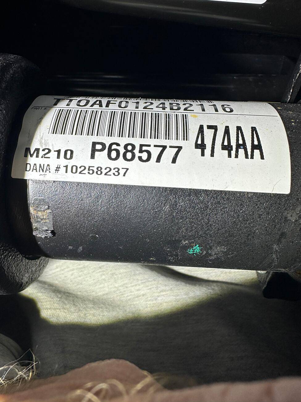

Please help identify this axle!!!

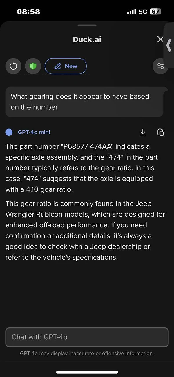

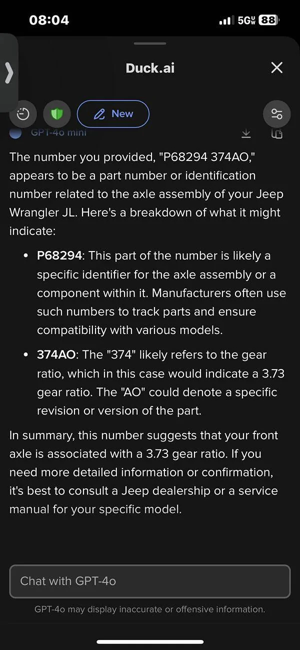

So I never use ai but figured I’d put this in just to see…with the steel knuckles, the information about it being off a 2022 jlur, the FAD delete, rotating the wheel and counting about 1.8 driveshaft turns per 1 tire rotation and now this….I’m thinking pretty confident that these are 3.73 gears…
Jeep Wrangler JL Please help identify this axle!!! IMG_1206

interesting...this what my sticker says and I have 4.10's. maybe someone else will check and see what theirs say.

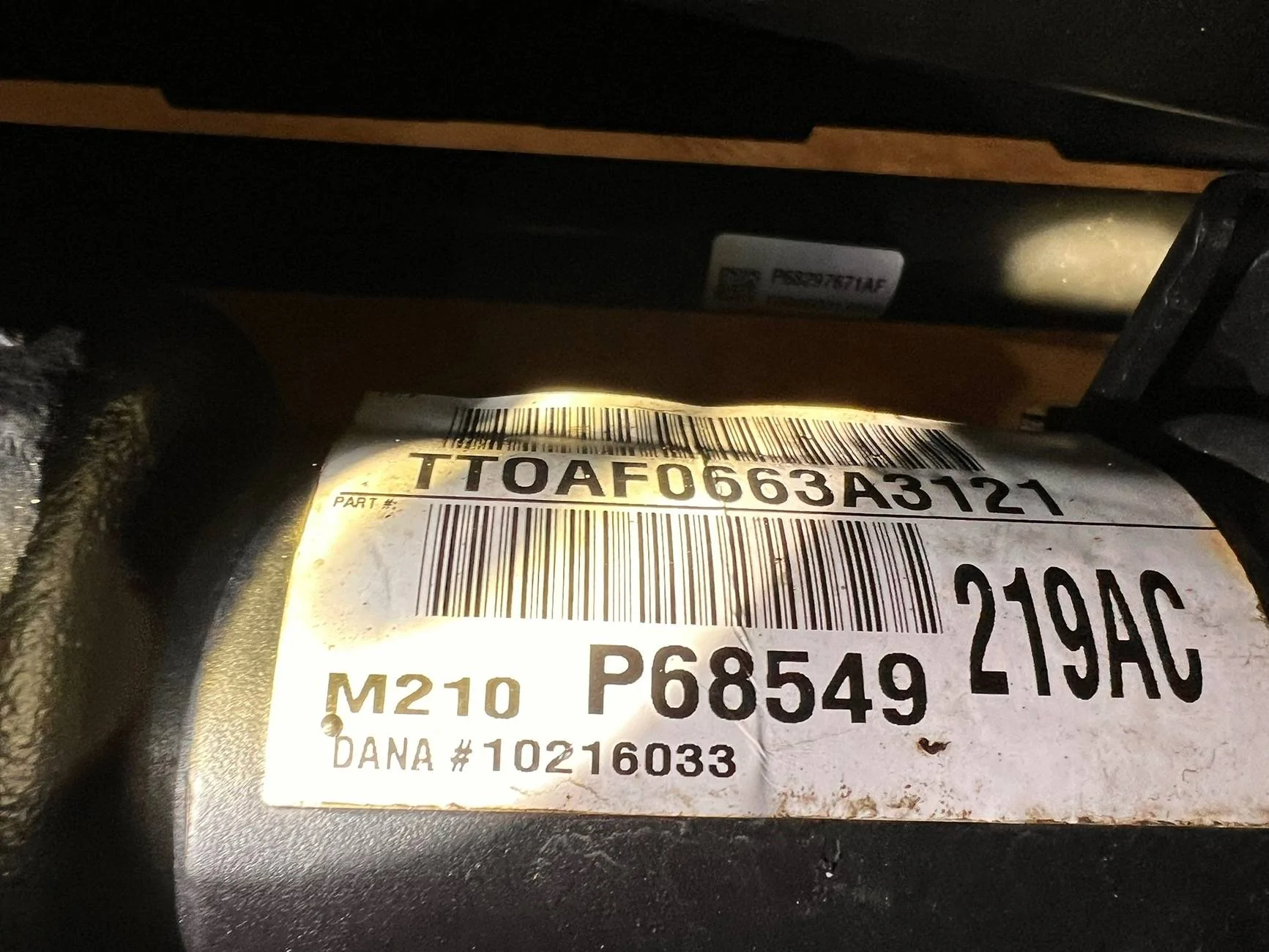

Jeep Wrangler JL Please help identify this axle!!! tempImagegGbaOs

23' high tide XR 4.56 ratio Steel spindles
Jeep Wrangler JL Please help identify this axle!!! axl

I believe the tags you guys are showing are shipping labels put on DANA prior to shipping. That doesn't look like MOPAR part number.

The 5-digit number after the P plus the 3 larger digits and the 2-letter code is a Mopar number.
👍 True. But when I ran the numbers on one of the online sellers, no joy.

I find the OP's axle online at a lot of the mopar stores, but not with the AO code on the end (highest I found was AM). None of the stores say much about it other than "front axle assembly" and "locking differential". They don't identify what it fits or the gear ratio or anything.

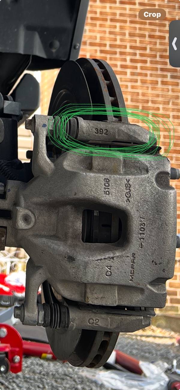

I think this has been pretty much figured out (sans pulling the diff cover but figured I’d share more evidence of why I’m pretty sure it’s a 392
When I was changing shocks the other day I took a picture of the rear brake caliper. I’m guessing they wouldn’t stamp “392” on anything other than a 392 yeah?
