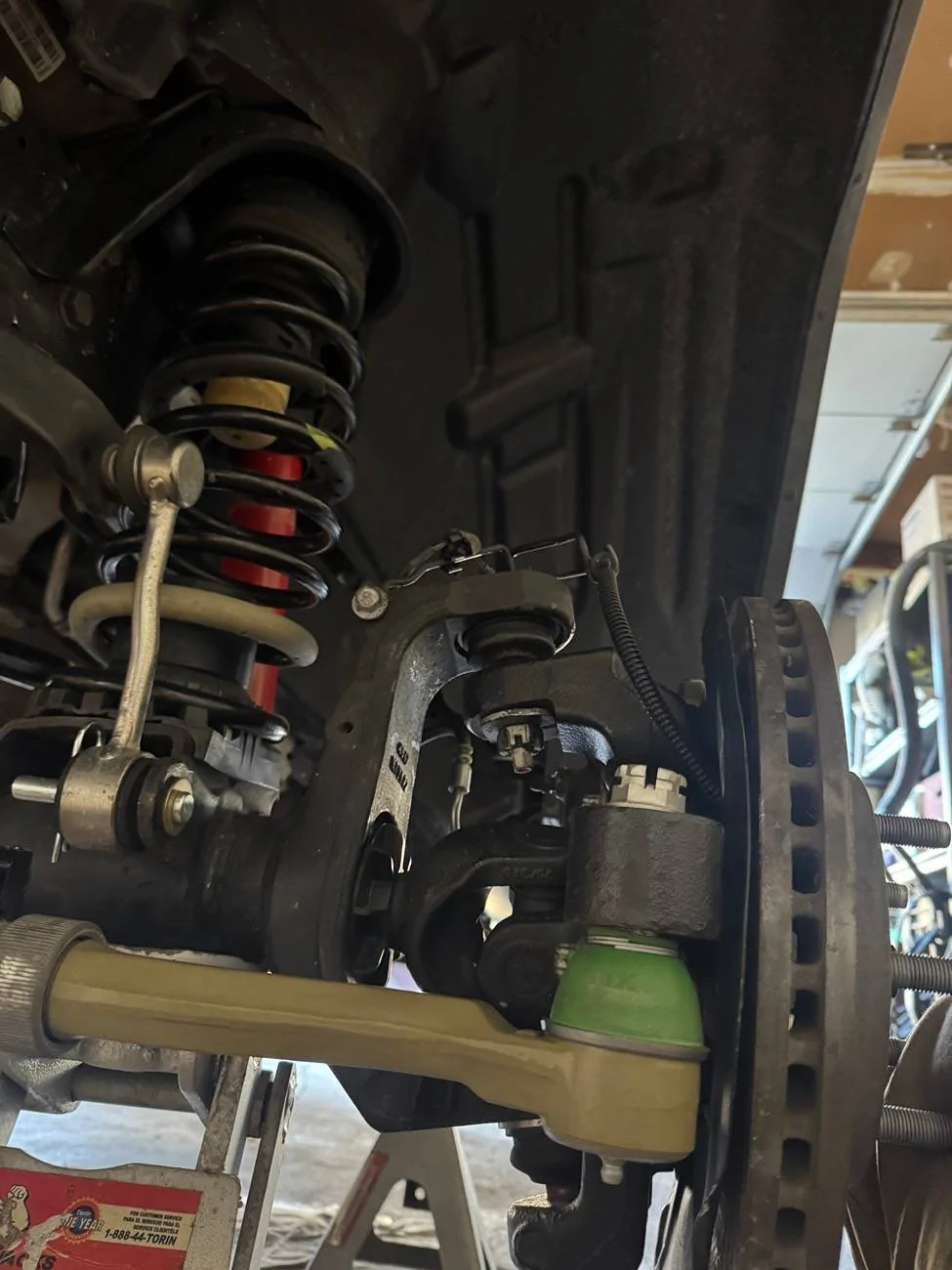

I was told this came off a 2022 JLUR however it has steel knuckles and what looks like a factory FAD delete?
Please help!

does it have CV axle shafts or ujoints? maybe the2022 392's had fad delete and steel knuckles?

not CV's which would have made it a 2024 or newer. I bet someone with a 392 can tell you if they had fad deletes and steel knuckles.

I think only the xrs got steel knuckles which means I'd jump all over it if you're looking for a front axle upgrade. Even if you want to keep your FAD you can move it to the new axle.

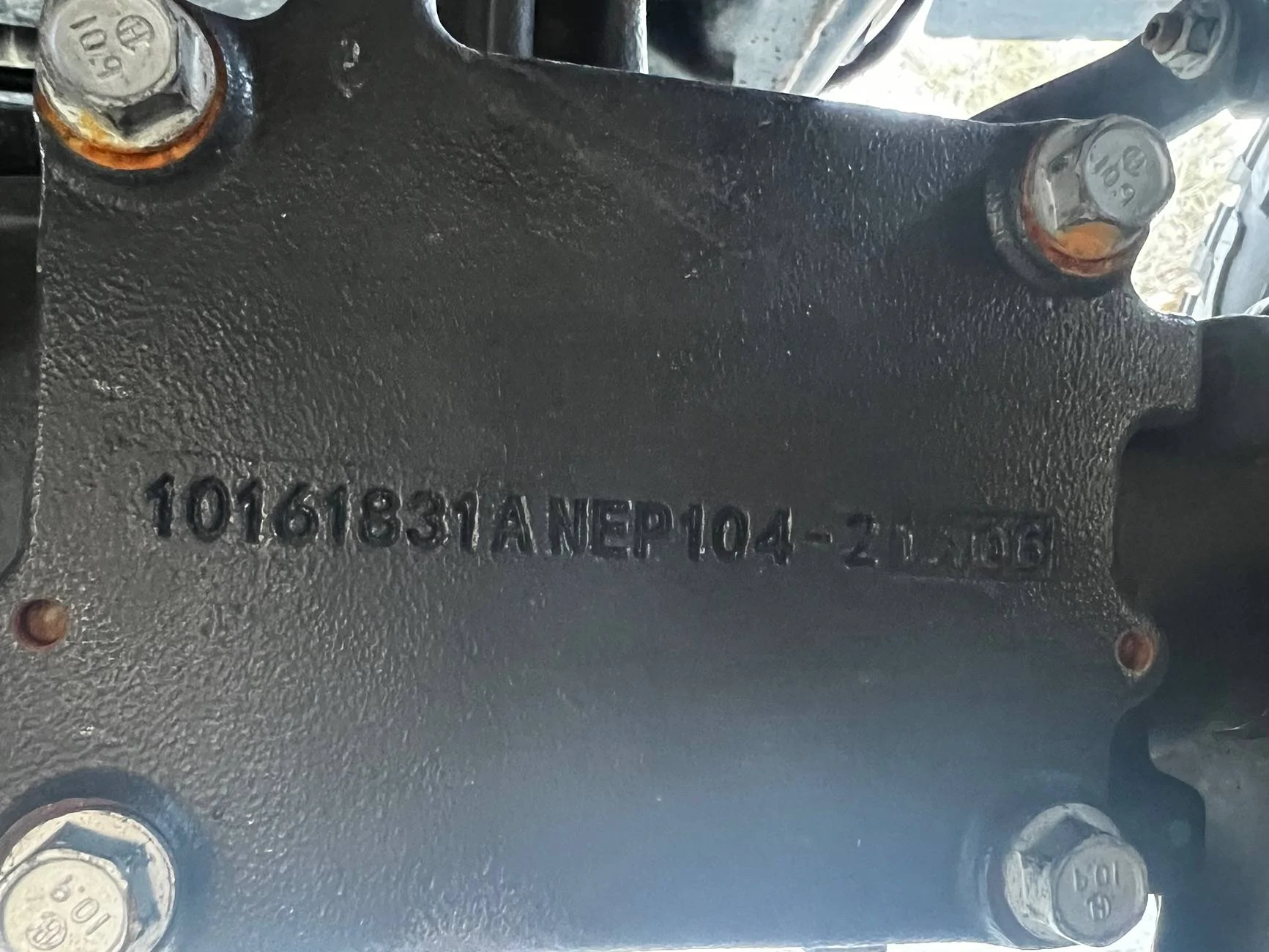

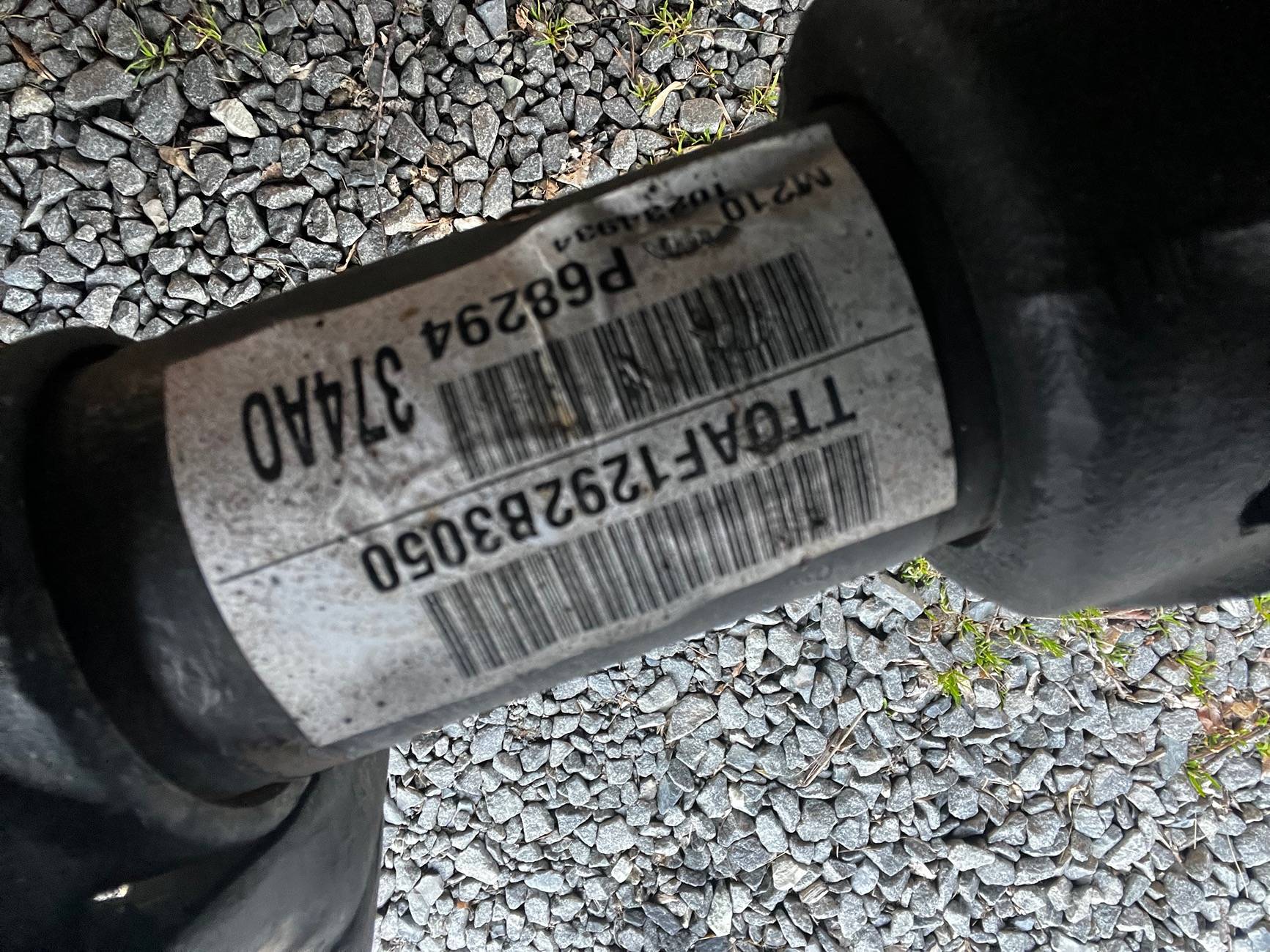

Well the problem is I did jump all over it lol…I already bought and installed this axle and the rear however I want to make sure my gearing is correct….the guy told me they are 4.10s then ghosted me after I purchased them…so I have zero knowledge about what they came off other than what he said but the story doesn’t add up. The rear brakes also say “392” on them but it’s still not clear. I geared if for 4:10’s with Jscan but it seems worse than my stock 3.45’s with 35’s so I’m wondering if I have the computer programmed for the wrong gears.
That’s why I posted the stickers…I think it should be identifiable through those right?

Steel knuckles to me say xr, which means 4.56 gears. 392s were either 3.73 for non-xr or 4.56 for xr models.

pull the diff cover and count the gears...you can also jack up the back and turn the rear tire while have someone count the rotations of the driveshaft...to be most accurate spin the tire say 10 times and count the rotations of the drive shaft...if it has 4.10's the drive shaft will have rotated 410 times...if 373 times 3.73's etc.....

We did jack it up and spin it seemed like 2 tire rotations gave us about the 4.10.

I did the 392 axle swap and suspected I had 3:73 gears. You can pop the cover and count gears but I just spun the driveshaft and counted how many times it spins to one tire rotation. if its about 3 and 3/4 turns then your 3:73. if its closer to 4 then 4:10 etc. I programmed in 3:73 gears and my tire size and am within 1mph or so on the speedometer so thinking that was close enough
