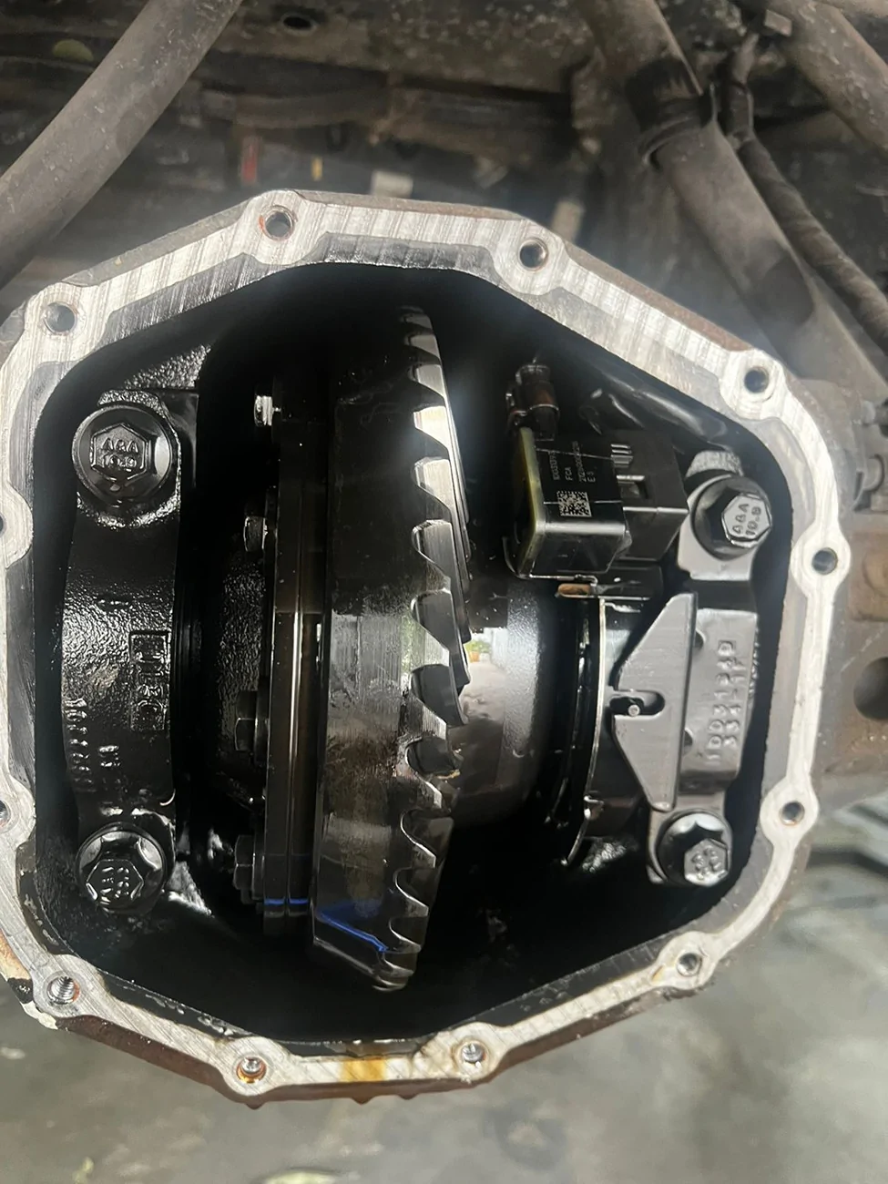

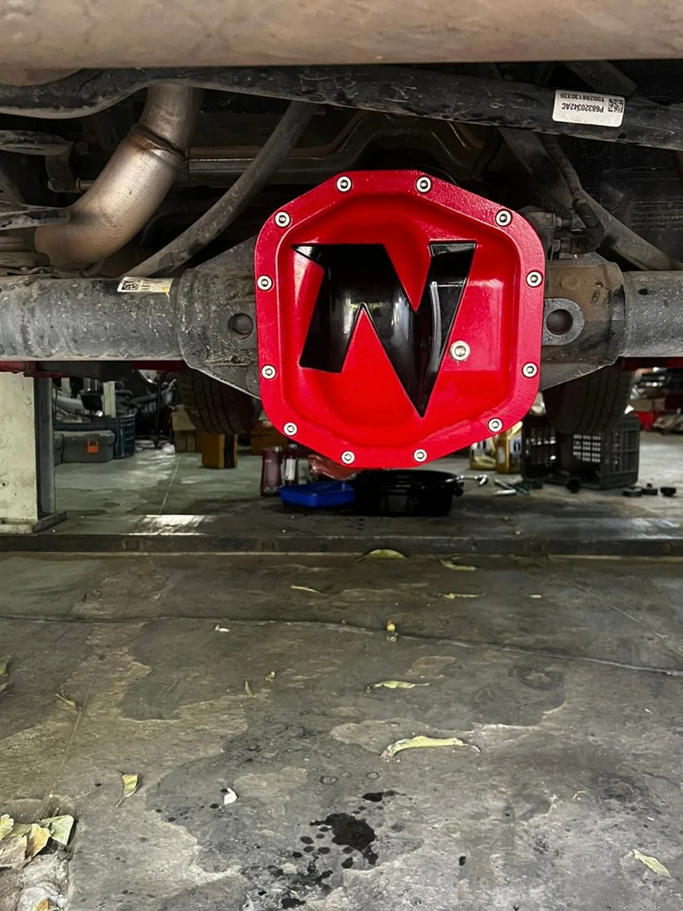

My buddy finally did the rear diff and sensor. The OEM sensor did not have oil in it but some metal shavings near the magnet.
The Nitro diff cover fit well. Posting a pic of what the diff looks like on the inside.
Also he said that it does have a drain hole which I had read the newer Jeeps did not have???
The front he said does not have the drain hole.
