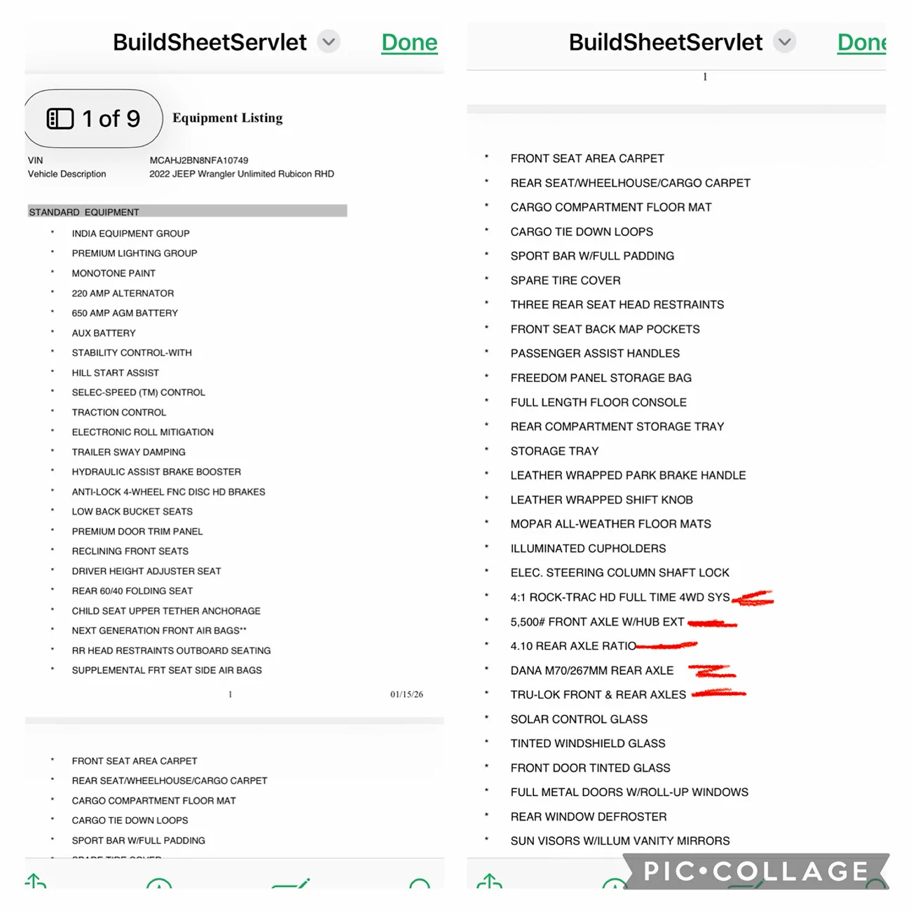

So new to me jeep in a Rubcion RHD 2022. I was about to order rear diff covers for it. I just checked the VIN sheet and it shows me
Rear DANA M70/267mm
Front 5500# w/hub extension
Tru-Lok
So my question is would the DANA 44 M220 diff covers from ARB/AFE/Curries etc fit onto my vehicle?

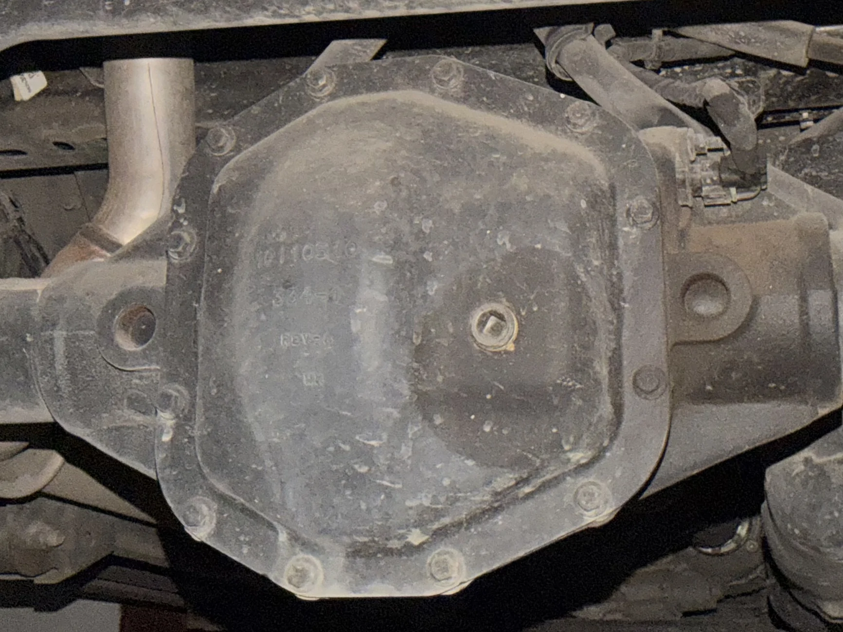

Jeep Wrangler JL Help in identifying diff/axle IMG_2636
Attaching the picture of my diff. Weird is that it looks like the DANA 44 M220!! My VIN says Dana 70.
So Im confused.
Can someone measure the distance between the bolts for me so I can verify it.

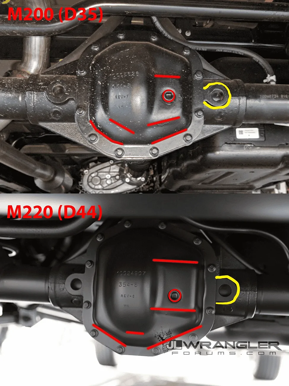

Jeep Wrangler JL Help in identifying diff/axle IMG_0050

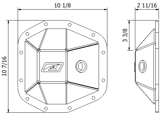

Motobilt rear diff cover for M220

Do you have a Dana M70 267mm? Do you have right hand drive? If you post a pic showing the overall measurements and bolt spacing measurements of your diff cover I am willing to compare them to my M220 sometime this weekend.

My VIN says I have a DANA 70 but when I look at it and the picture you posted I dont see any difference. Yes I have the RHD in India.
I will take measurements tomorrow and hopefully solve this mystery so I can order my diff covers.

Can you post a screenshot or picture of where you are seeing it is a Dana 70?

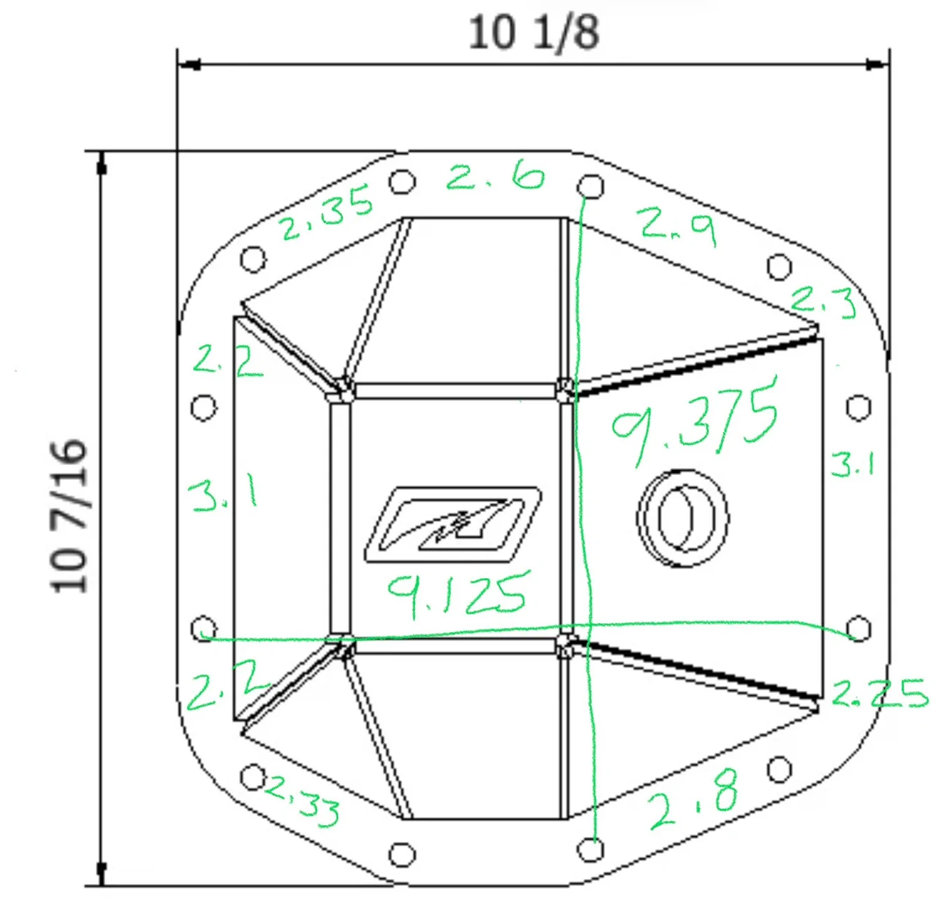

Ok, Iā€˜m barely a carpenter, so this is my best effort at the crayon user level. All measurements are approximations from center of allen bolt head to center of bolt head.. The width and height are from a kluged together trammel. Height between the center of top and bottom bolt heads is approximately 9.375ā€. Width from center of bolt heads is approximately 9.125ā€. My diff skid doesnā€˜t allow an accurate measurement between the bottom two holes.
