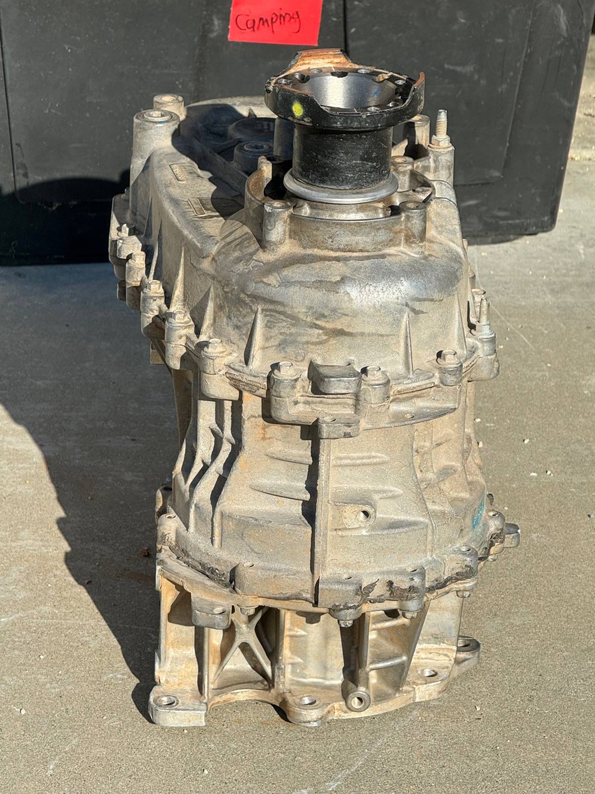

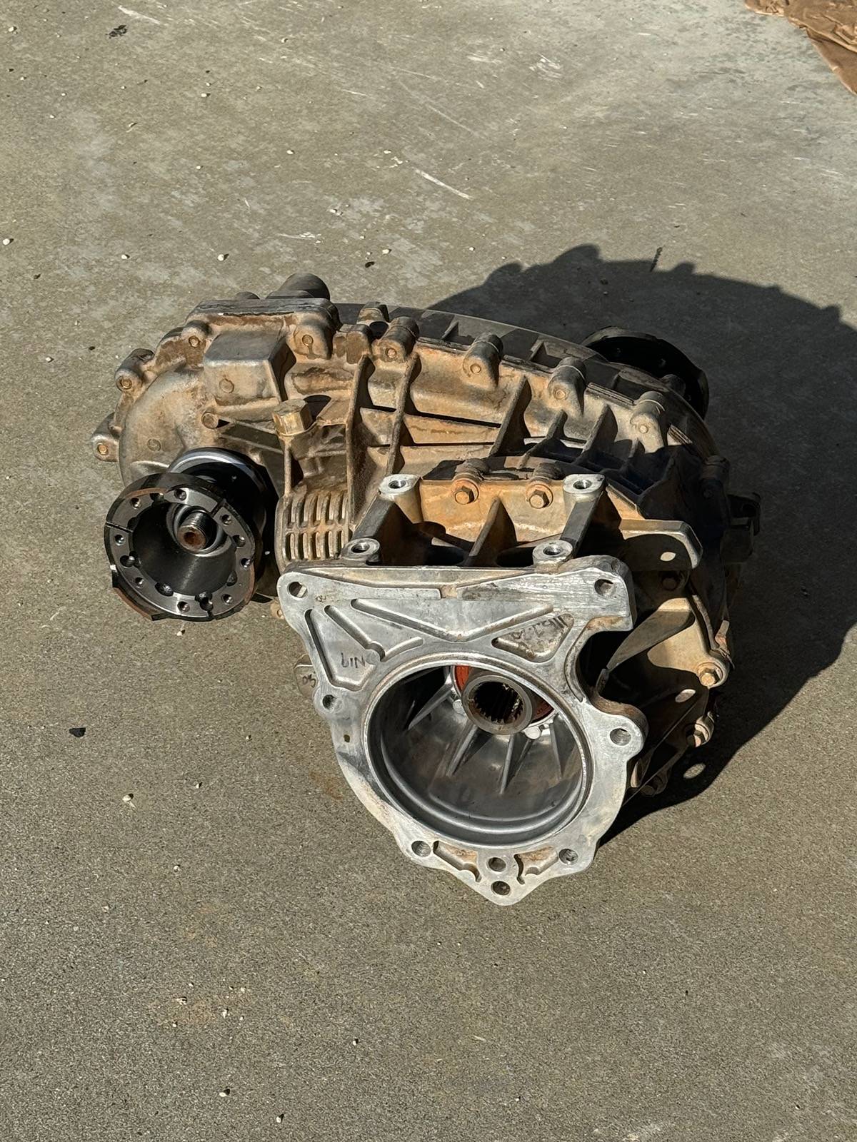

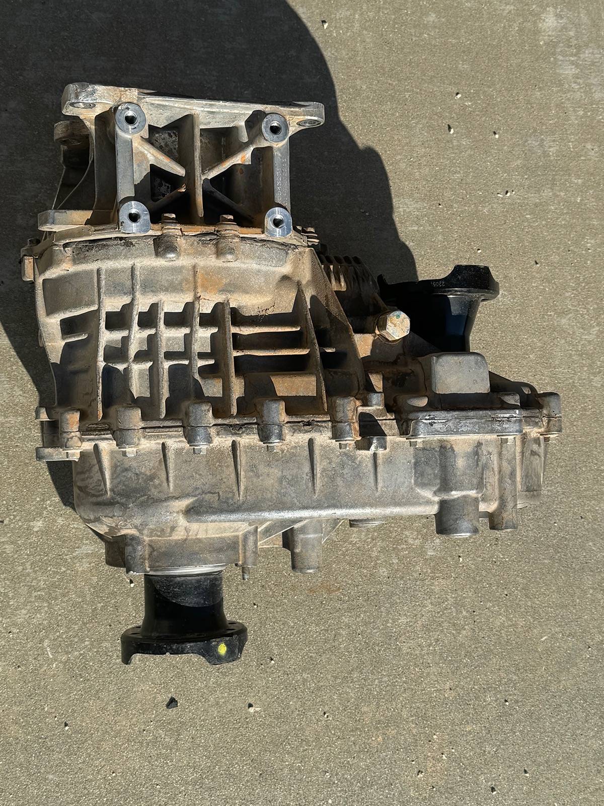

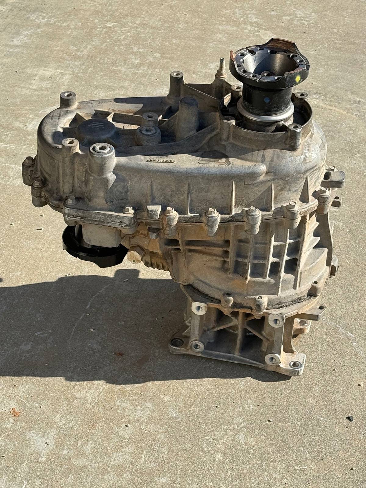

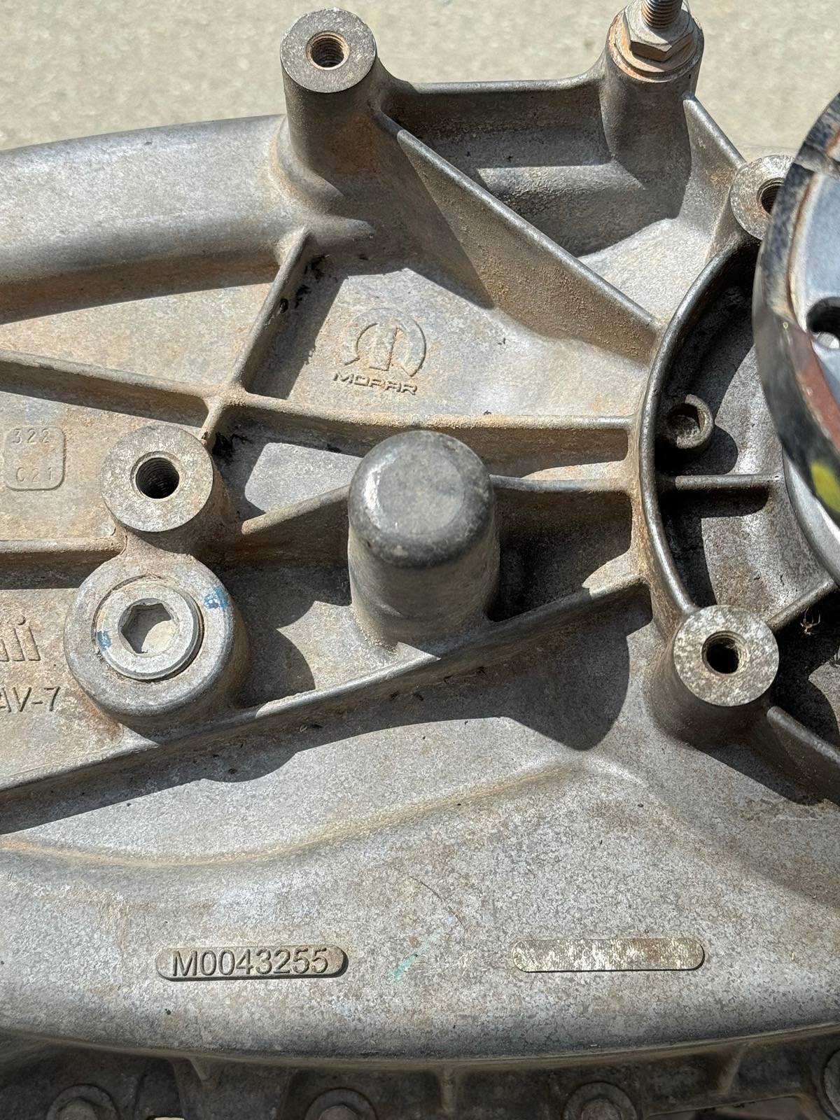

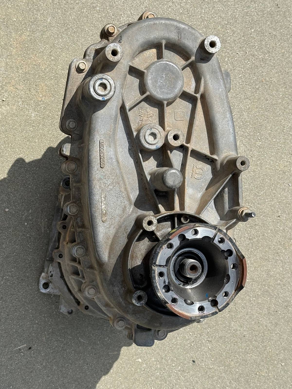

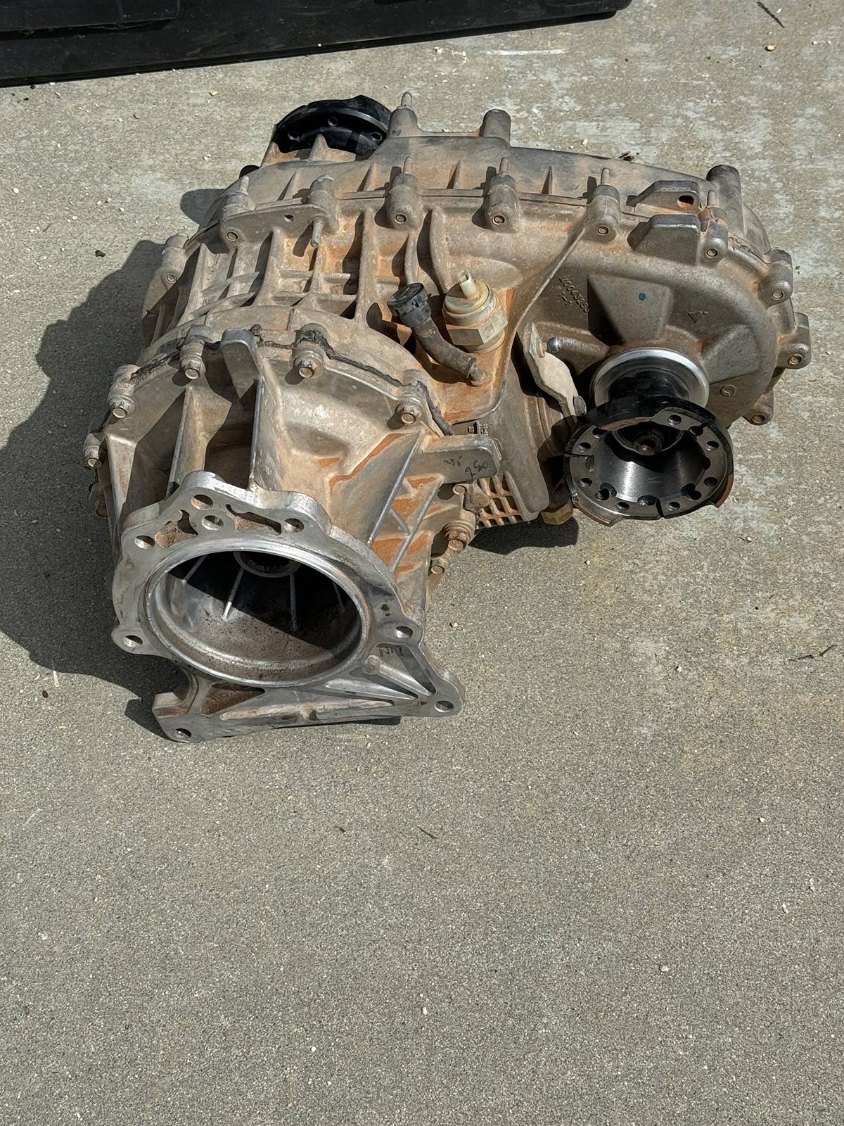

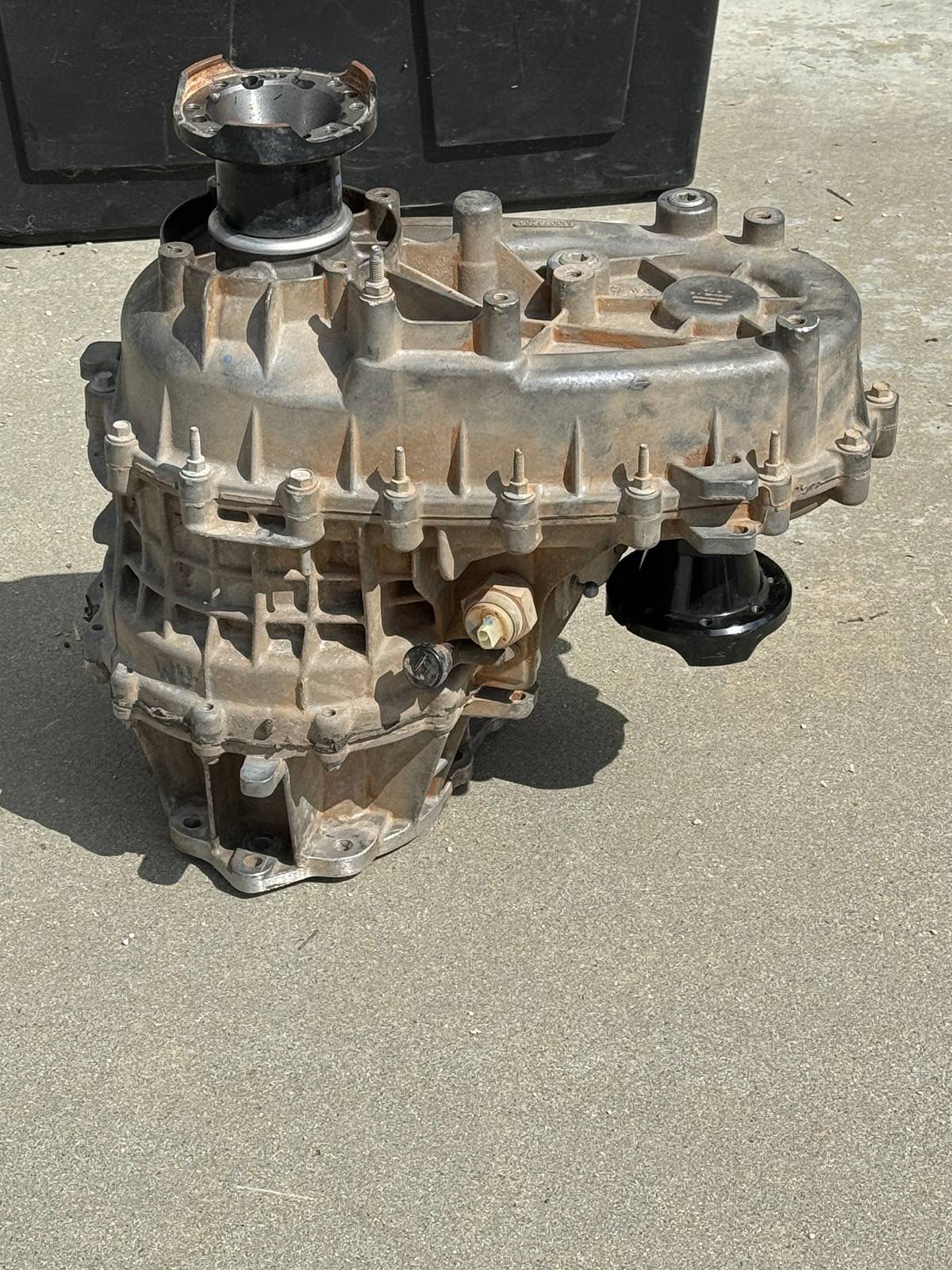

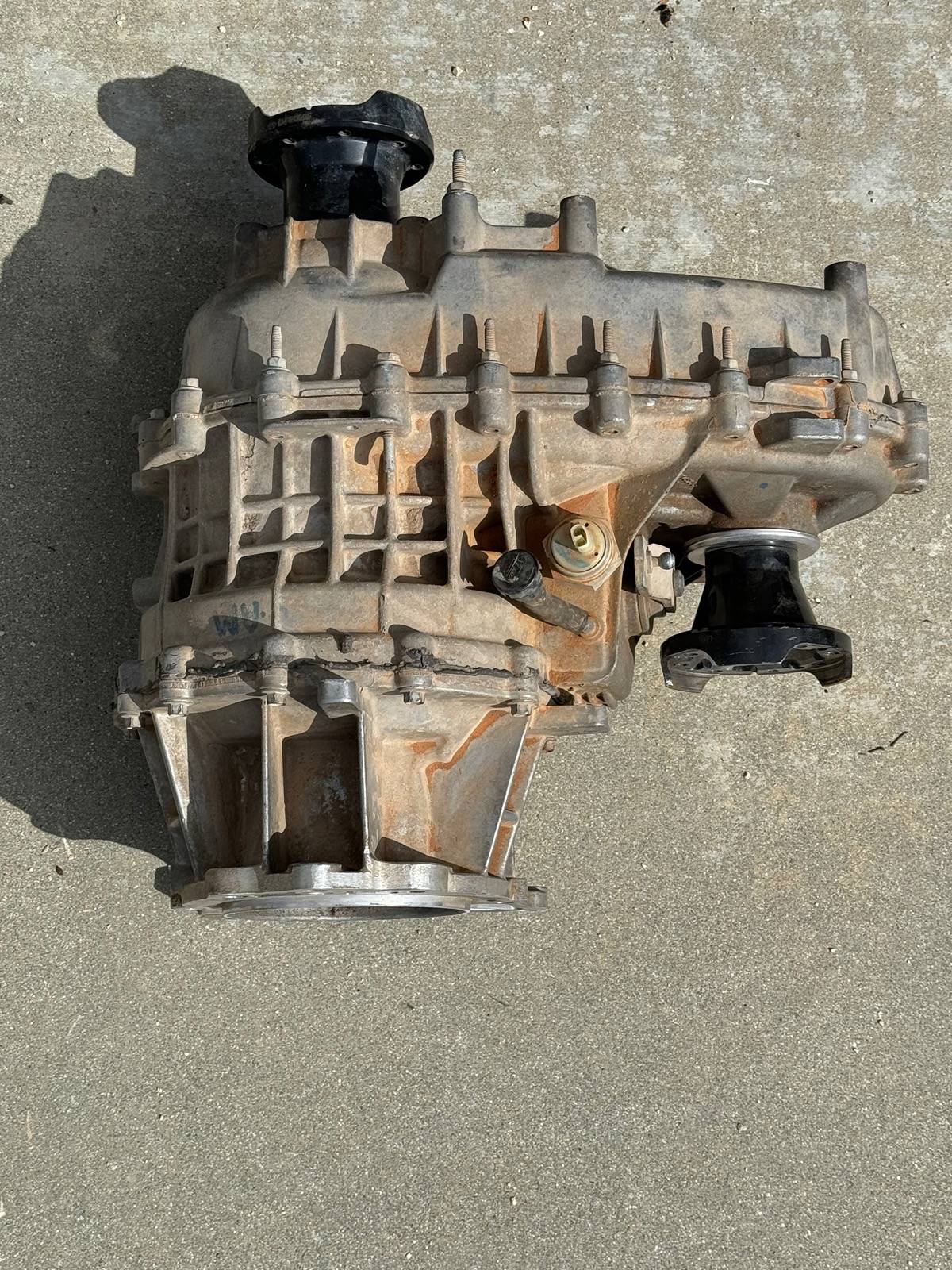

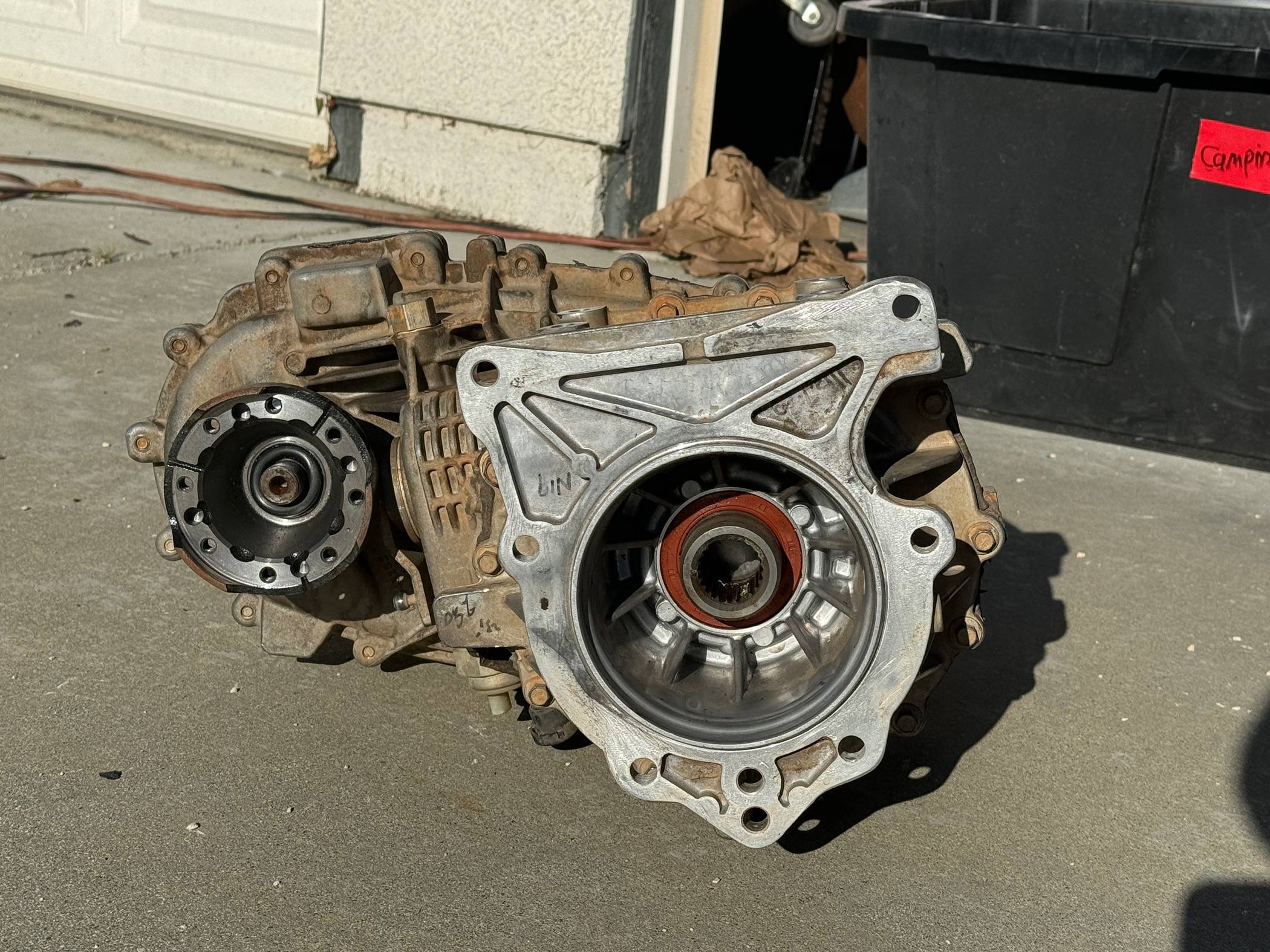

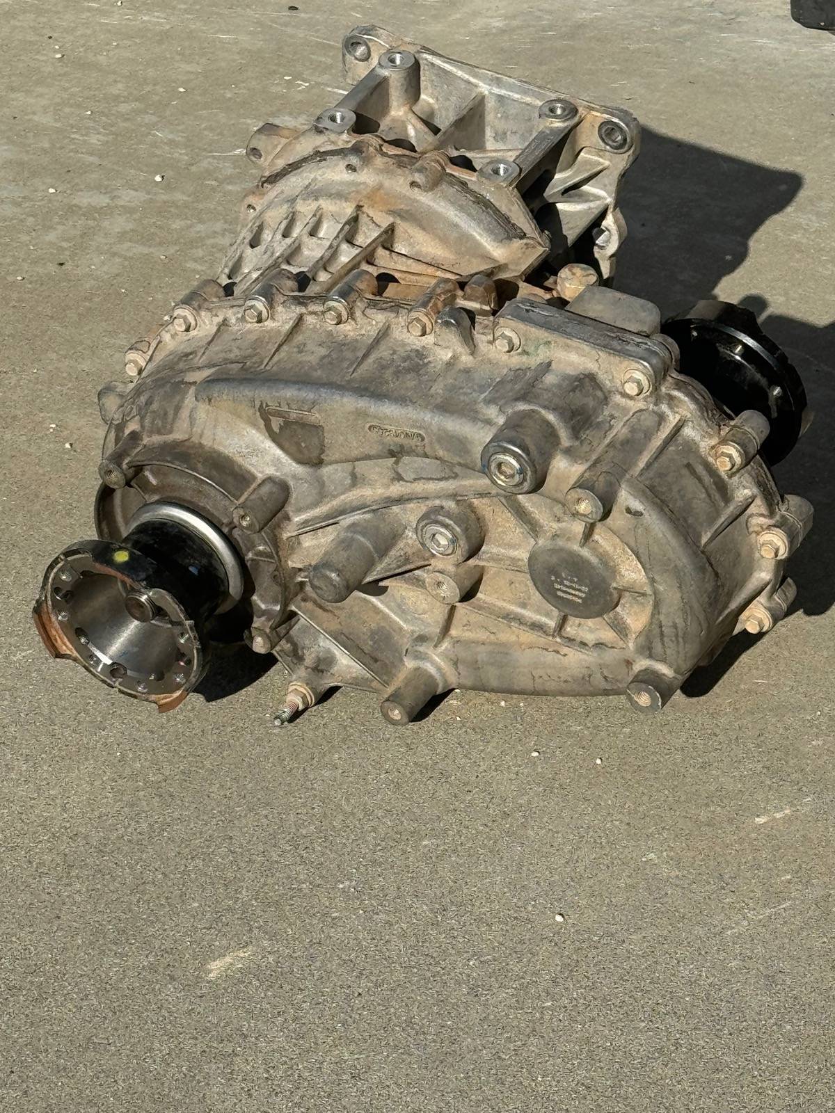

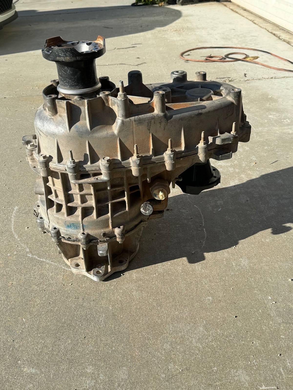

So i bought this transfer case off a member here, who said he ran it in his V6 8AT Willys.
i took it to a local shop and they said that it wont bolt in and that its not right the part #

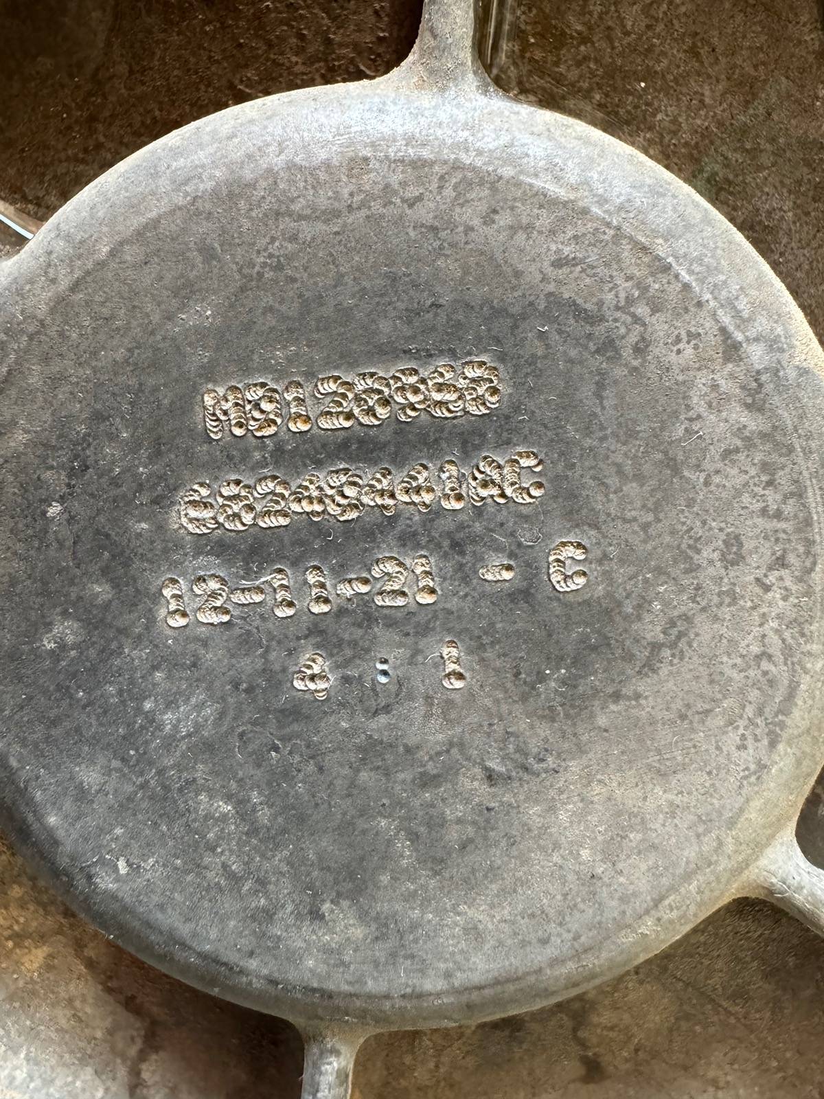

the sticker is missing but i found where the part number is engraved. Its kind of hard to read but it looks like 68248441AC unless that second 8 is actually a zero, which would actually be correct, since the part number with an 8 is not for a transfer case.

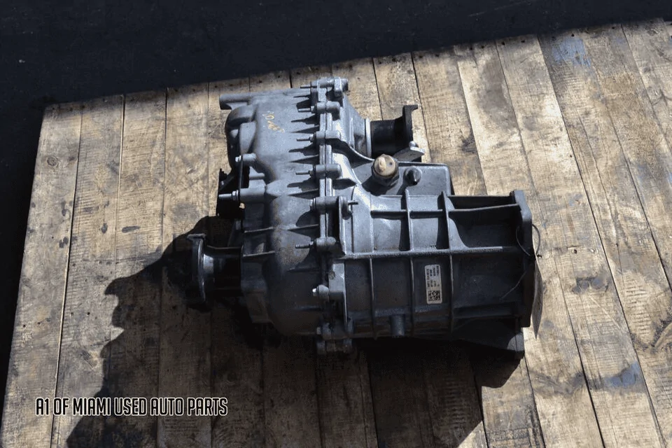

Looking at pics of other rubicon transfer cases it looks the same.

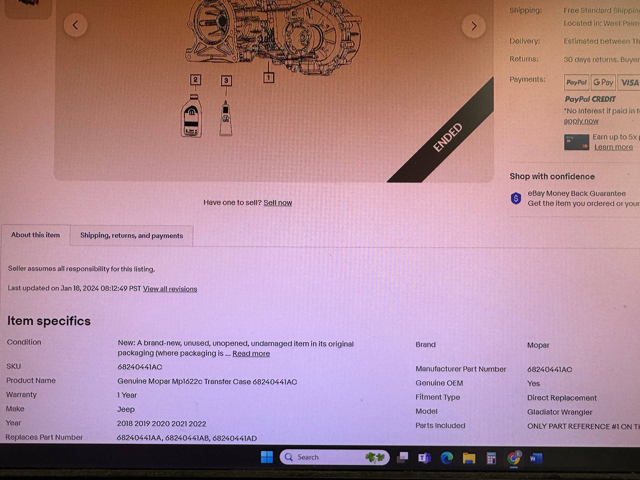

looking at an ad on ebay from an oem parts dealer it seems to be the same. It says the AC version replaces the AA, AB, AD versions.
Is this the correct part? And this well known shop is flat out wrong??

hmmm....looks like the guy i bought it off of bought it from @chevymitchell .... which means it should be for a V6 AT Rubicon.
rohdawg
Sep 18, 2018
2,318
7,476
Long Island, New York
Merchant Marine
If he got it from him that’s good news.
That’s 100% a zero. It’s got the slash through it and that’s exactly why that’s done. It’s to ensure a zero isn’t confused with another number or the letter O.

  • #4
that's what i thought when i looked at it some more lol. just that the 8 and 0 look a lot alike....
thank you for your reply. :beer:
so it should be the right TC then. this is a known and respected shop. yet theyre saying it wont bolt in and they'd have to modify it to make it work....? i have to call them again tomorrow to ask them why its not working. i dont recall the specifics.... unfortunately i cant really find any detailed threads on installing a rubi TC into a Sport. just people saying theyve done it.

There are full-time and part-time transfer cases. AT may not mean auto trans but full time 4wd
I made that mistake had to return at my costs and order the correct unit. I replaced my 2020 Sport JL V6 auto with a used Rubicon from ebay. They supply a table that matches your VIN That 4:1 ratio is really helpful at Sand Hollow and Moab

Ah i thought he bought yours.
i bought it from @boston3111 he said he has it in his V6 Willys with auto trans. I asked him if was full time or part time and he confirmed it is part time.

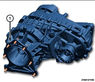

It looks like the input shaft housing is integral to the case on the MP3022 full time case:

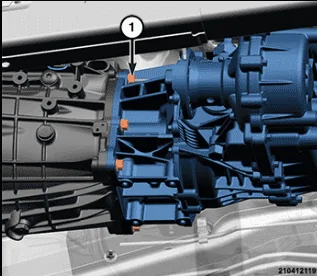

Here's how it bolts to the trans:
Jeep Wrangler JL Please help identify this transfer case 1710786577670-8a
Jeep Wrangler JL Please help identify this transfer case 1710786552212-u8

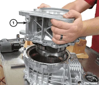

From the tear down procedure, the extension housing pulls with the planetaries, so I don't think they pulled that off.
Jeep Wrangler JL Please help identify this transfer case 1710786833941-jt

Steve, I'm going to DM you the remove and reinstall procedure for the 1622 so you can see it.
Once you know how it goes in/out, I'd ask him what specifically doesn't match up bolt pattern wise.
