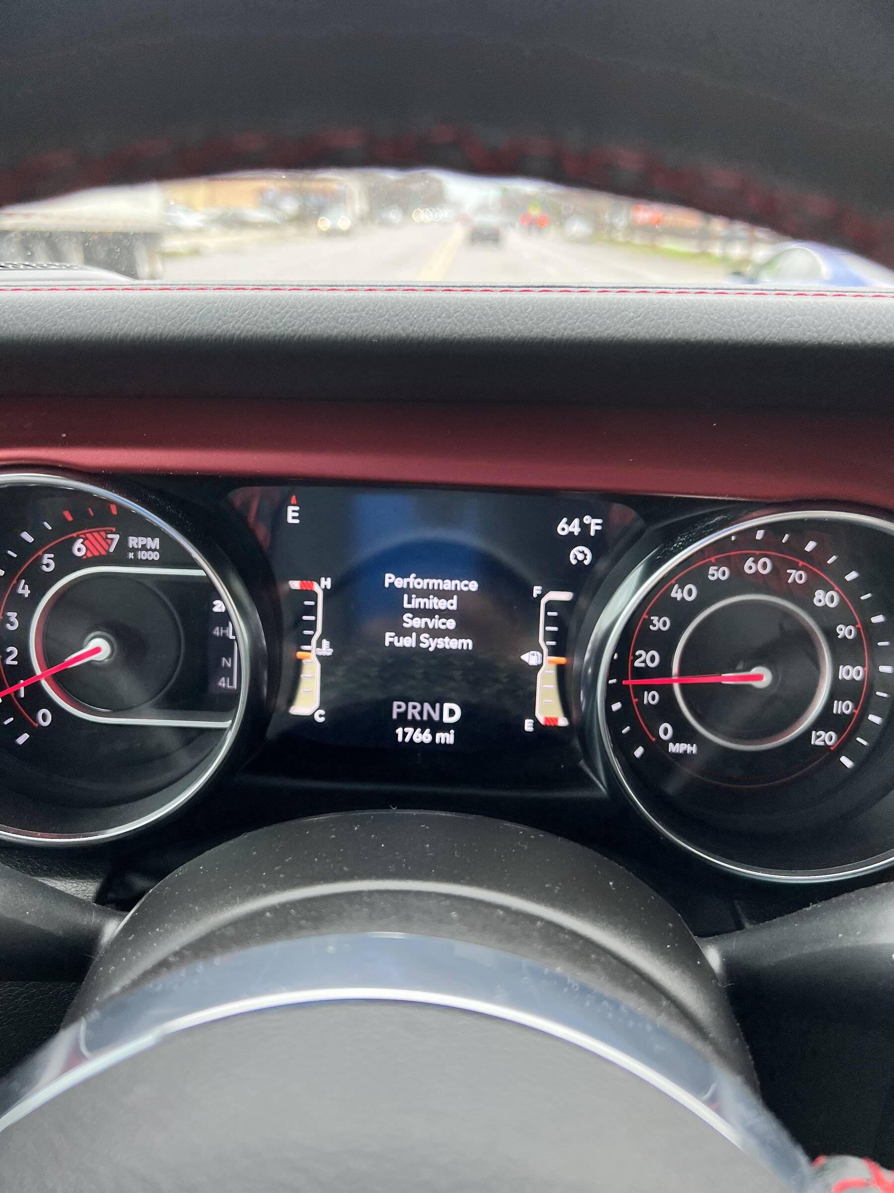

22 jl2.0 1700 miles I only put shell premium gas and drive the car very gently. I've already seen this message few times. Yesterday I was giving gentle acceleration after a traffic light stop and saw this message. Looks like wide spread issue. See the attached pic. I'm advised by my salesmen to bring in the car to dealership. Not sure what to do I'm lost here.
Interesting that you saw it on acceleration. Most of us seem to have only seen it on decel or coasting. When I saw it decelerating, I floored it and immediately the message went away. I'm curious if you tried accelerating hard and what happened?
