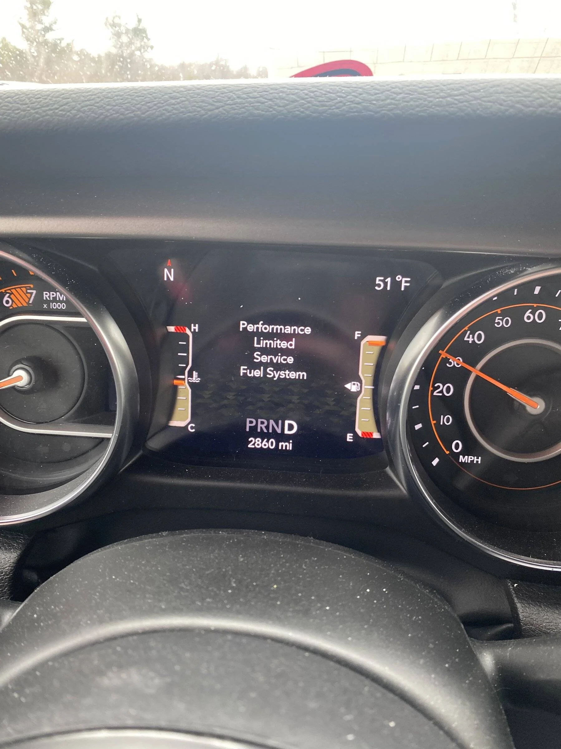

this literally happened a few minutes ago and I was able to take a pic. Any luck figuring out the issue and fix?
Jeep Wrangler JL "Performance Limited" Error code EB36FC40-CF66-4354-BC04-0C0DD89765B3
Intermittent...and thise are the exact words. I also can't seem to find and consistency to it. Unfortunately we haven't been able to snap a picture...it shows up for a few seconds and then disappears. No codes stored either...it's so weird.
