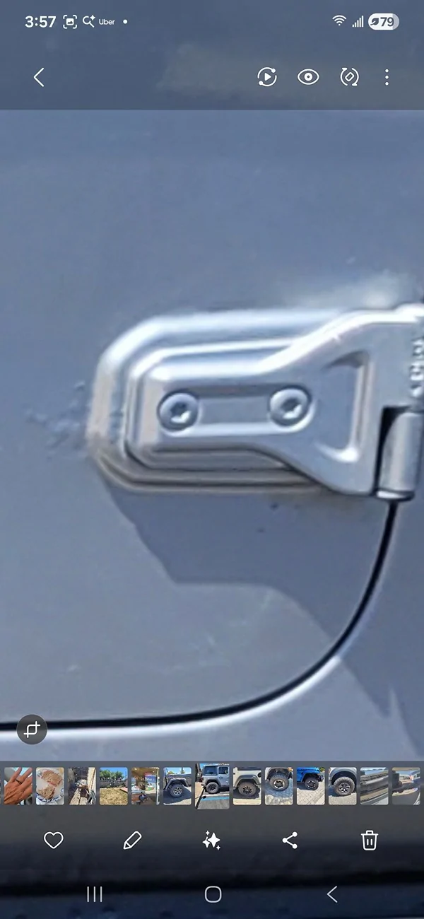

This isn’t rust. It’s corrosion of the aluminum happening under the paint due to improper paint prep at the factory.

This isn’t rust. It’s corrosion of the aluminum happening under the paint due to improper paint prep at the factory. Jeep has somewhat acknowledged that it’s a problem and has fixed thousands of vehicles (hundreds here on the forum alone), but for some reason they pick and choose some to fix and some not to fix. I’m falling into the category of not getting mine fixed and haven’t been given a real explanation by Jeep as to why

It’s safe to say it will, it’s not if, but when... There’s zero paint under the hinges, just raw aluminum on steel action. If you look close enough, good chance you can see primer, even raw aluminum in some spots where water and debris gets under accelerating the issue.

Nope. But one of the firs things I noticed when I did my first wash and wax. Was the lack of paint coverage and attempted to get the manufacturer defect fixed because I was afraid of eventual corrosion (plus I paid $40,000 for something my sister’s $20,000 Renegade has better QC over is bs). I then discovered the door/hood corrosion mega thread, with over 100 pages confirming my concerns.

Same issue been noticing bubbling for over a year. But didn't know it was a common corrosion issue with my 2018 JL. No dealer has mentioned it during many visits for star connector issues. Unfortunately I may not qualify for the goodwill program as im at 55,500 miles and 7 yrs since purchase.
Im starting to also see paint peeling at the hinges.
