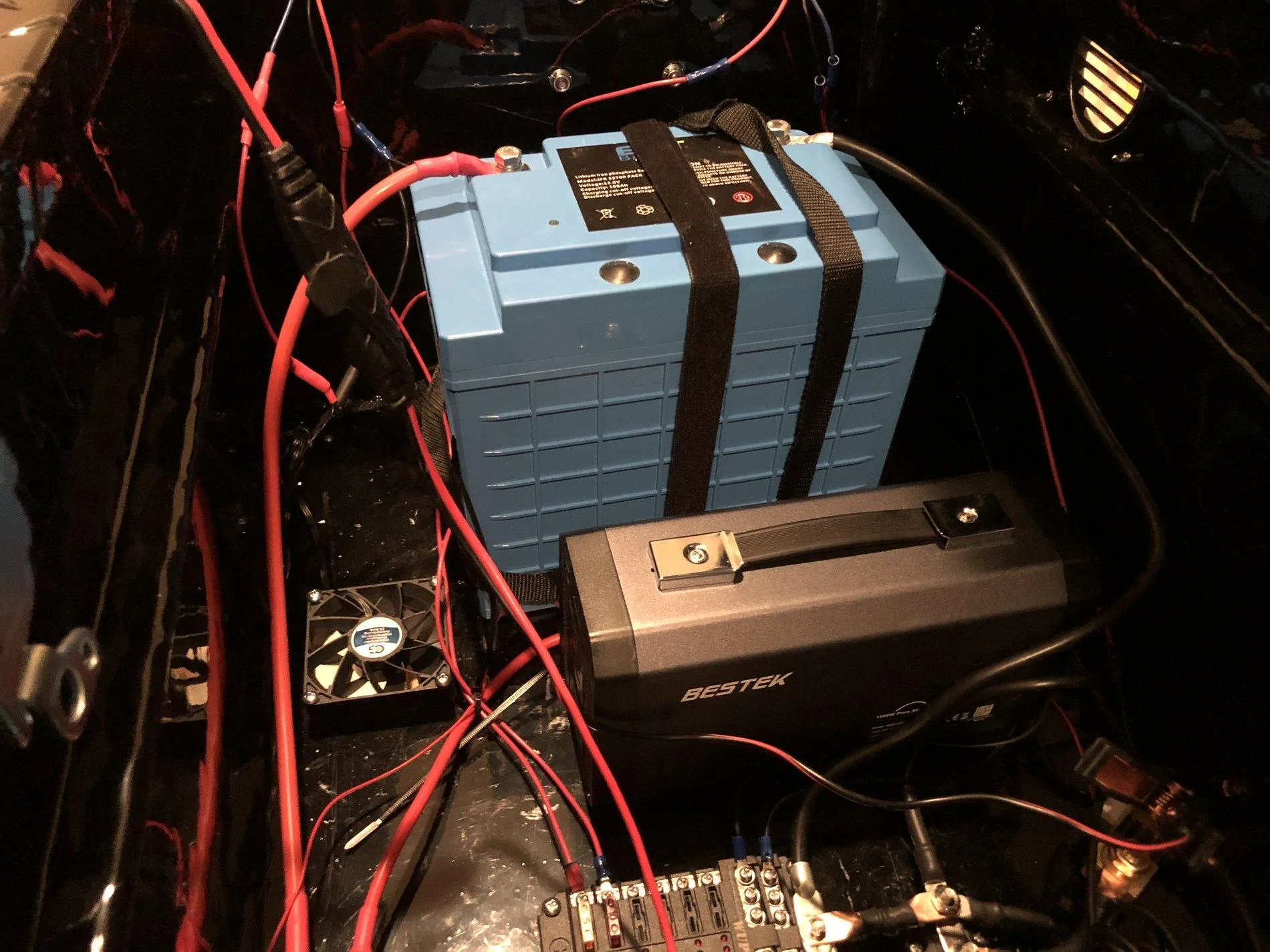

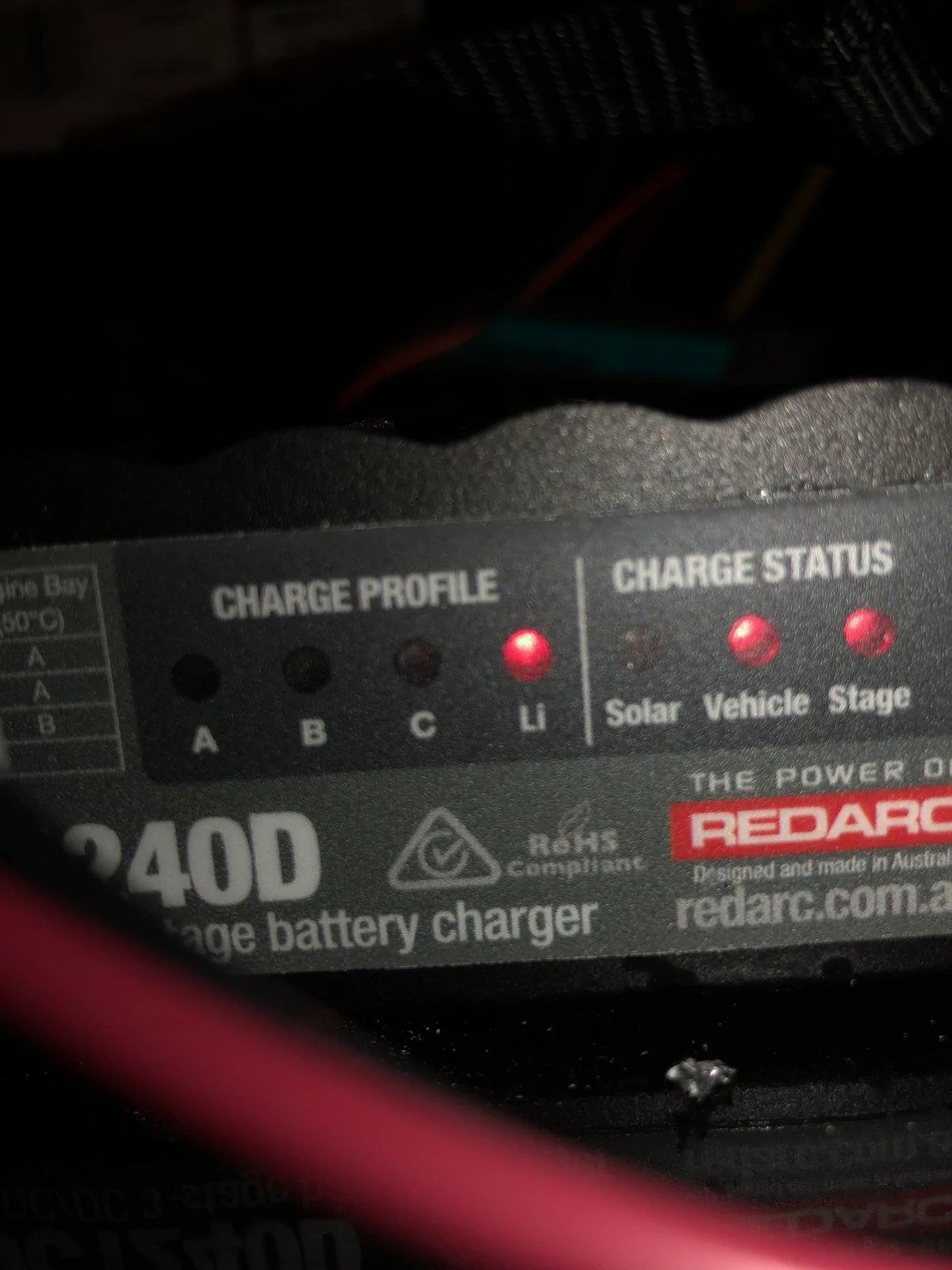

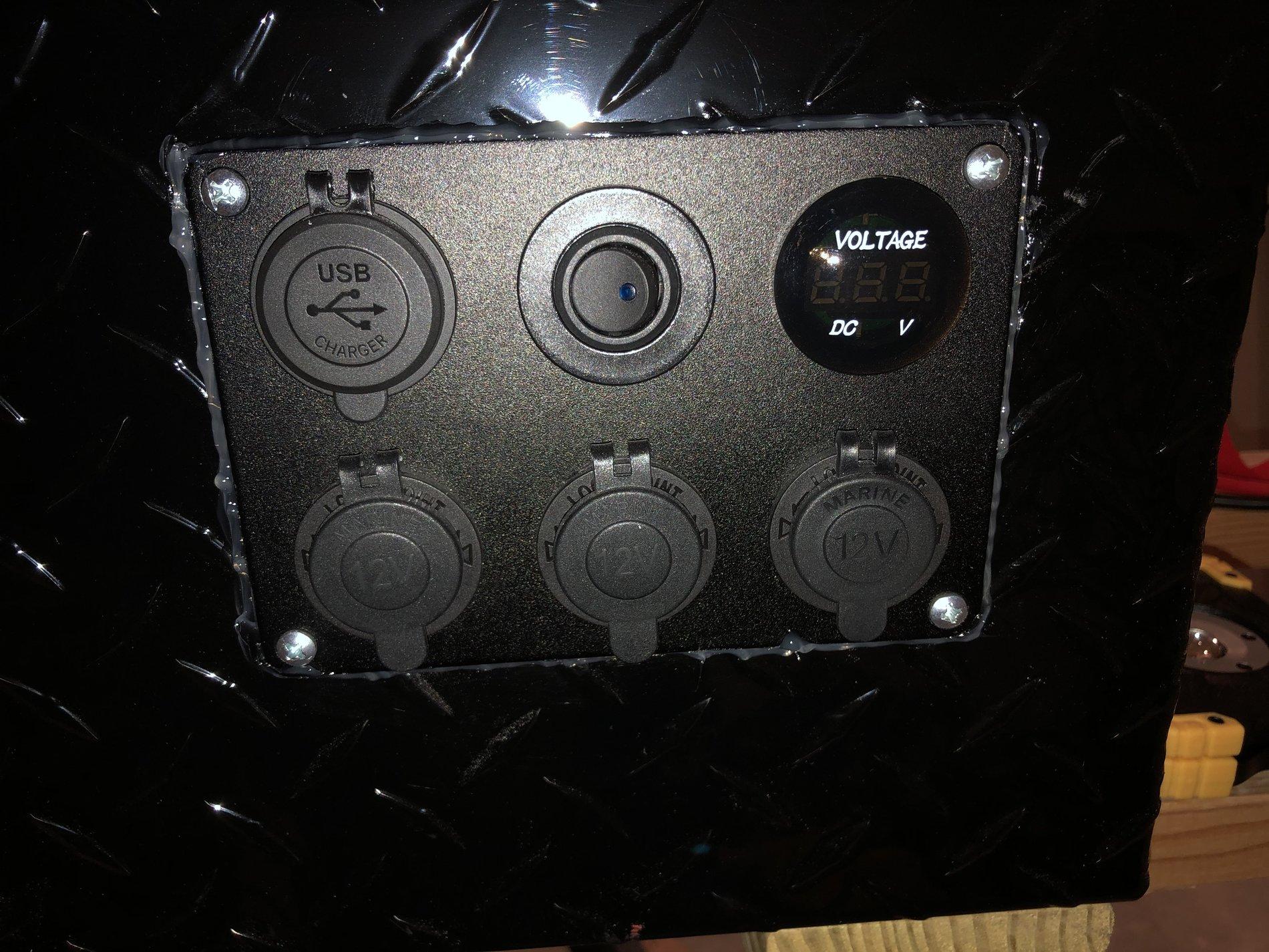

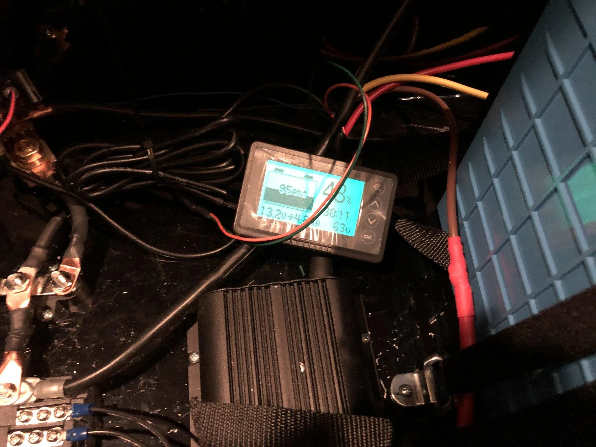

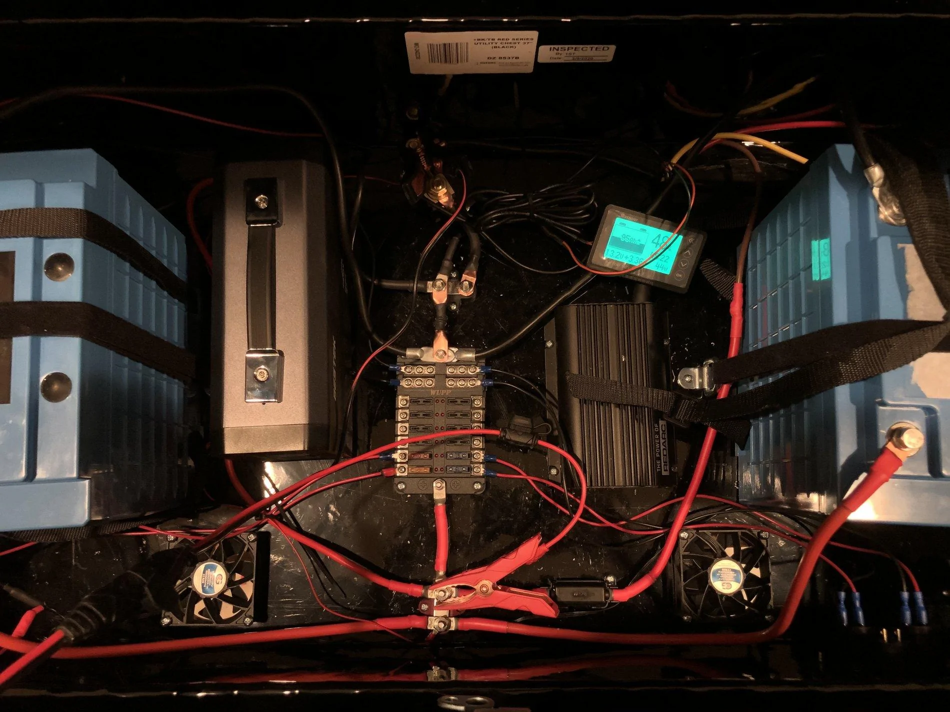

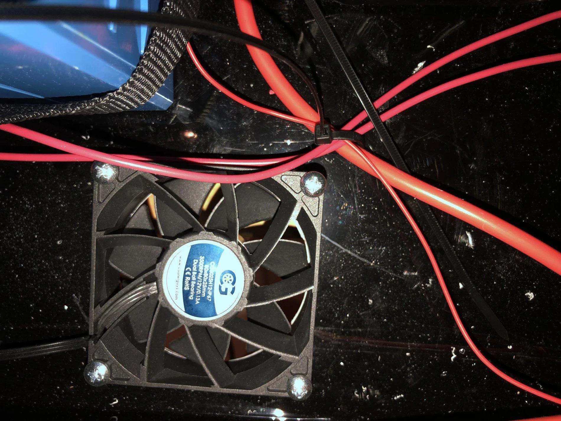

This is what I did on my own to test my concept before I started working with an OEM manufacturer to help me assemble a modular package for market.
I have two of my 100ah LiFePO4 that I import and sell, a Redarc BCDC1240, a Bestec 100W pure sine wave inverter and an amazon fuse distribution block. I ran 6AWG wire through a 60 amp fuse to the bed terminated with an anderson plug. The input to my box has an anderson plug so all I have to do is unplug the unit and remove it from the truck for normal use.
I got a small chest type toolbox from amazon and cut three holes in it and installed louvered vents and two three inch waterproof fans in the bottom to force air in to keep the internals cool. I also had a Renogy battery status monitor that failed within hours of me leaving the house so I have purchased but not yet installed a Victron.
The DCDC/mppt charger is the only way to go for this type of setup. They work as a solar controller, correct your alternator output as stated above, they have a smart charge algorithm for your battery chemistry and the work as a dual battery isolator. And since I didn't want a small wire running to an ignition source I wired in a small rocker switch so that I can send 12V current to the ignition circuit whenever I want to charge the batteries. I also have a rocker switch to turn the fans on and off.
I run all of this through a marine grade outlet plate that I installed on the toolbox. At the moment I only have one AC outlet with a weather tight plug mounted on the box and plugged into the inverter.

Thats a great setup! Perfect for any overlander who wants to stay off grid for more than 1 night at a time. Do you sell the batteries online? If so, what's the website?
