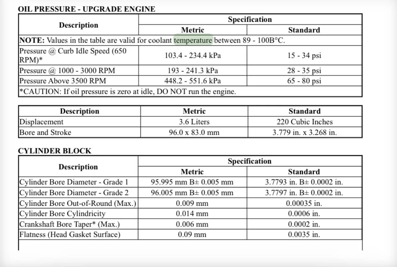

Personally I would not be changing the operational temp range without knowing what range the engine was designed for.
in the service manual, under the oil pressures section, it says “values in table are valid for temperatures between 89-100°C (192-212°F).
would it be safe to assume that those temps are the operational temp range the engine was designed for?
I would have to see the table in context, but from that wording it doesn't sound like that is the operation temp range of the engine and just a temp range for the sensor values being valid, diagnosed, or something. Without context for that I can't say what that is.
