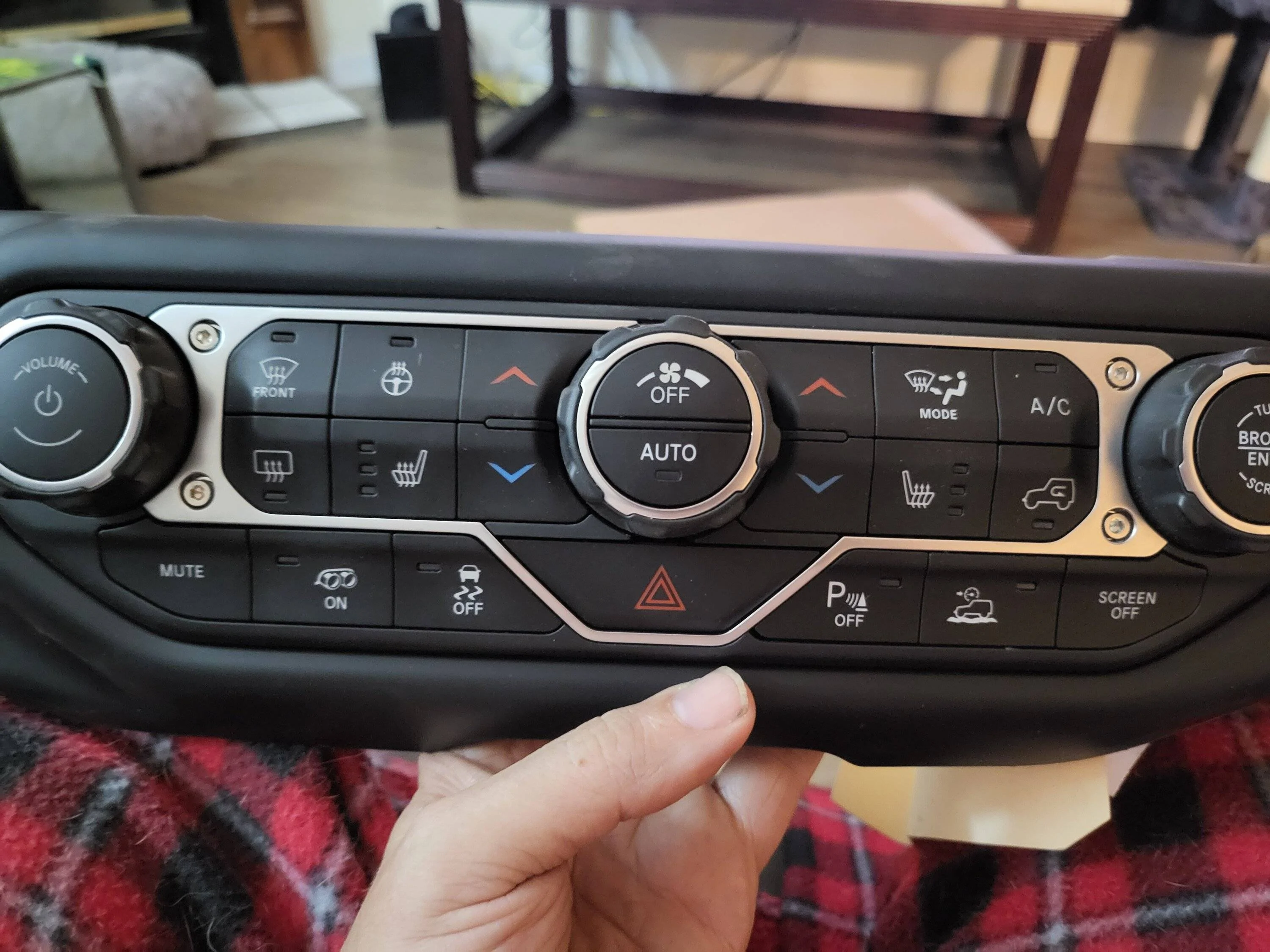

Ordered climate control for heated seats from a junkyard.

Scored the 392 cluster for 100 bucks lol. Anyone ever try to enable the bcm pins for the active exhaust through alfaobd? Plugged it in and all the normal things work

Well its not plug and play, the pin for k676 (exhaust valve) is controlled by the pcm and the pin is already in use on a 2.0. That's okay though since I need buttons that don't do anything for the magic button project
What does the pin do on the 2.0?
