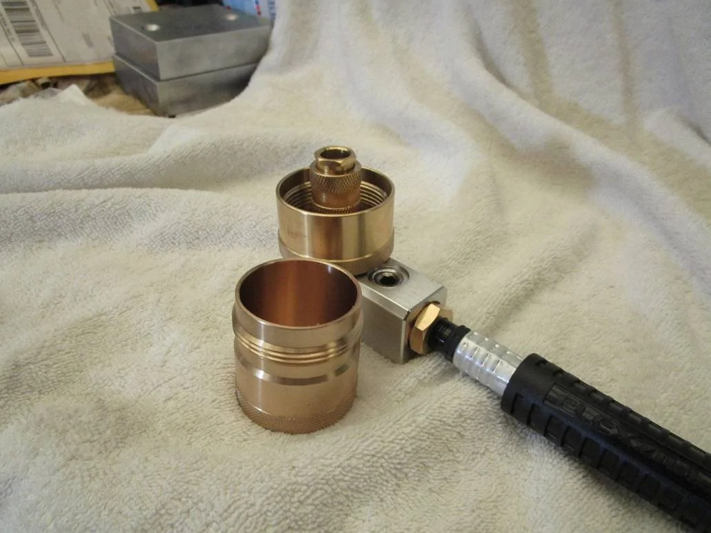

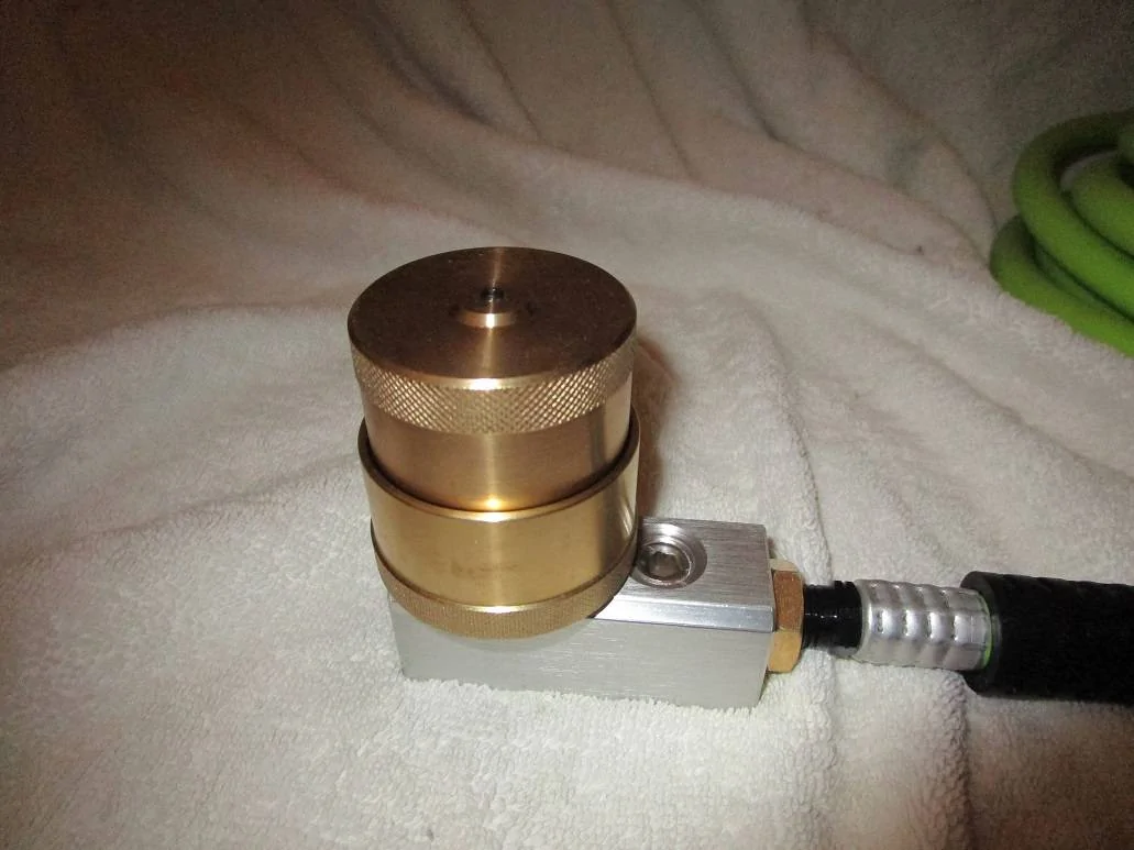

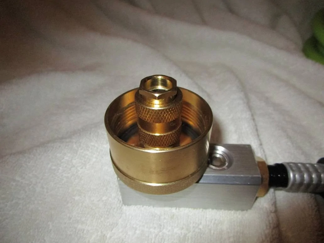

I should receive my Grimm Offroad Jeep JL/JLU, Jeep JT ARB Twin Compressor Mounting Bracket Kit and ARB twin compressor today
I am hooking up the line from the compressor to a manifold and running two hoses along each side of the frame just behind the center body mount with waterproof hose coupler that I built
This will allow me to fill two tires at the same time

Slick job on the coupler housing.
