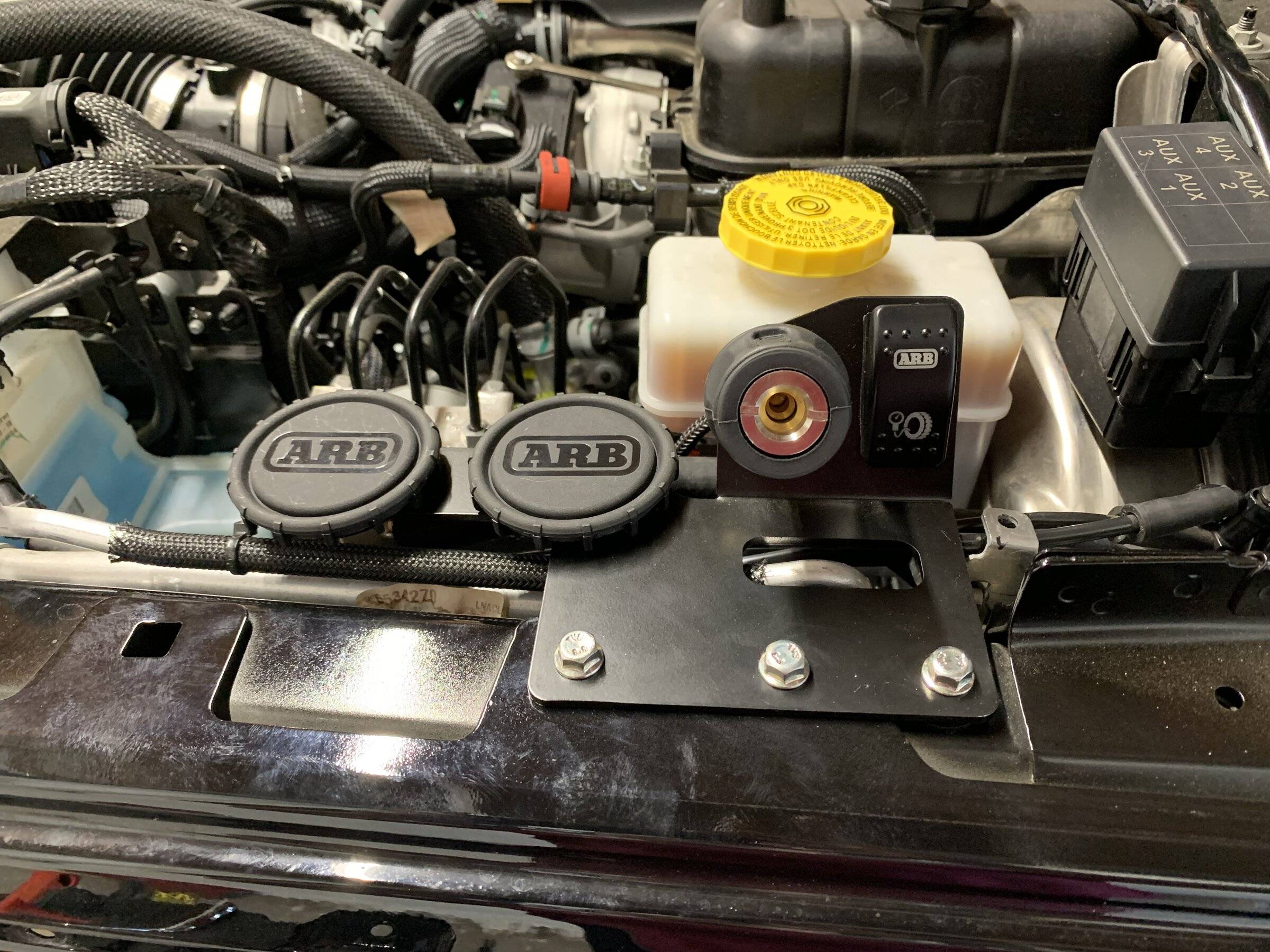

I went this route with my 2 door, 2.0t:
Two years later it still works like a champ. Use it regularly for work, as our vehicles run near a lot of new home construction and pick up nails all the time - actually used it today to plug and fill a flat on one of our fleet vehicles.
Out of the way, but easy to access...

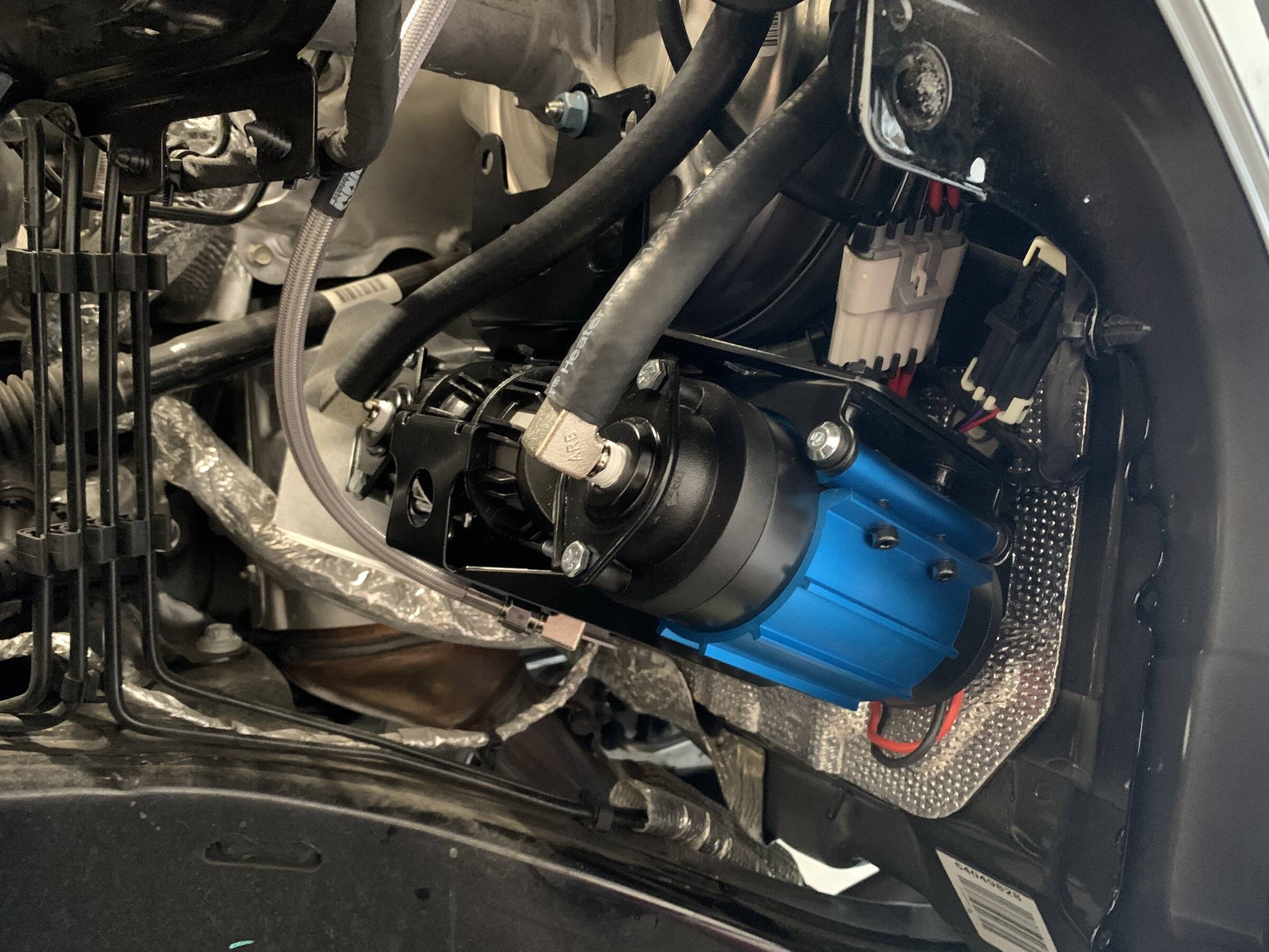

Wanting to maximize its potential lifespan, by having it away from the heat and weather, is what drew me straight to the MORE mount.
It does a great job bringing 40's up from 14 to 32 psi. I've also been nursing a slow leaker on the payloader at work. It takes a little while to bring them up to 70psi, but that's where it's 100% duty cycle really shines.

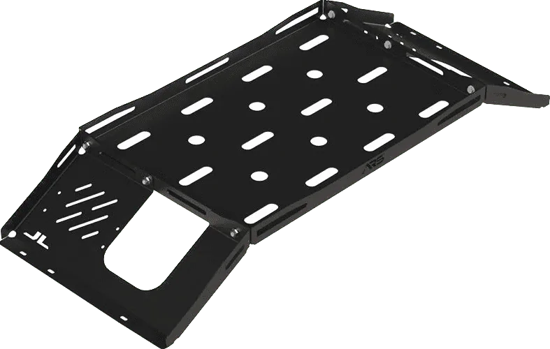

Anyone tried using the adventure rack for mounting compressor?
